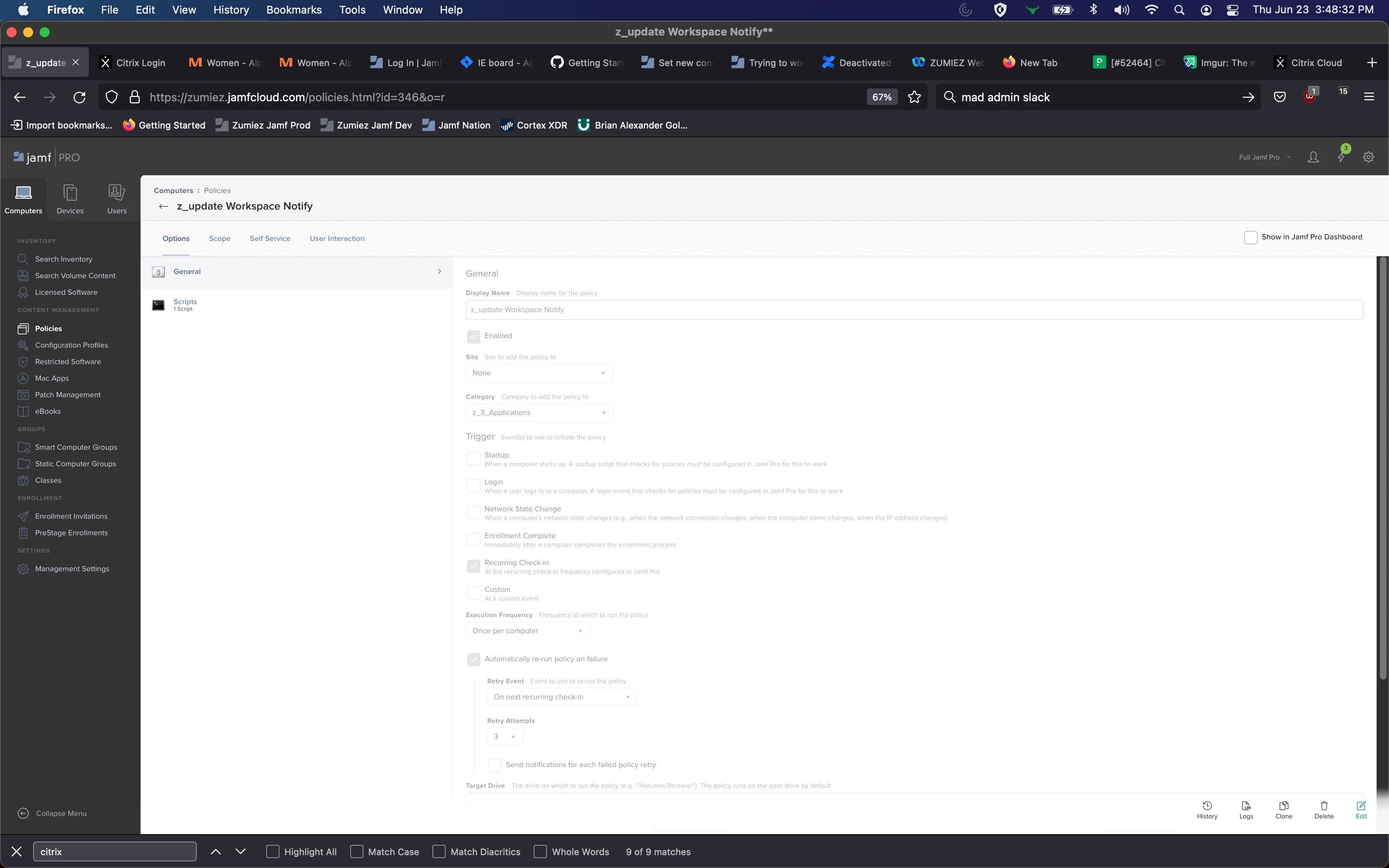

I wanted to make a popup window that users had to click on to acknowledge they were getting an update that would close their open application.
I created a notifyScript , a notifyPolicy, and a updatePolicy.
notifyPolicy is set to enabled, recurring check-in, automatically rerun, on next.
notifyPolicy is set to enabled. notifyPolicy passes the name of updatePolicy into notifyScript as an argument
notifyScript uses updatePolicy name as a custom event trigger to call update Policy
When notifyPolicy runs, i get the following:
"No policies were found for the "updatePolicy" trigger.
Where am i going wrong?

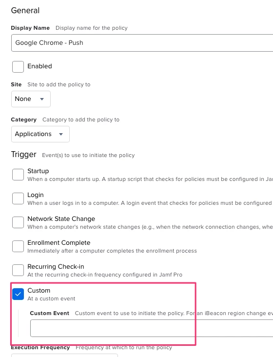

What is the scoping on the "updatePolicy"? Also, if you are trying to trigger using "updatePolicy" as the trigger, did you set "Custom Event" in the updatePolicy? You do not use the name of the policy, you use the value you put in the "Custom Event" field after selecting "Custom".
binjali
  • June 23, 2022
Thanks for replying! notifyPolicy is currently scoped to a single computer for testing/building.  I want the "notifyPolicy" policy to execute first so that a user gets a popup to acknowledge. The acknoledgement then is supposed to trigger the "updatePolicy" policy which is what actually installs the .pkg  i feel like i'm really close to getting this working.
  • June 24, 2022
Like Steve pointed out, you need to use the custom trigger string that you’ve set instead of the name of the policy. Your policyTrigger parameter needs to be set to “updateWorkspace”.

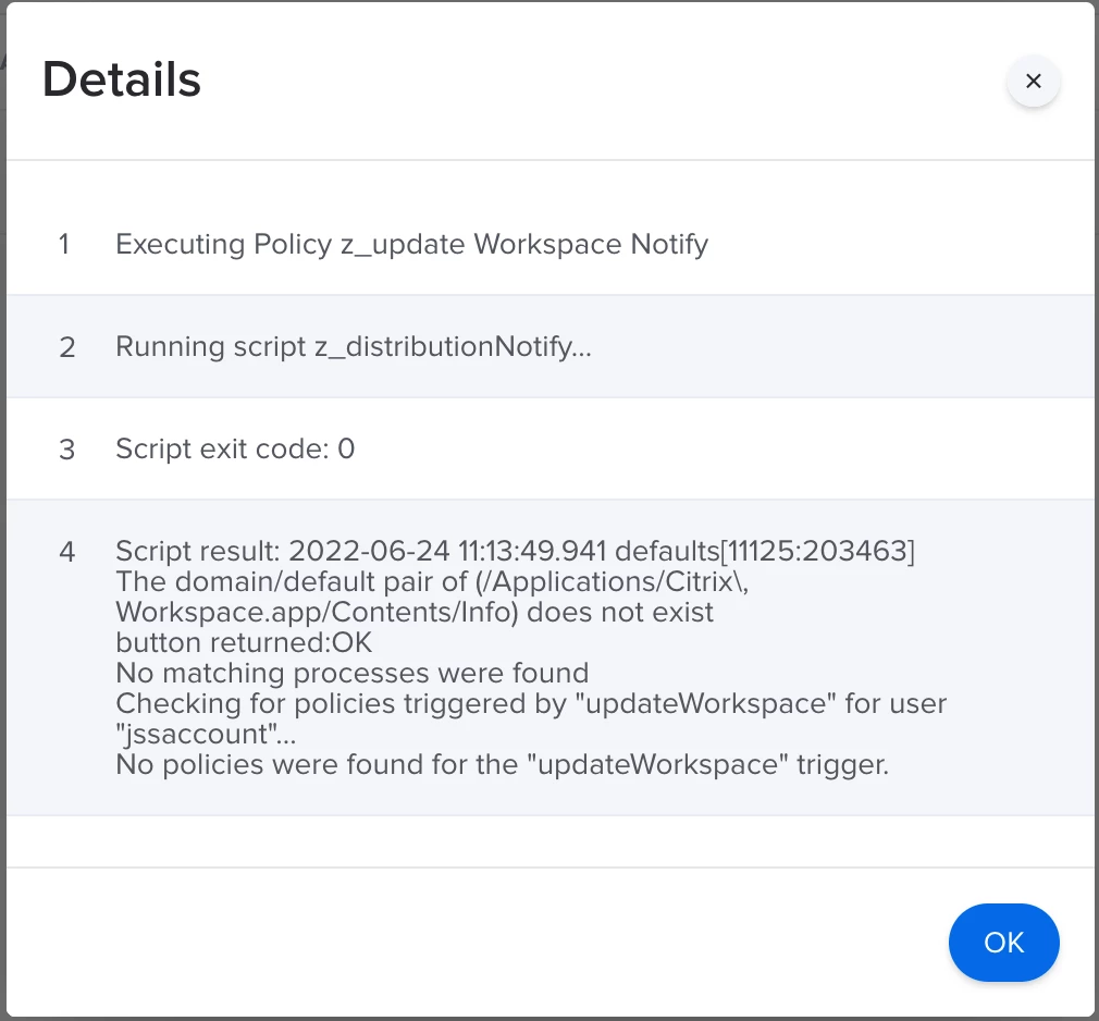

Okay, I changed the parameter to "updateWorkspace" but now Jamf is giving me this error message:  I did get the popup I wanted, which is nice!  But I'm still not getting the activation of the update policy. what gives?
mm2270
  • June 24, 2022

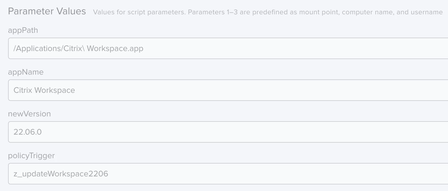

Looks like the issue is this line in the script.
version=$(defaults read $appPath/Contents/Info CFBundleShortVersionString)
Since "Citrix Workspace.app" has a space in it, you should update the script to contain the path to the Info.plist or at least the app path itself in double quotes and remove the \\ character in your parameter. I would make this adjustment to it
version=$(defaults read "$appPath"/Contents/Info CFBundleShortVersionString)
That should avoid the error you're seeing in the policy log.
Make sure to change your script parameter in the policy for appPath to just /Applications/Citrix Workspace.app

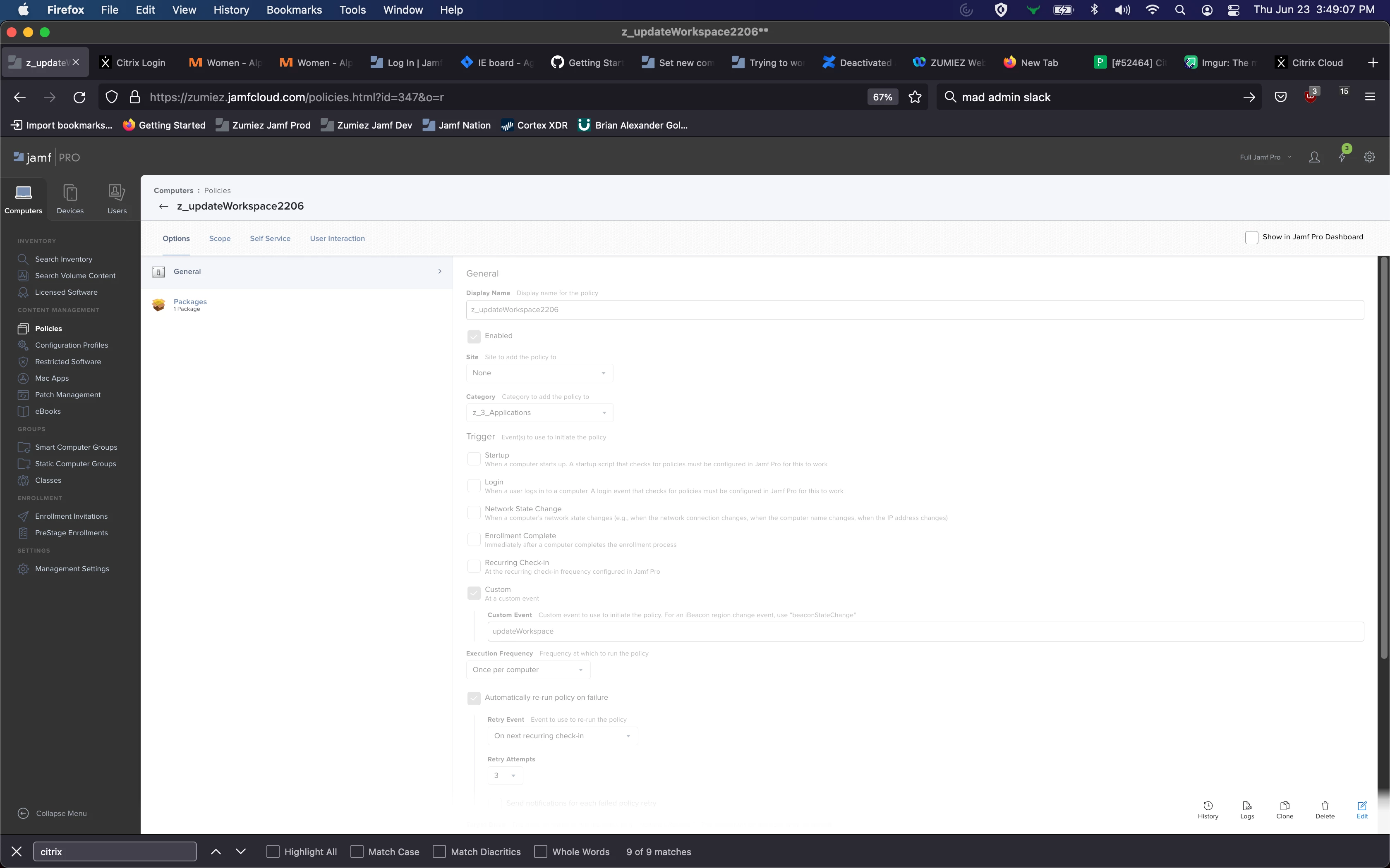

How do you have the "Scope" tab configured on hte "Update Workspace" policy? The "No policies were found" error indicates that the device, or user, were not in scope for that policy.
binjali
  • June 24, 2022
the updateWorkspace policy is currently scoped to Specific computers, Specific users, but has no targets.  Since i didn't want it to kick off unless specifically triggered by machines that got scoped in the updateNotify policy
stevewood
Forum|alt.badge.img+38
  • June 24, 2022
Well, that's what the problem is. You have to have computers in scope for it to work. So if you're testing with a specific computer or user, scope to that (computer or user).
Or, since you are only able to trigger with the custom trigger, you can scope to All Computers and know that it will not run unless you call it using the trigger.
binjali
  • June 24, 2022
That helped!  I did sudo jamf policy on my test target machine, and everything worked!  I rolled the version back and forced another check-in, and it worked!  I even got the popup window I wanted!

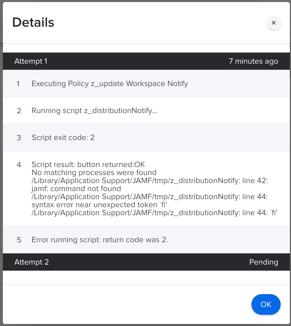

In your script, you have an extra "fi" on line 44. Not sure why the 'jamf' command on 42 is not functioning. Might want to put the full path to the binary: /usr/local/bin/jamf
And on my script, you have a missing "fi" before the "exit 0". Might be my mistake, but that last "if" block is not closed so you'll get an error.

Checking for policies triggered by "updateWorkspace" for user "jssaccount"...
No policies were found for the "updateWorkspace" trigger.
So, something is going wrong with all the "run as" stuff, i think?  This is so hard to follow!

Pasted that code snip in and  waited for check-in to fire. After it did, the update did not run, and my installed version hasn;t changed.  This is what the logging said:
Executing Policy z_update Workspace Notify
Running script z_distributionNotify...
Script exit code: 0
Script result: + appPath='/Applications/Citrix Workspace.app'
+ appName='Citrix Workspace' + newVersion=22.06.0 + policyTrigger=updateWorkspace ++ echo 'show State:/Users/ConsoleUser' ++ scutil ++ awk '/Name :/ { print $3 }' + currentUser=jssaccount ++ /usr/bin/defaults read '/Applications/Citrix Workspace.app/Contents/Info' CFBundleShortVersionString + version=22.04.0 + '[' -z jssaccount -o jssaccount = loginwindow ']' + OSASCRIPT=/usr/bin/osascript + [[ 22.04.0 != 22.06.0 ]] + notifyUser='display dialog "Citrix Workspace is outdated. Please quit Citrix Workspace, then click OK to Update." buttons {"OK"} default button 1' ++ sudo -u jssaccount /usr/bin/osascript -e 'display dialog "Citrix Workspace is outdated. Please quit Citrix Workspace, then click OK to Update." buttons {"OK"} default button 1' 0:133: execution error: No user interaction allowed. (-1713) + displayDialog= + pgrep 'Citrix Workspace' + xargs kill -15 + /usr/local/bin/jamf policy -event updateWorkspace Checking for policies triggered by "updateWorkspace" for user "jssaccount"... No policies were found for the "updateWorkspace" trigger. + exit 0
Is this just because I have the computer signed in as the jssaccount?  would i get something different if I was signed in as a different user that wasn't the jssaccount:

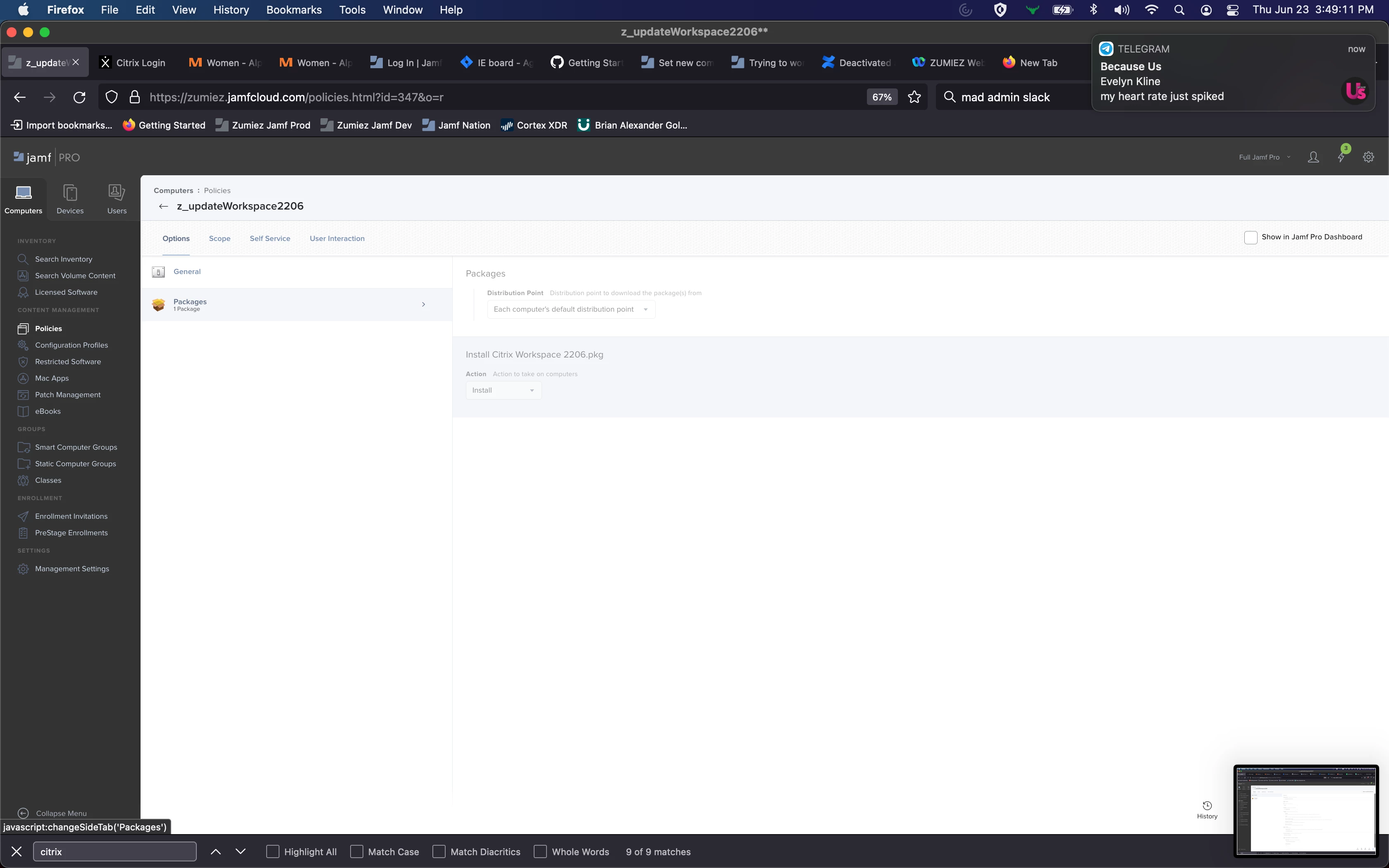

figured out why the update didn't fire: needed to flush logs in the updatePolicy in addition to the notifyPolicy
