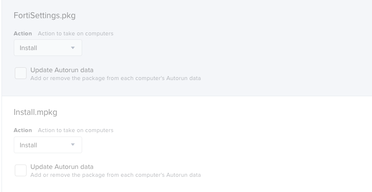

I have seen that the FortiClient is causing difficulties for some users. However, I have just been able to create a relatively simple solution with which the config files can also be made to work by default.
My requirements:
macOS 11.2.3 (intel) / Jamf Pro / DEPNotify 1.1.6
  1. complete installation on one system
  2. upload the install.mpkg to Jamf Admin
  3. start Jamf Composer and create a pkg with the following path incl. all subfolders (all custom settings are saved here): /Library/Application Support/Fortinet
  4. new policy: select both pkg-files, I first selected the config-pkg and then the Install.mpkg.
That´s all. I had success with this. FortiClient is running perfect with custom settings. No restart needed.

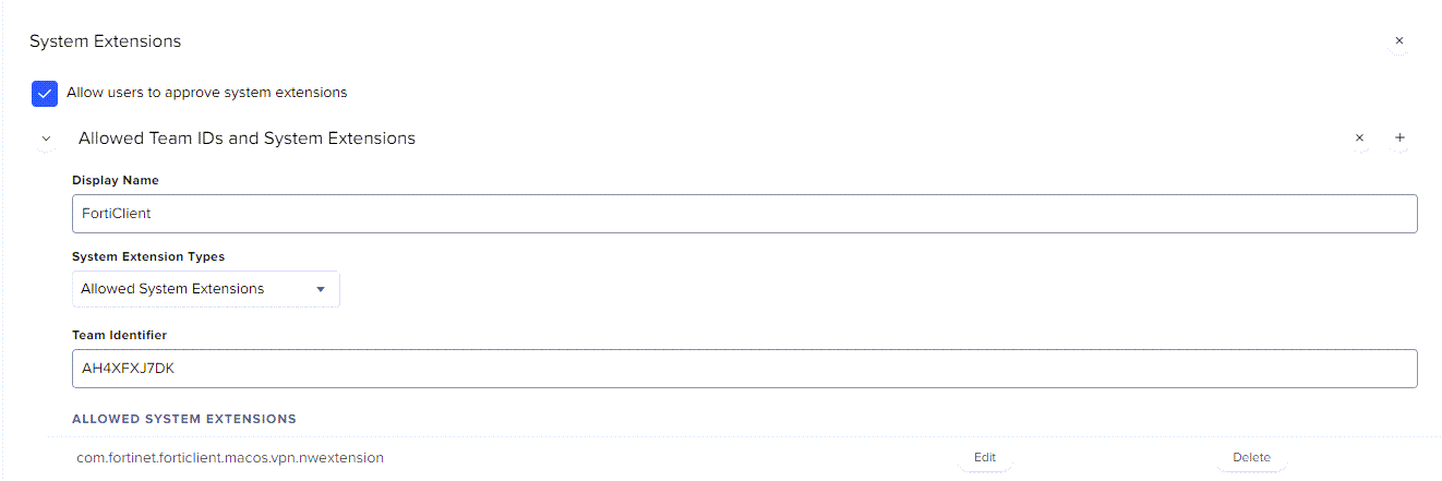

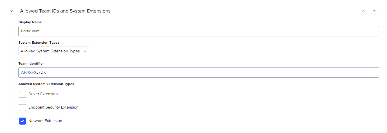

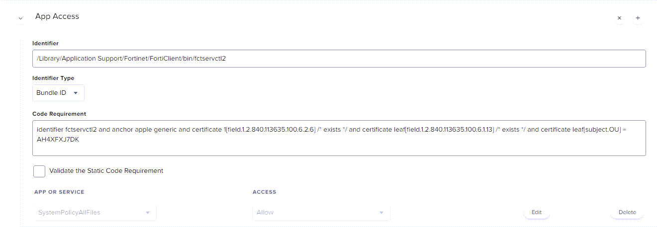

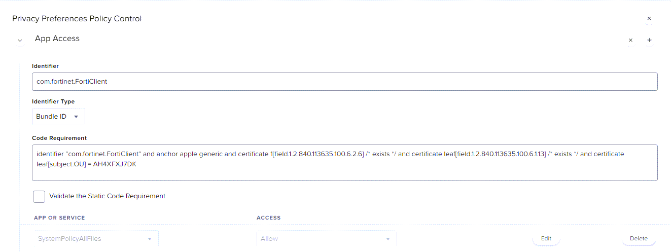

Just a quick update and info share for our free implementation of FortiClient 7.0.3.  Thanks to Mickl for providing the bulk of this process!
  • Deploy FortiClient 7.0.3.mpkg (pulled from DMG) via Composer pkg to custom folder on endpoint
  • Deploy custom vpn.plist via composer to /Library/Application Support/Fortinet/FortiClient/conf/ to endpoint
  • If upgrade, run a site acceptable variation of the following script
#!/bin/bash #Stops all running FortiClient processes killall FortiClientAgent killall FortiClient #Initiates silent uninstall of current Forticlient /Applications/FortiClientUninstaller.app/Contents/Library/LaunchServices/com.fortinet.forticlient.uninstall_helper #Run FortiClient 7.0.3 Installer installer -verboseR -pkg "/private/tmp/FortiClient_7.0.3_Source_Files/FortiClient 7.0.3.mpkg" -target / #Copy vpn.plist from tmp to FortiClient config folder cp /private/tmp/FortiClient_7.0.3_Source_Files/vpn.plist "/Library/Application Support/Fortinet/FortiClient/conf/"
  • If fresh install, create another policy to push FortiClient 7.0.3.mpkg to endpoint, then install vpn.plist, and add a maintenance item to update inventory
  • Create a smart group "FortiClient Installed" with criteria "Application Title Is FortiClient.App"
  • To hide client-side pop-ups (FortiTray popup untested at this time) create a configuration profile with both PPPCs and System Extensions as below, and scope it to "FortiClient Installed":
