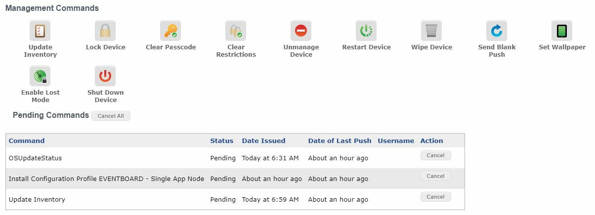

Here is an example for me. It started an update, and just haven't checked back in. It doesn't know that update is finished.
We do have Single app mode profiles and etc that were turned off prior to doing an update. Now those profiles wouldn't reinstall back since there is no connection

Jamf is investigating an issue related to the MDM Software Update workflow on iOS 11.3. While we don't have all of the details just yet, I want to share what we know for transparency:
MDM Software Updates are composes of three distinct steps:
1. Send an 'AvailableOSUpdates' command to determine what is available for a device
2. Send a 'ScheduleOSUpdate' command to tell the device what to install
3. Send an 'OSUpdateStatus' command to monitor download/installation status and completion
The response for 'OSUpdateStatus' includes a key for 'IsDownloaded', which should return a boolean True/False. We are investigating an issue where the 'OSUpdateStatus' is returning a '0' instead of a boolean True/False. This is causing a failure and affecting subsequent MDM communication. We have filed Radar 39116010 with Apple regarding this response change and our teams are investigating ways that we can handle these scenarios if the response does not conform to the documented standards.

  • April 3, 2018
@hyprmatt Canceling the pending commands does not fix it - so far the only thing that does is wiping and re-enrolling the iPads
