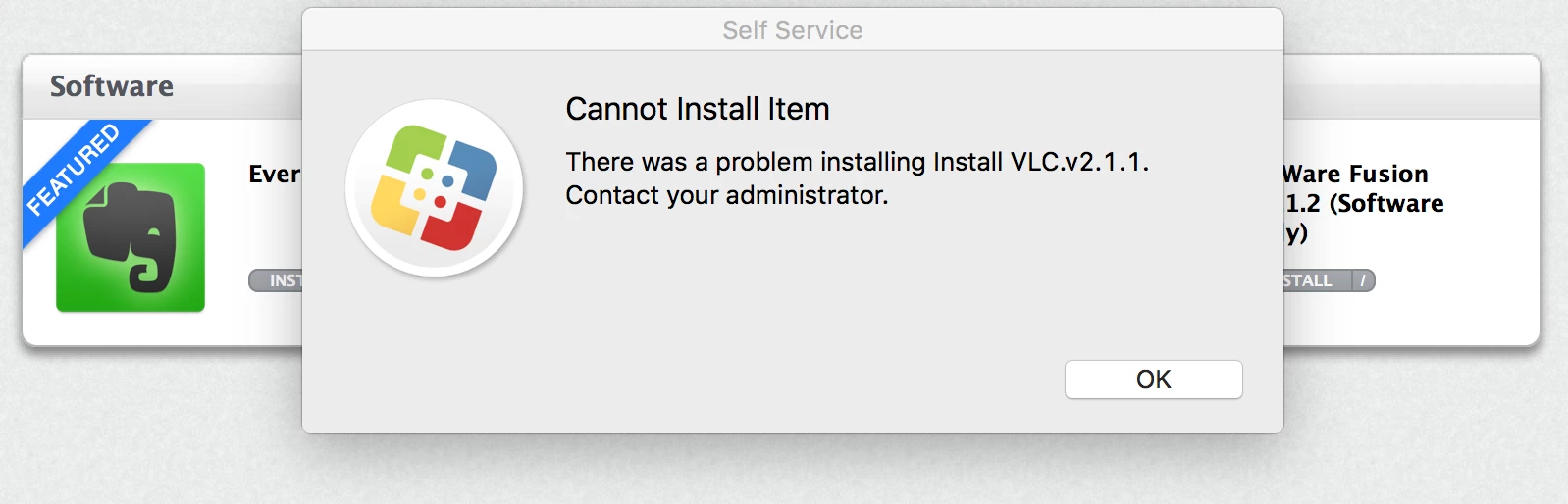

Ok, so I am having an issue installing non App Store software in Self-Service portal.. I am not sure if it's the fact that my current OS is El Capitan Beta.. But my coworker is running Yosemite, and he can install just fine.. As soon as I click on any software, I get "Cannot Install Item".. However, if I choose to install something you can get from the AppStore "Evernote" for instance, it works fine..
Anyone have any thoughts on why this may be happening? Or what I can do to resolve?

The latest version of Casper Suite, 9.8 is not fully compatible with El Capitan. The issue you're seeing is the same that others have run into when running El Capitan and Casper Suite 9.8. See this thread for example. Not even sure if that's the version of Casper you have on your JSS since you didn't mention it. Regardless, you'll need to wait for 9.81 or later to be able to fully use 10.11 and JSS/Self Service. etc.
JAMF is aware of these issues and should have it fixed by the time the full release of 10.11 drops and they release a compatible version.

@mm2270 .. sorry, yes I am on Casper Suite 9.8... Thanks for the info provided, that answers my question.. Appreciate everyone's feedback on this... I will just await until 9.81 or later comes out...
