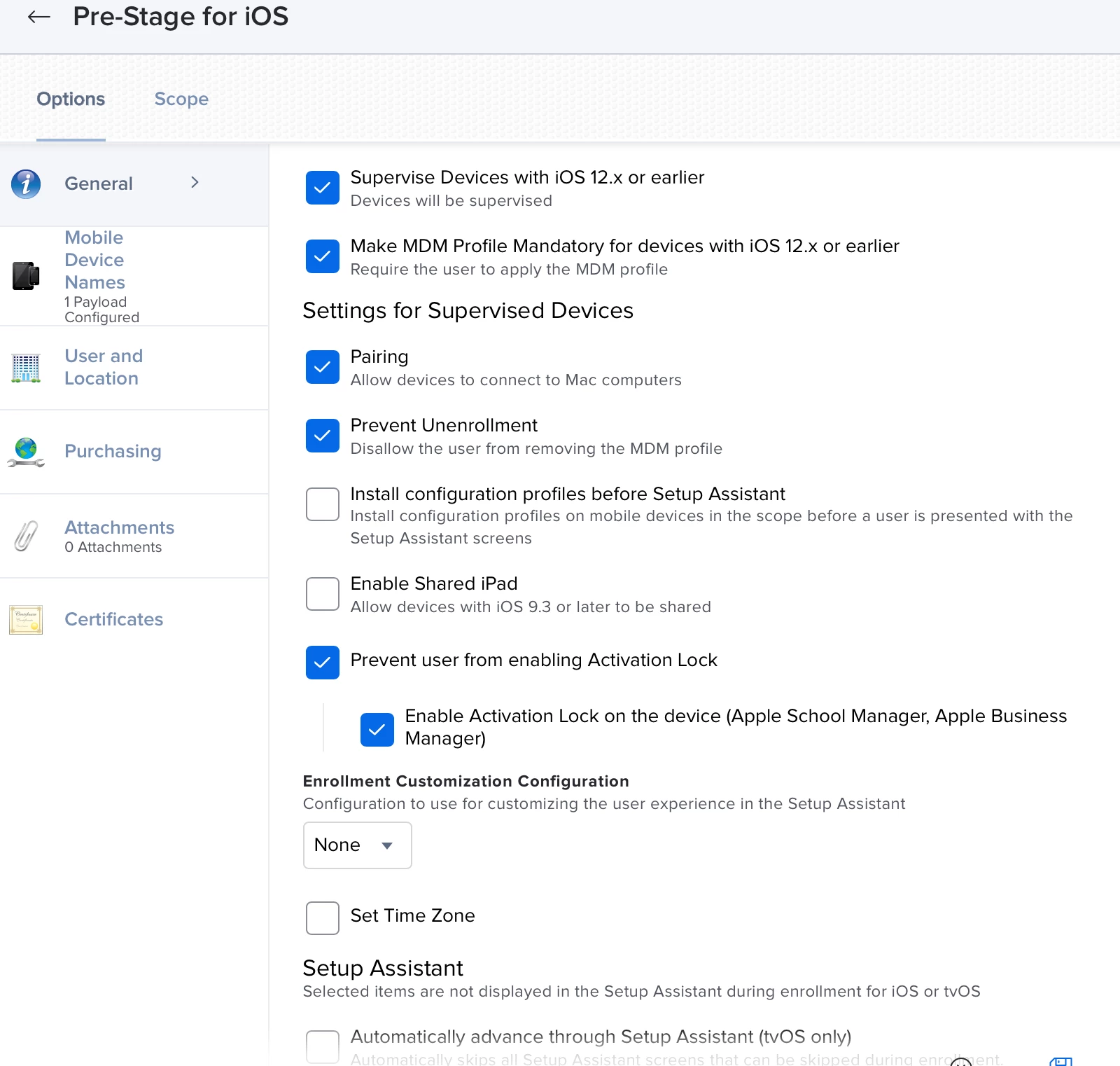

As the screenshot shows, I am not blocking any of the Setup Assistant steps or auto advancing.

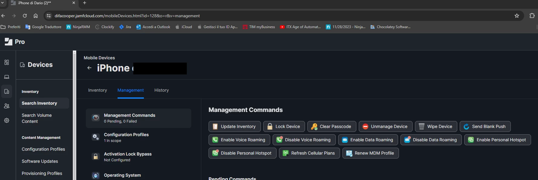

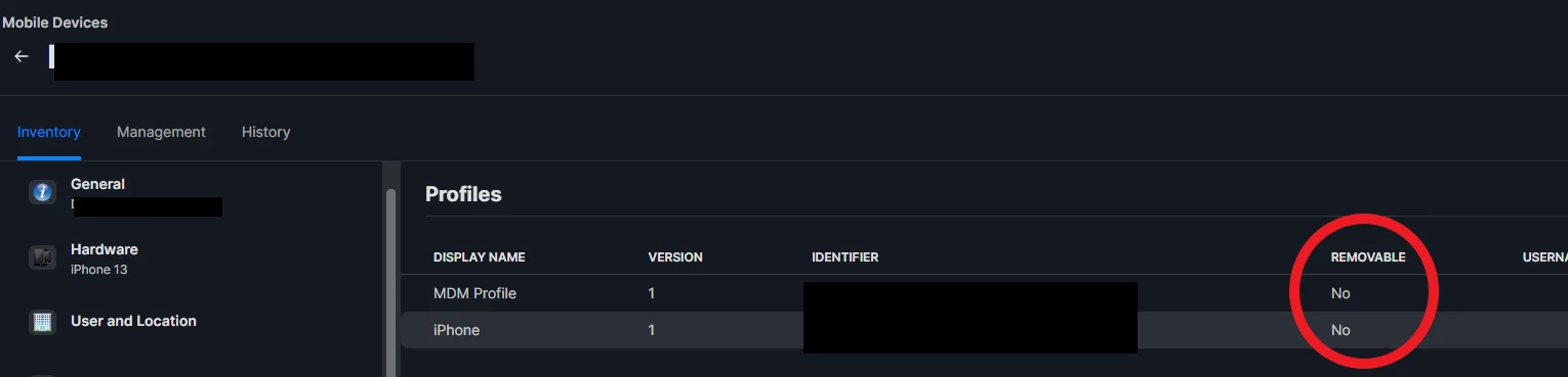

PreStage:
::Management Commands:: Update Inventory Lock Device Clear Passcode Clear Restrictions Password Clear Screen Time Passcode Unmanage Device Restart Device Wipe Device Send Blank Push Enable Voice Roaming Disable Voice Roaming Enable Data Roaming Disable Data Roaming Enable Bluetooth Disable Bluetooth Set Wallpaper Enable Lost Mode Shut Down Device Set Activation Lock Enable Personal Hotspot Disable Personal Hotspot Refresh Cellular Plans Renew MDM Profile Set Time Zone Update Recommend Software Update Version
User Initiated Enrollment:
::Management Commands:: Update Inventory Lock Device Clear Passcode Unmanage Device Wipe Device Send Blank Push Enable Voice Roaming Disable Voice Roaming Enable Data Roaming Disable Data Roaming spotEnable Personal Hotspot Disable Personal Hotspot Refresh Cellular Plans Renew MDM Profile

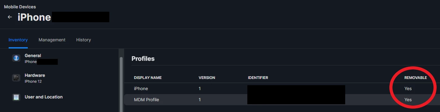

Hi all,
I have the same issue.
I followed the second option, but with the Enrollment Invitations I have less option as compared to other our devices, and the profiles can be removed by the user.
There is a way to resolve the configuration?
Thanks
