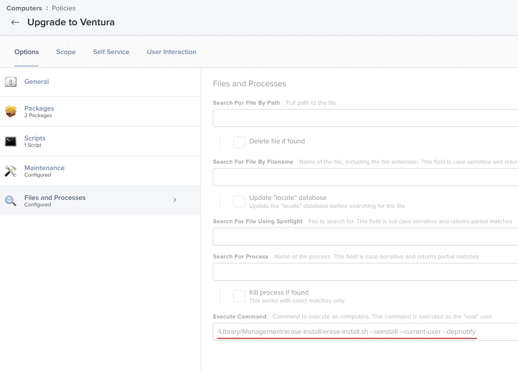

I am working on getting a project to upgrade Macs to Ventura (or Monterey if they wont support Ventura) and I am having trouble. I have reviewed a number of posts on Jamf Nation and setup what others seem to mention works. However, I am not able to get it working and I am hoping someone can help me understand what I am missing. Intel Macs update w/o issue but M1s will not update and error with the "must be volume owner" error.
I have created a policy to install, erase-install and dialog packages, and then start the erase-install with the --reinstall --current-user --depnotify switches using dialog as the prompt. The notification pops up to start the update then I get the error regarding volume owner.

You might need to add a couple of flags to your command.  here's my command, which has successfully upgraded M1 and Intel systems:
/Library/Management/erase-install/erase-install.sh --reinstall --os=13 --update --min-drive-space=60 --current-user --check-power --depnotify --cleanup-after-use
You might also want to doublecheck and ensure the user account you're logged in as has a securetoken, and is part of the volume owner group.  My guess?  The user account doesnt have a securetoken.

Agreed. I am just having trouble assigning a secure token. I will try another macbook. Thanks for the info.
