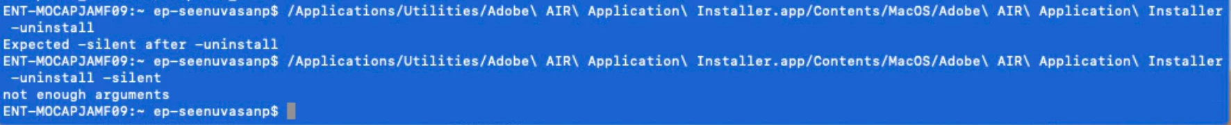

This worked for you? I get "not enough arguments" even after adding "-silent"

I also got the "not enough arguments" error. But looking closer at the Utilities folder, in addition to the Adobe AIR Application Installer.app there's also an Adobe AIR Uninstaller.app. So i tried invoking that with -uninstall tacked on the end:
/Applications/Utilities/Adobe AIR Uninstaller.app/Contents/MacOS/Adobe AIR Installer -uninstall
And that seemed to do the trick. There are possibly other directories/caches left over that I'm missing, but that seemed to remove the main AIR runtime, which is what our corporate security folks want. Test it out and see what you think.
