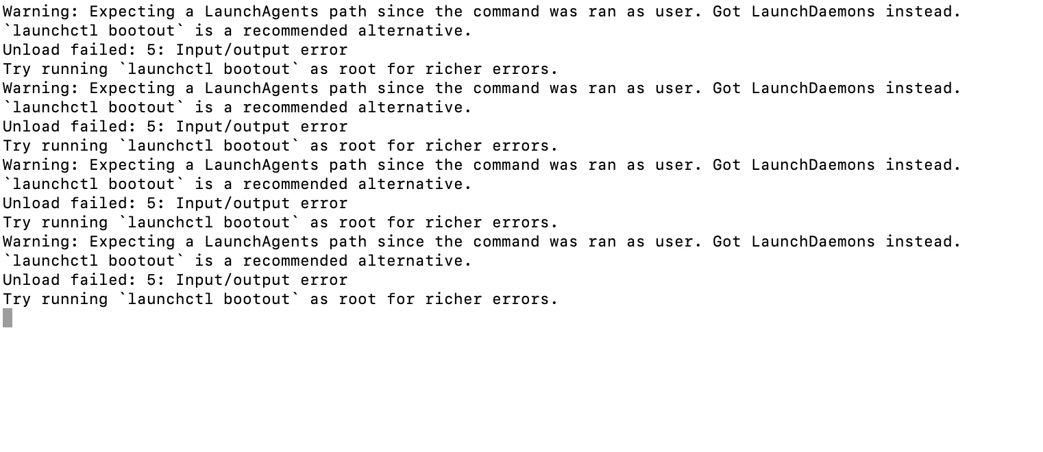

Hi @saikat_tripathi
i tried the first command from your above post on Forticlient 7.x version but i get below errors on terminal.
Can you please help here ?
Thanks

dstranathan
Forum|alt.badge.img+20
  • Aug 28, 2026 5:54 PM UTC
Thank you ​@bwoods
Im using this now in a test environment. I modified a few things after digging (deep!) into this with a support engineer...
1 LaunchDaemon list is incomplete.
It only unloads/removes 3 plists (vpn, fsssoagent_launchdaemon — (note the typo, should likely be fssoagent not fsssoagent), worth double-checking — and epctrl). My sfltool dumpbtm output from days ago showed at least 8+ real LaunchDaemons (fctdnsd, fctservctl2 registered twice under different labels, vpnctl2, webfilter/wf2, ztnafw, PrivilegedHelper, credential_store) — this script would leave most of those running and their plists in place.
2 No LaunchAgents at all — FortiTray, FCTLauncher, fctappfw2/FortiClientNetwork, ztagent are all LaunchAgents per my BTM dump, none covered here (it only kills the processes, doesn't unregister the LaunchAgents that would just relaunch them).
3 Doesn't touch /etc/FortiClient/ or /etc/fct_upgrade/ or /etc/fct_epctrl— meaning the nasty, stale upgrade_backup bug I root-caused for support would still be lurking for the next install cycle.
4 Doesn't call Fortinet's own signed uninstall helper  — pure manual teardown, no attempt to use the legitimate (“official”) install_helper upgrade-uninstall path that exists and works. Is it not a good tool?
5 Possible typo bug?: fsssoagent_launchdaemon (three S's) — worth verifying against the real plist name on a test Mac before trusting this script verbatim, since a typo would make that specific removal silently no-op. I dont have SSO enabled so I dont see this agent.
bwoods
  • Sep 11, 2026 8:40 PM UTC
Thank you ​@bwoods
​@dstranathan, thank you for reviewing my script. Please post the revised version and share it with the community. If you can’t, I’ll revise mine with your notes. Thanks again!
