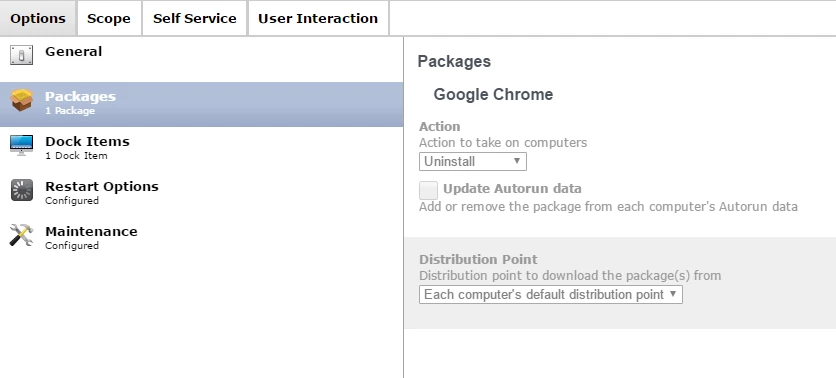

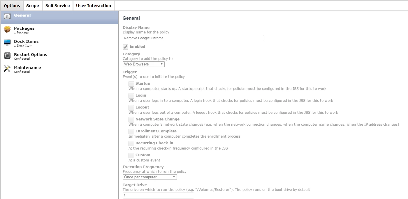

My company just recently purchased jamf and I am the technical lead for deploying it out to our end users. I went through training with a jamf engineer. He informed that you can create a policy that can uninstall a piece of software in self service and we did that with Google Chrome as an example. When I tried setting it up with Firefox, I could not find the option to uninstall the software again. I have attached what the Google Chrome settings look like. When I try with Firefox, I only receive the install, cache, or install cached options.

There are a few ways to deal with this. I tend to follow @Look 's recommendation of making anything I want to regularly uninstall an indexed .dmg (Create .dmg with Composer, upload to Casper Admin, Index the .dmg and then check "Allow package to be uninstalled). Then, you will be able to select "Uninstall" in the policy (In addition to Install, Cache and Install cached). The big trick here is that you HAVE to use indexed, dmg's. If you want to use a .pkg or company supplied installer package you could:
• Run a manufacturer uninstaller package
• Run a script that removes the software and files you wish to remove, which is often far more precise than simply letting the JSS remove whatever you had created in Composer.
In this case, I suspect that either creating an indexed .dmg and running an uninstall policy or creating your own script would make little difference unless you had specific needs upon removing Chrome. I'd prefer to leave any user settings personally so simply nuking the application itself should suffice.

@mcsoellner did you index the Firefox package after you uploaded it to your distribution point in Casper Admin? The package needs to be indexed to be able to uninstall it.

The package has to be a DMG and it has to be indexed.

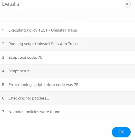

@tak10 Thank you very much for the info! I did try setting up the script in Jamf Pro under Computer Management/Scripts. Or, was I supposed to create a pkg in Composer using this script?
When I deployed it to two Macs they both failed with an exit code 75.
