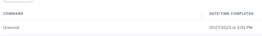

The script I'm attempting to create, grabs the serial from the local device, uses the serial to grab the specific computer ID in the JSS using an API call (this also works fine), and then uses the ID to attempt to unmanage the device (this below is just a stand alone script for testing purposes):
#!/bin/bash echo "Enter JSS username:" read USERNAME echo "Enter JSS password:" read -s PASSWORD TOKEN_EXPIRATION_EPOCH="0" function getBearerToken() { RESPONSE=$(curl -s -u "$USERNAME":"$PASSWORD" "https://<our_server>.jamfcloud.com/api/v1/auth/token" -X POST) BEARER_TOKEN=$(echo "$RESPONSE" | plutil -extract token raw -) TOKEN_EXPIRATION=$(echo "$RESPONSE" | plutil -extract expires raw - | awk -F . '{print $1}') TOKEN_EXPIRATION_EPOCH=$(date -j -f "%Y-%m-%dT%T" "$TOKEN_EXPIRATION" +"%s") } function checkTokenExpiration() { NOW_EPOCH_UTC=$(date -j -f "%Y-%m-%dT%T" "$(date -u +"%Y-%m-%dT%T")" +"%s") if [[ TOKEN_EXPIRATION_EPOCH -gt NOW_EPOCH_UTC ]] then echo "Token valid until the following epoch time: " "$TOKEN_EXPIRATION_EPOCH" else echo "No valid token available, getting new token" getBearerToken fi } function invalidateToken() { RESPONSE_CODE=$(curl -w "%{http_code}" -H "Authorization: Bearer ${BEARER_TOKEN}" "https://<our_server>.jamfcloud.com/api/v1/auth/invalidate-token" -X POST -s -o /dev/null) if [[ ${RESPONSE_CODE} == 204 ]] then echo "Token successfully invalidated" BEARER_TOKEN="" TOKEN_EXPIRATION_EPOCH="0" elif [[ ${RESPONSE_CODE} == 401 ]] then echo "Token already invalid" else echo "An unknown error occurred invalidating the token" fi } echo "Getting API token..." checkTokenExpiration # Get serial number SERIAL=$(system_profiler SPHardwareDataType | awk '/Serial/ {print $4}') /bin/echo "Serial number is $SERIAL" # Get JAMF ID of device JAMF_ID=$(curl -X GET "https://<our_server>.jamfcloud.com/JSSResource/computers/serialnumber/$SERIAL" -H "accept: application/xml" -H "Authorization: Bearer $BEARER_TOKEN" | xmllint --xpath '/computer/general/id/text()' -) /bin/echo "JAMF ID for $SERIAL is $JAMF_ID" # Unmanage the device /bin/echo "Attempting to remove device from Jamf management..." curl -X POST "https://<our_server>.jamfcloud.com/JSSResource/computercommands/command/UnmanageDevice/id/$JAMF_ID" -H "accept: application/xml" -H "Authorization: Bearer $BEARER_TOKEN" # Bin the token /bin/echo "Invalidating API token..." invalidateToken /bin/echo "Done." exit 0;
Strangely, when I run the above, there does appear to be an "Unenroll" command sent to the JSS:
However, nothing seems to be changing.

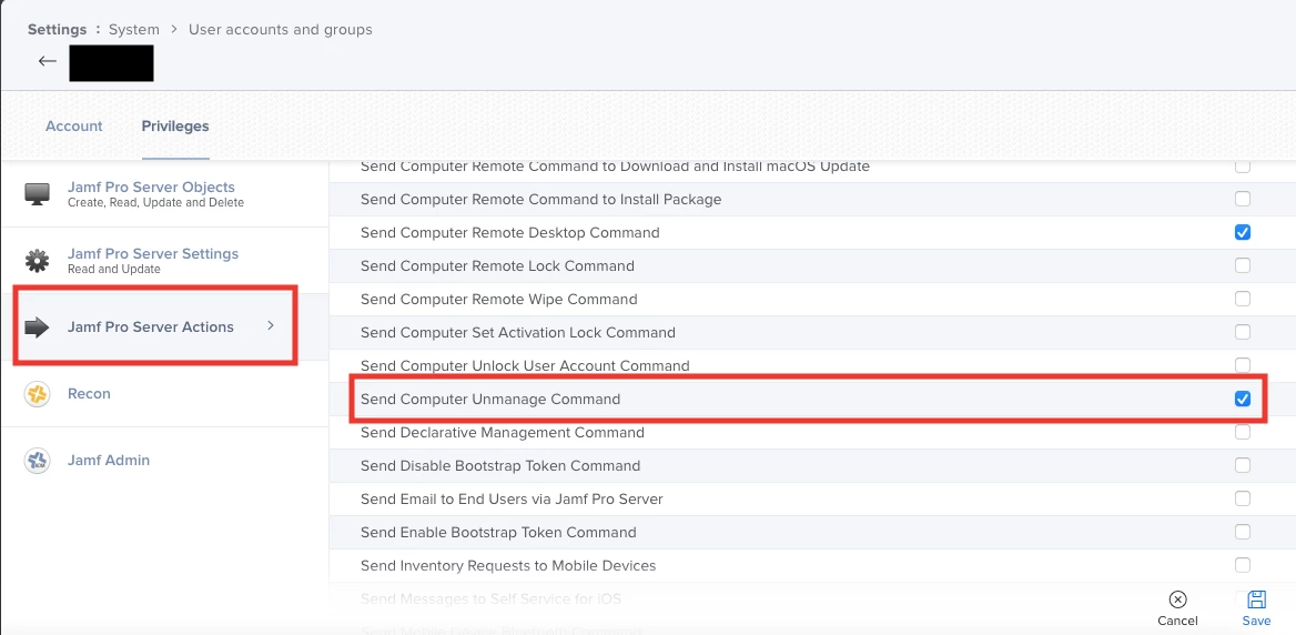

@rcoleman I trying to get the Unmanaged Command to work, do you know what minimum permissions that is needed? I have Jamf Pro Server Actions -> Send Computer Unmanage Command and Computer Read
Thanks!
Thanks!
@Mikael_lofgren I actually just ran into this issue. We use a dedicated API account with encrypted details for performing API operations and on my last test with this it complained about permissions. During my testing, I used my own account which has full permissions and it worked fine. Unfortunately I don't have time just now to investigate this further however on first look I believe for the account being used to perform API operations you'll need to make sure "Send Computer Unmanage Command" is selected. If you manage to try this let me know if it works:
EDIT - Sorry, I've just realised that you've mentioned this is already selected! In that case I'm not sure what will be required. We also use the account for enabling remote management using MDM command and that works fine. When I get time to investigate further and if I come up with a solution then I'll make sure to post.
Thanks!
@Mikael_lofgren Just to say this worked for myself and I only have the same permissions you listed above, so apologies but I'm not sure what's going wrong at your side :(
@rcoleman My command seems to work when using full permissions, I have opened a support case to get this sorted, can post any findings here when done. Thanks!
  • Feb 3, 2023 11:30 AM UTC
@Mikael_lofgren That would be great, many thanks. It's possible I made a change to the permissions a long time ago for our API account but just can't remember, so it certainly would be useful to know exactly what permissions are required.
Ahh think I missed, create in Computer objects, but this is the minimum to work, response code from API when working is 201.
# Jamf Pro Server Objects > Computers Create, Read and Update
# Jamf Pro Server Actions > Send Computer Unmanage Command
