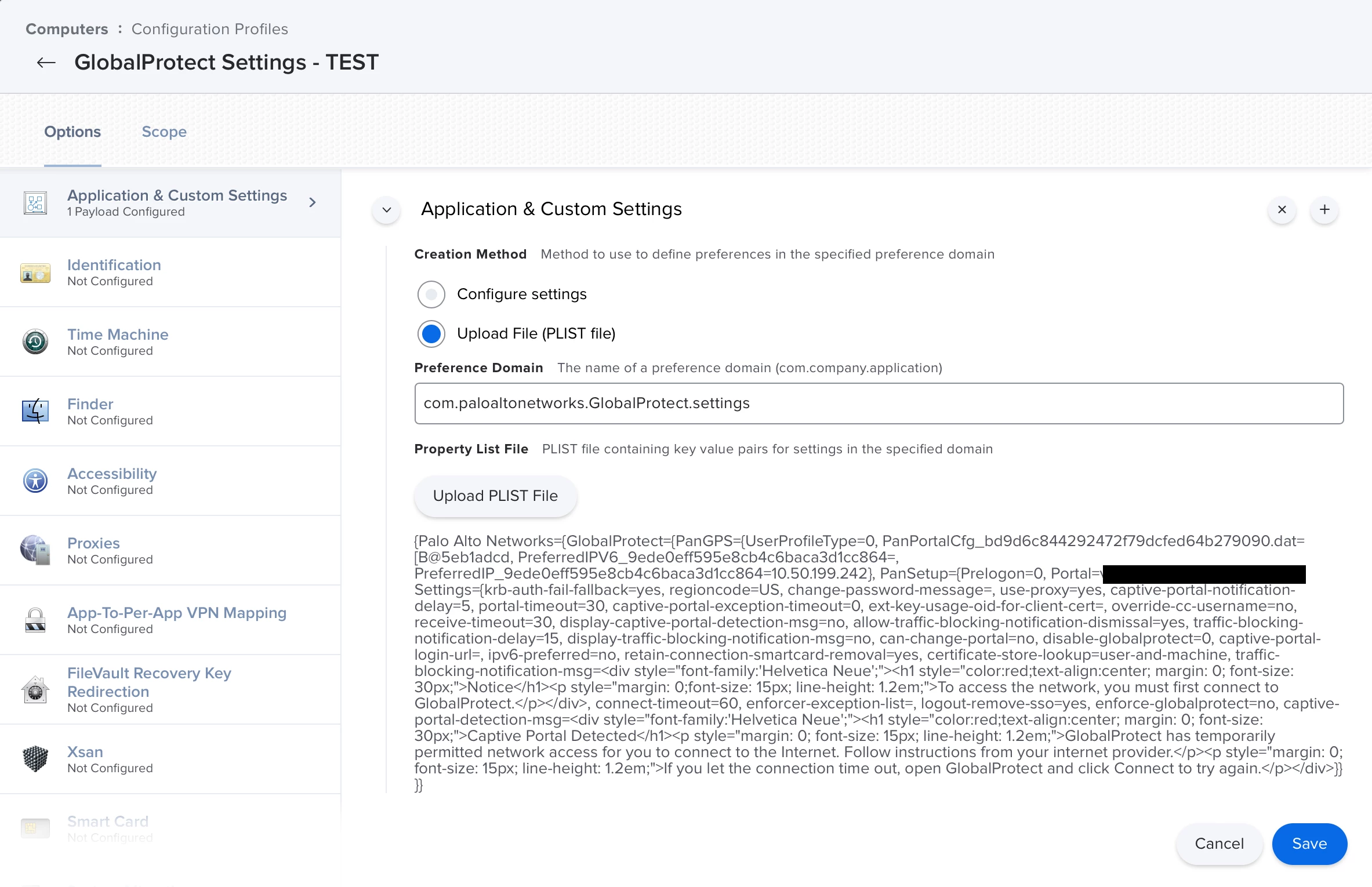

I think I'm pretty clear on the formatting of the plist file and its contents. What I'm not so clear on his how to get Jamf to place that file into the correct folder so that GlobalProtect can use it. Here's a screenshot of my profile after uploading my plist, if it helps:
  • May 10, 2020

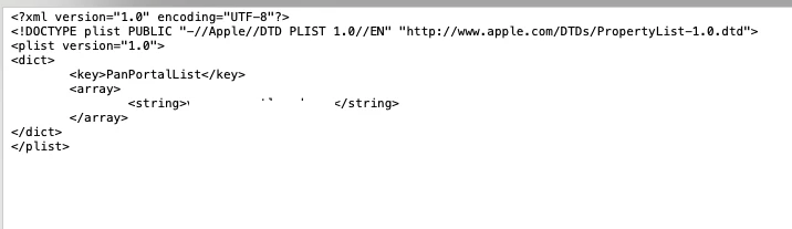

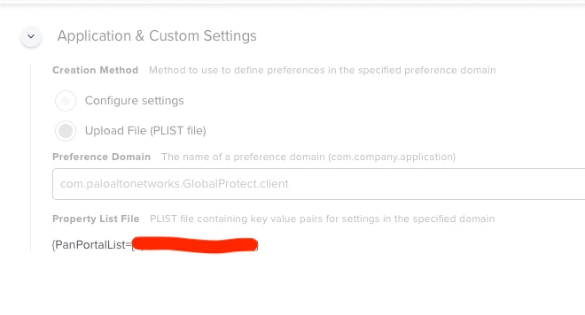

@mcantwell Hi mcantwell, just letting you know you don't need to capture everything on your plist. You captured things like you preferred IP address which will be pushed to all devices. I'm not sure how this is going to work on devices where this would be hardcoded onto a plist and enforced. You are better off just editing the plist down to only the fields you need. See images below, all I need is the vpn address to be enforced so that is all I have.
the plist I created by doing this command in terminal:
sudo defaults write ~/Desktop/com.paloaltonetworks.GlobalProtect.client.plist PanPortalList ENTERYOURVPNHERE
sudo plutil -convert xml1 ~/Desktop/com.paloaltonetworks.GlobalProtect.client.plist
this will create a preformatted plist on your desktop ready to be uploaded to JAMF config profiles
if you NEED to enforce other settings take a look at the plistbuddy commands above from @cbrewer to set them to this same file before the plutil command. If you do need to make changes just make one at a time, test deployment then add another once it is working
