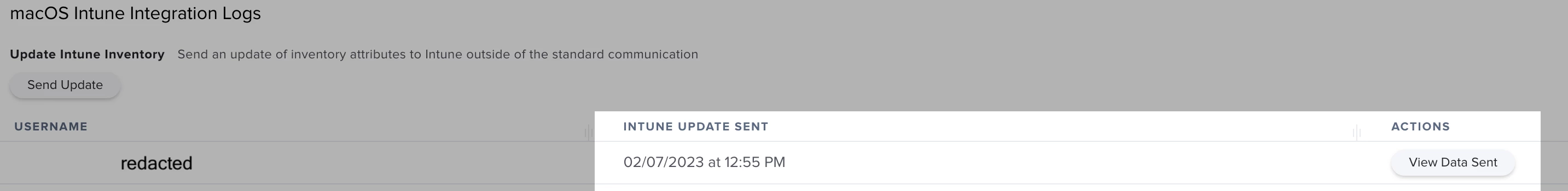

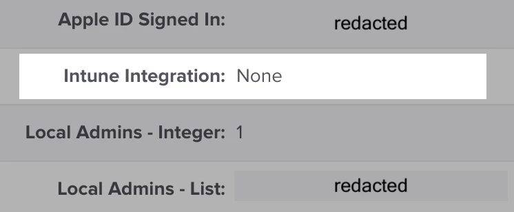

I found this thread for an Intune EA, but am getting conflicting information. I check if a user is enrolled in Jamf by navigating to their computer, clicking the History tab, then navigating to macOS Intune Integration Logs. The extension attribute will return "None" despite the user being enrolled with Intune (see screenshots attached).
I have tried to find documentation on creating a smart group based upon the Intune Integration reporting Jamf already has, but have not been able to find any. I also quickly glanced through the Jamf Pro API reference and documentation to see if this could be accomplished via the API but was unsuccessful.
Any help would be appreciated! Thank you for your time!

I use this EA for Intune Registration:
https://github.com/benwhitis/Jamf_Conditional_Access/blob/main/EA_registrationStatus
Additional background info is available here:https://community.jamf.com/t5/tech-thoughts/macos-conditional-access-best-practices/ba-p/273760
That so far has worked perfectly. Thank you so much!
