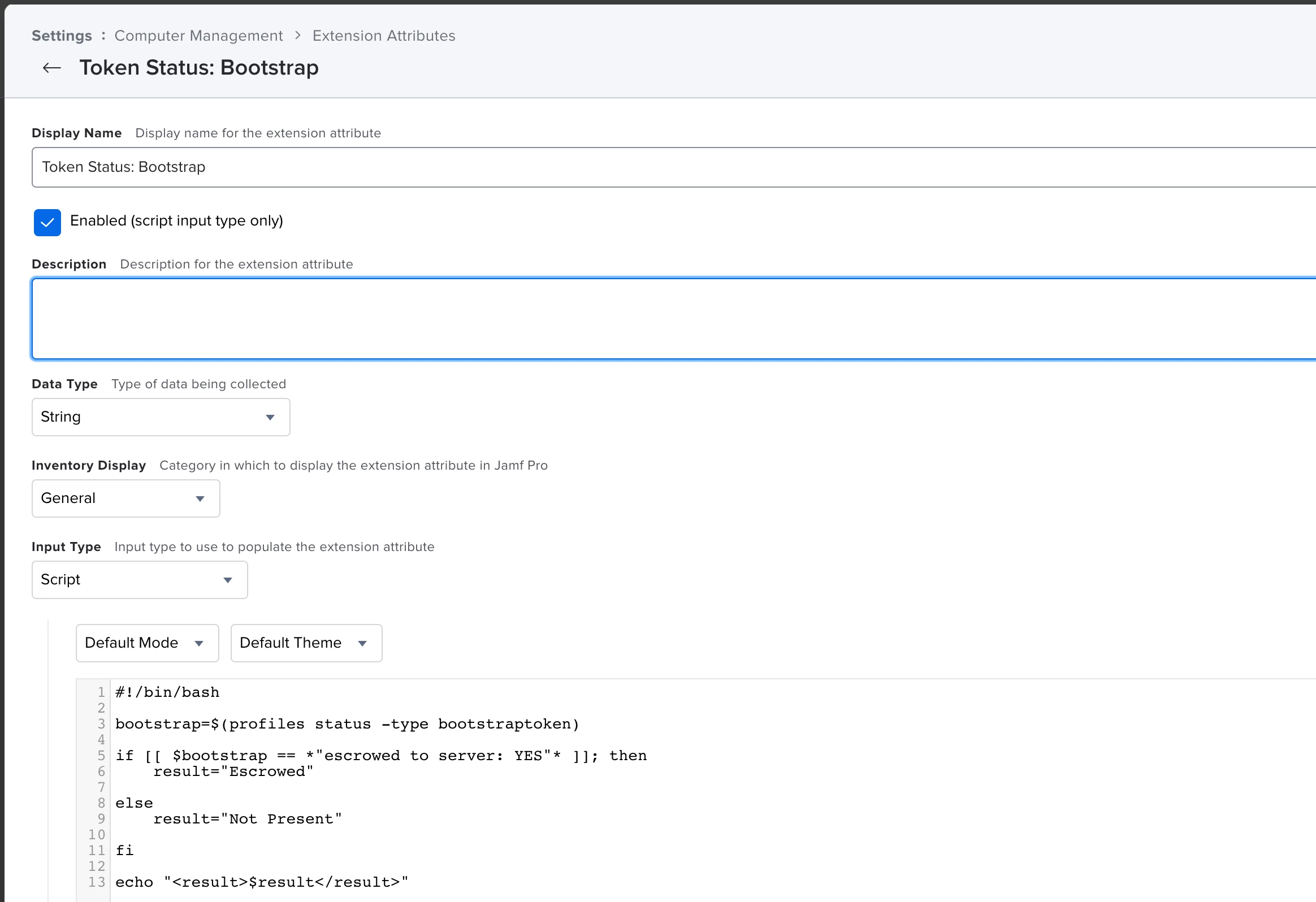

Did you confirm that the Bootstrap Token has been escrowed?
I create a Smart Group for deploying updates via MDM, part of the criteria for that group is an extension attribute. The extension attribute returns whether or not the Bootstrap token is escrowed.
#!/bin/bash bootstrap=$(profiles status -type bootstraptoken) if [[ $bootstrap == *"escrowed to server: YES"* ]]; then result="Escrowed" else result="Not Present" fi echo "<result>$result</result>"
@Hugonaut Thanks for posting the Bootstrap Token is escrowed check EA. I'm trying to use sh for all my EAs these days since Apple's removal of Python 2 in 12.3 seems to indicate they may follow through with removing bash, so here's an sh-ified version:
#!/bin/sh # Checks to see if the Bootstrap token has been escrowed with the MDM server # Returns: "Escrowed" if yes, "No" if not # # An sh compatible implementation of https://community.jamf.com/t5/jamf-pro/updating-macos-by-sending-a-mass-action-command-require-to-have/m-p/263035/highlight/true#M242120 result="No" bootstrap=$(/usr/bin/profiles status -type bootstraptoken | /usr/bin/grep "escrowed to server: YES") if [ -n "$bootstrap" ]; then result="Escrowed" fi echo "<result>$result</result>"
