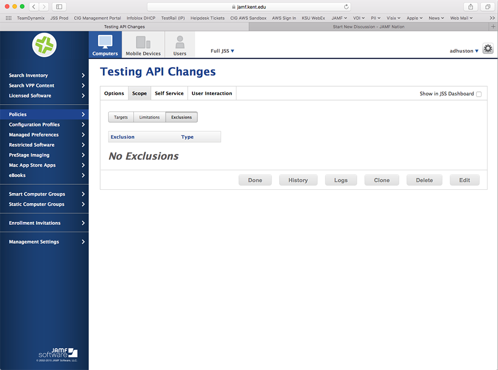

If I take a looks at the Policy Scope on the JSS the group is not in scope:

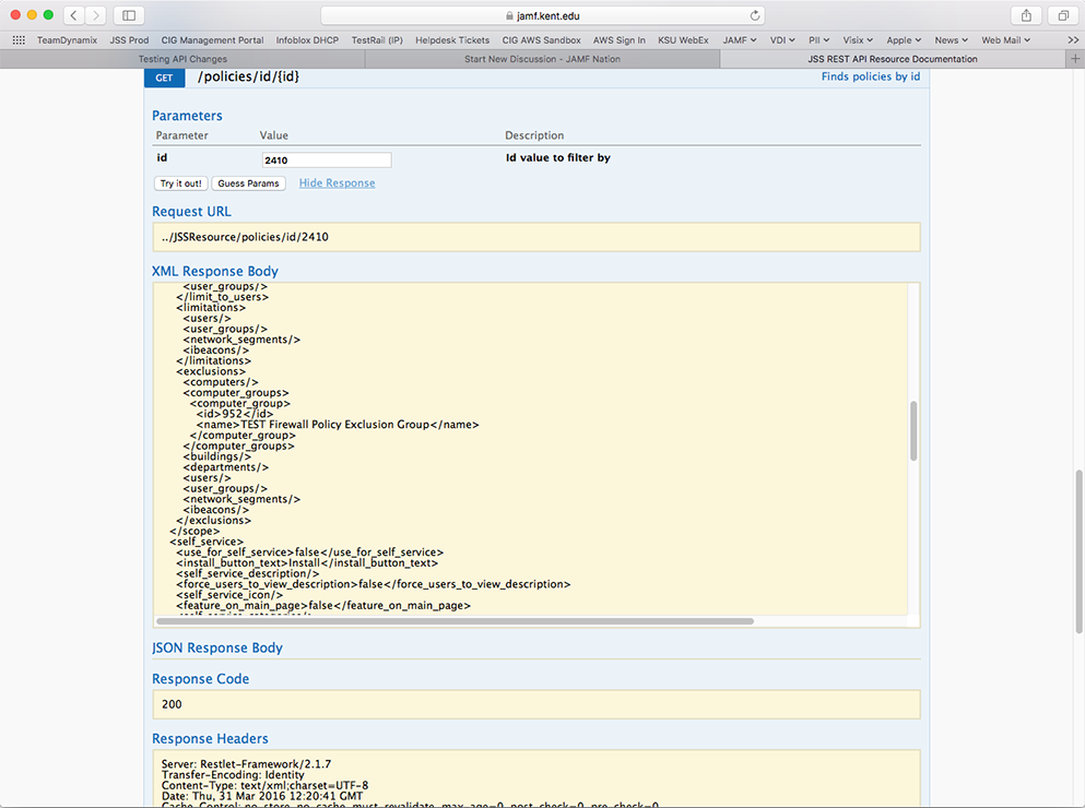

However, if I take a look at the API it is listed:
I think I'm missing something in my XML, but am not sure what. I think it has something to do with the fact that the policy I'm modifying is in what I call the central site, or no site, and the group is under the new site I just created earlier in the script. Wanted to see if anyone else is using the API to do this kind of work and see if they have any sage advice. Thanks in advance!

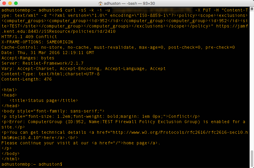

I thought that too, initially. I tried it both with and without the <name></name> tags and it didn't seem to care either way. It still adds it to the policy in the exclusion section in the API if you just specify the group ID. But if you look at the policy scope the computer group does not appear.
The fact that I'm running into the same error in both the Curl command and the Invoke-RestMethod in Powershell leads me to believe it's something in the XML. The do essentially the same thing, just in a different language.
The <site></site> XML information came from the only post I could find while Googling the issue. I found a post where supposedly they fixed the issue by specifying the site that the group belongs to. Doesn't appear to be the case.

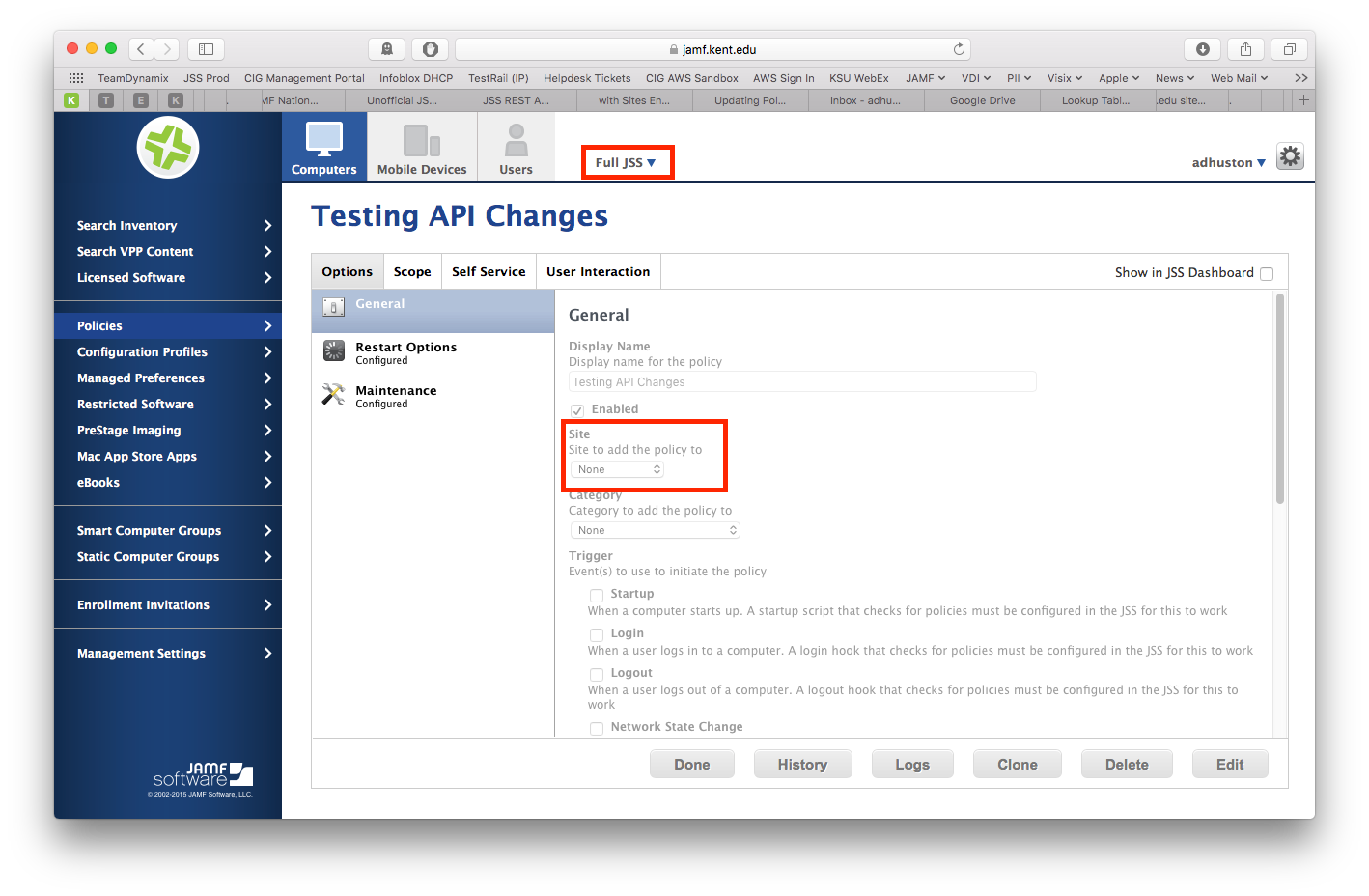

You're off by a little bit, but close. The policies that I have applied to all computers are under the Full JSS:

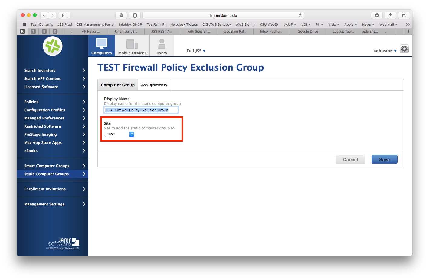

the group that I am trying to add is under a Site:
If I use the same command on a policy that is located in a Site it appears to work. It just appears to be when you cross the line between the Site and the Full JSS.
The reason I'm doing this is so that the Site Admins have the ability to add computers to the groups themselves. We do not allow our Site Admins to have access to the Full JSS. They only have site access.

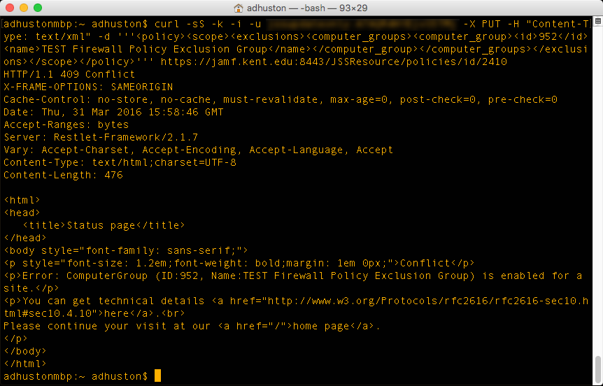

Sure! Here's a screenshot:
  • Mar 31, 2016 4:25 PM UTC
curl -k -Ss -u username:password https://jss.url.here:8443/JSSResource/policies/id/2052 -H "Content-Type: application/xml" -d "<policy><scope><exclusions><computer_groups><computer_group><id>344</id><name>Test Static Site Group</name></computer_group></computer_groups></exclusions></scope></policy>" -X PUT
Did not work. I must have mixed it up before.
It doesn't seem like it's possible. I'm getting the same conflict error as you do. My only bet is to talk with your TAM and see what they can come up with.
TJ
