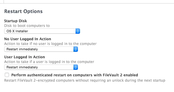

While @psliequ is correct, CreateOSXInstallPKG works, you may just have a setting off on your policy to install. @exno do you have the restart tab on your install policy configured? I've had success with all of my Self Service upgrades (10.8 up to 10.11) with having the Restart Options configured like the following:
http://cl.ly/image/352w1h1V093y/Screen%20Shot%202015-10-01%20at%209.16.00%20AM.png

@stevewood that would be it... I typically set the same Restart Options and had never had issues in the past. Seems it didn't save my changes to the restart options this time though... I probably should have checked that when it white screened twice during policy creation lol.
still not sure how it was booting to recovery from current startup disk but this did fix my issue.
Thanks!

  • January 9, 2016
http://imgur.com/JZAqdI2
Imgur link for those of us that have corporate blocking of anything and everything ever that's on the internet.
And attached for good measure as well.
