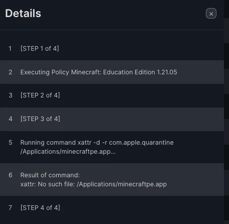

Hi All,
We did the update to a more recent version of Jamf Pro. We lost the Jamf Admin.app feature and now I'm having issues getting packages into Jamf Pro. I have tried using Jamf Sync, and also just copying the files directly to one of our FSD points. Then I create the package entry under Settings -> Computer Management -> Packages  with the package filename as the display name and add the filename of the package and save.
Here's what I am seeing:
 It's not even trying to install the package from an FSD. I had a similar situation a few weeks ago, and it just starting working on its own, so I am wondering do I have to do anything else for Jamf to 'see' the package? We have 24 FSD points, do I need to sync the file with each FSD? I thought it used to sync automatically if I added the file to the principal distribution point.
Any info is helpful..

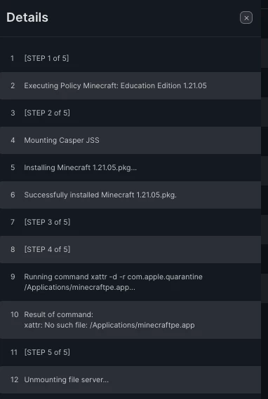

  • Sep 17, 2024 3:08 PM UTC
We have 24 distro points. I uploaded the package to the main distro point and my laptop that I was testing on is set to use that distro point as defined in network segments. What I usually see is Jamf at least looking for the package, which you can see in the screenshot it isn't saying the package is missing.
yeah Its not showing any data for step 2 or 3. On the successfully deployment does it show data for those steps?
  • Sep 17, 2024 3:37 PM UTC
Yep. After sitting all weekend, it worked on Monday morning.
