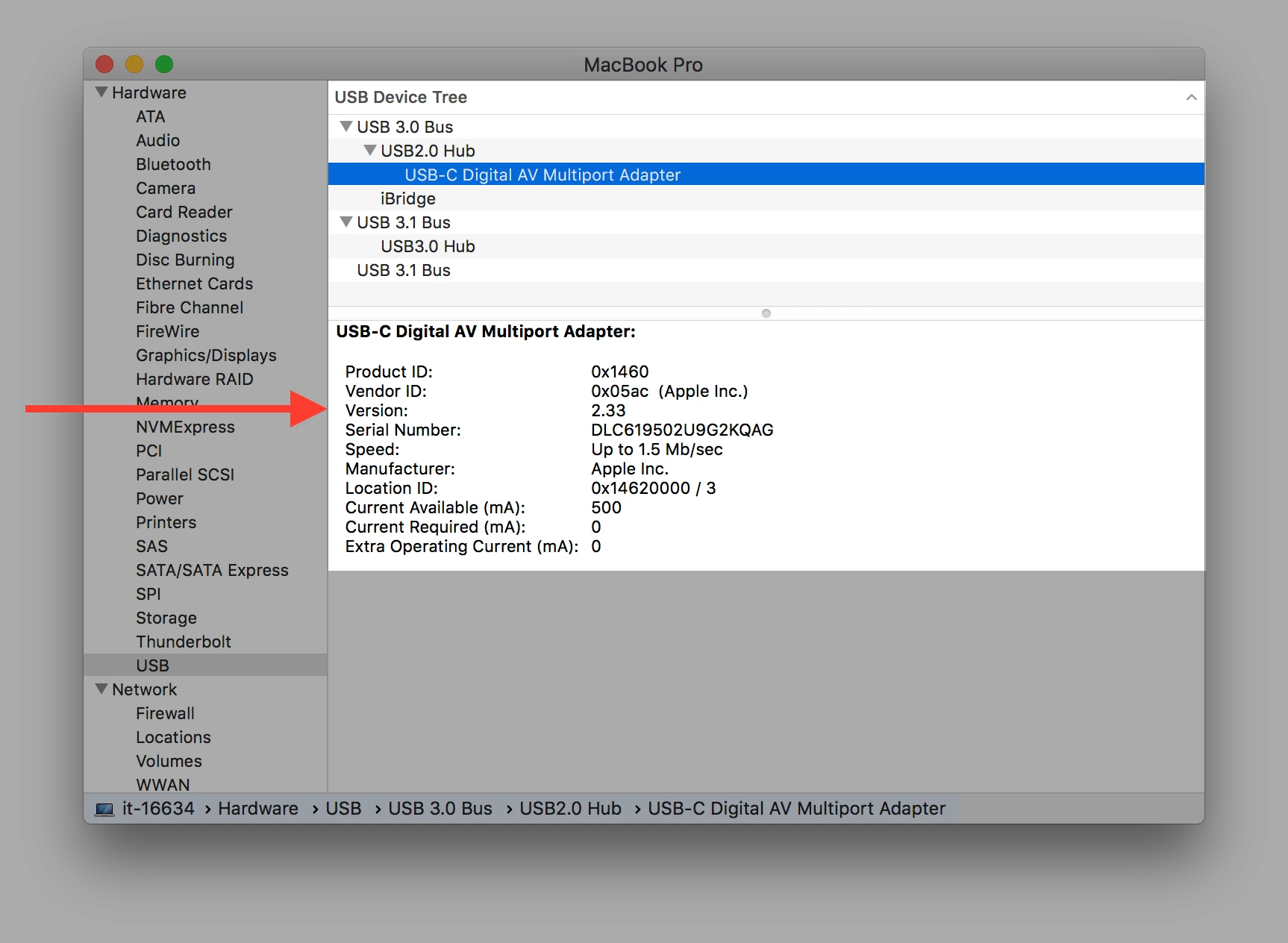

Hey there, all! I have some new MacBook Pro devices with the new USB-C inputs. My organization has decided to deploy the USB-C Digital AV Multiport Adapter with this new fleet. Users are being prompted to install an update associated with this adapter. Simply running the update and restarting did not appear to properly install software. After doing some digging, I was able to find Apple's quick documentation on this here. Not surprisingly, this worked like a charm!
My question to you all is this: is anyone out there using the USB-C Digital AV Multiport Adapter and hasn't had to perform this update? I am asking because our provisioning process (via Casper Imaging) involves erasing the hard drive and then block copying macOS Sierra 10.12.3. I am wondering if the update is installed with the out-of-the-box image. Can anyone confirm this theory?

Yes, I was having that issue also. I was plugging in two adapters at once and installing the update. After a reboot, the update popped up again. So I ran the update again... Still, every time I installed the update, I'd get prompted again to install after a reboot. I was able to fix the issue by using only one adapter at once, install the update, reboot. That fixed the problem, after that, I was able to use as many adapters as needed w/o getting that update promoted again.

Have anyone found a way to deploy this? I found this link that talks about how to download the package, but when I run it through casper, through the GUI, or through the command line it errors out saying it doesn't apply to this OS (10.12.3).

At least on our 10.12 machines, the updater package seems to be pre-downloaded as either part of the OS or an automatic download triggered by connecting the adapter to the machine. We've got a Self Service policy enabled that runs the .pkg installer that's stored by the OS for (re)use:
installer -pkg "/System/Library/CoreServices/Firmware Updates/USB-C Multiport Adapter/adapterupdate1.pkg" -target /
