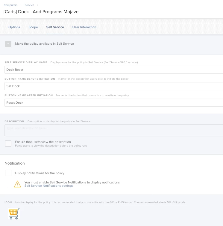

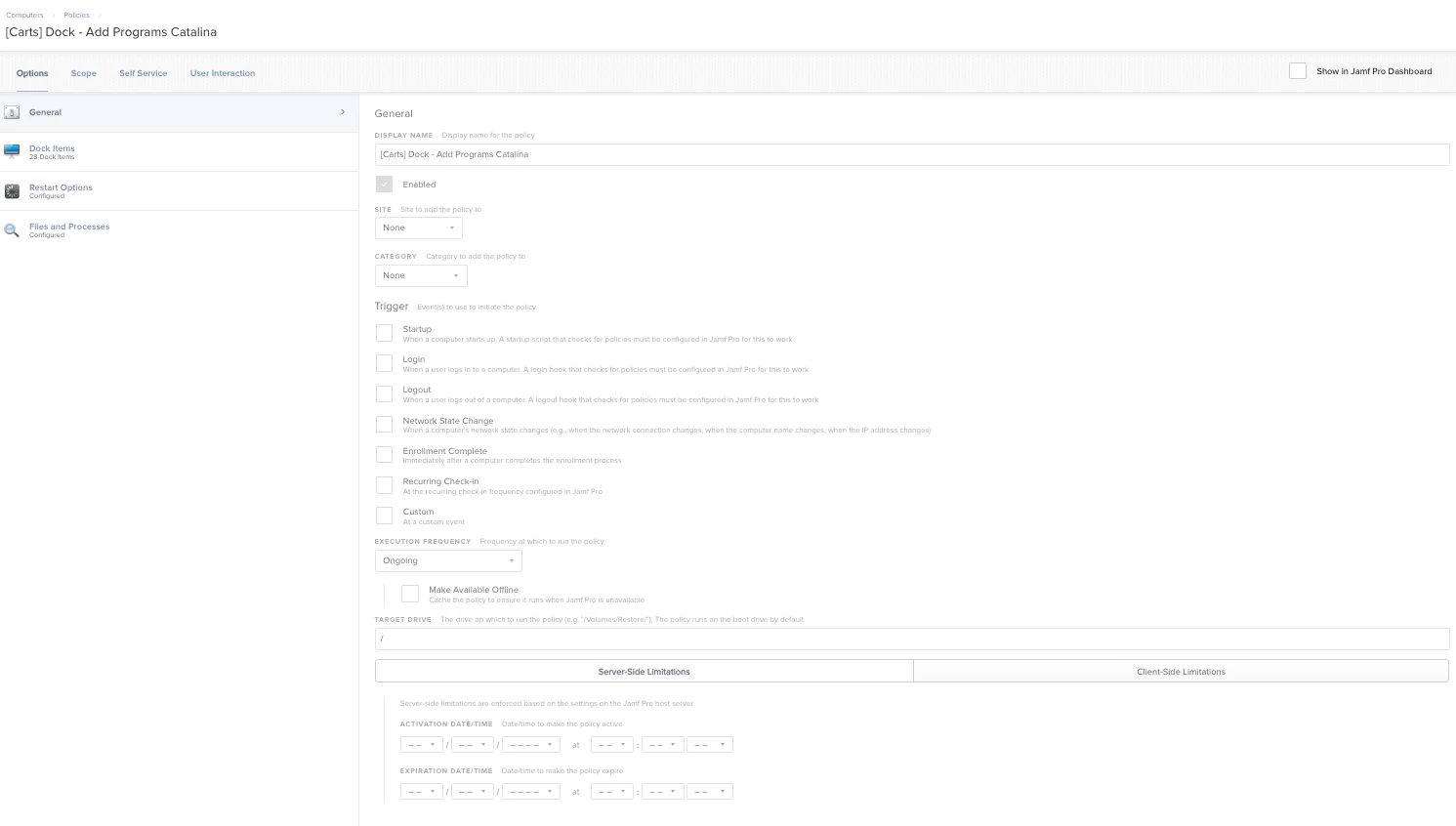

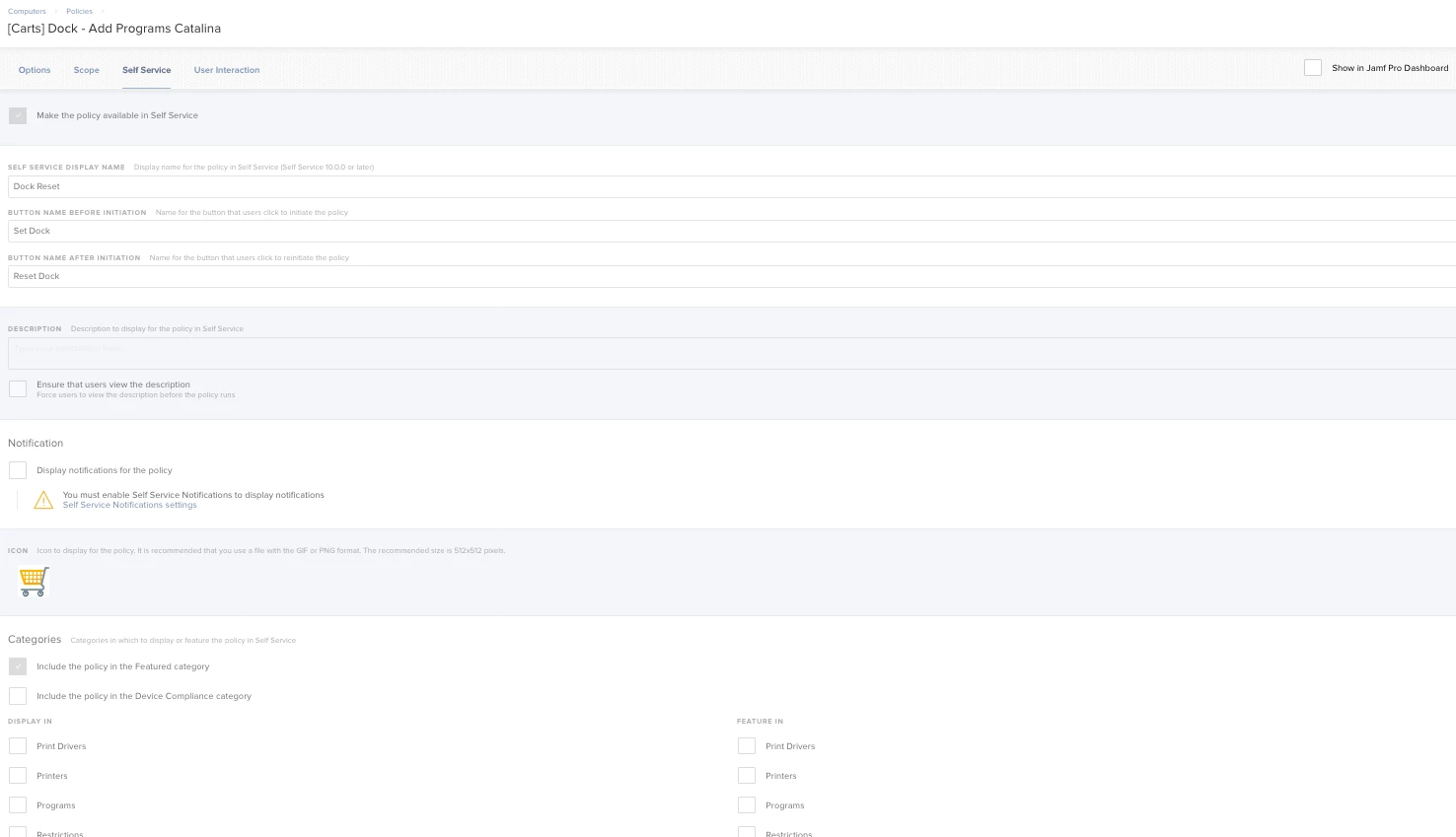

It is definetly possible. Set to ongoing and make sure you fill out the Self Service tab

@larry_barrett strange, i had the execution frequency to 'once per user', then 'once per user per computer' and it didn't appear until i set it to 'ongoing'.
why it only appears when using 'ongoing'?
Well @tcandela if you're set to once per user or once per user per computer, you'd have to flush the entry for it to show up in Self Service again. Those frequencies only show up in self service if the policy has not been run (yet)

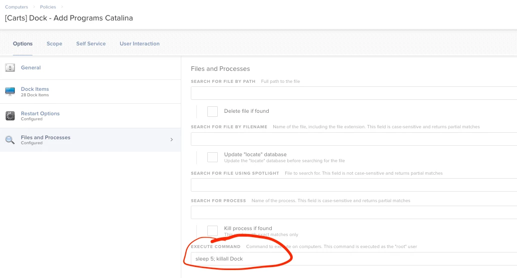

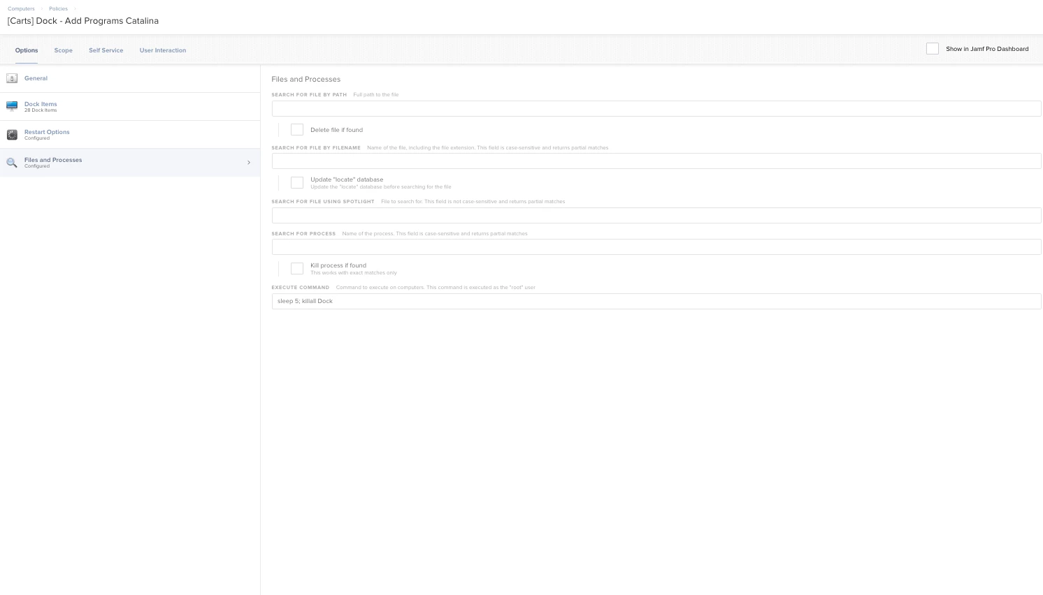

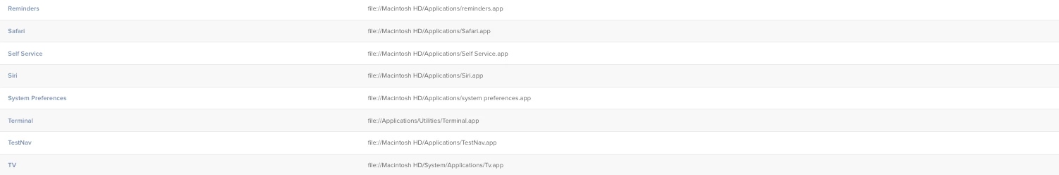

@tcandela I encourage you to not "die on the hill" of once per user. In our mobile carts, we leave it in Self Service so anyone (teacher, para, kid) can reset the dock back to a default state. I understand you want it once per, but there's no benefit to doing it once. Alot of things can change your dock: unexpected containers (I'm looking at you Flash Player), random utility programs (like Disk Utility or Font book). If you don't account for those in your Dock Items, your mileage may vary... Include this bit of magic and set it to login/ongoing +available in Self Service (see attached).

@larry_barrett so the sleep 5; killall Dock just refreshes it with the changes?
so you have a separate policy that sets the Dock back to its default? (would below work in 'EXECUTE COMMAND')?
defaults delete com.apple.dock; killall Dock

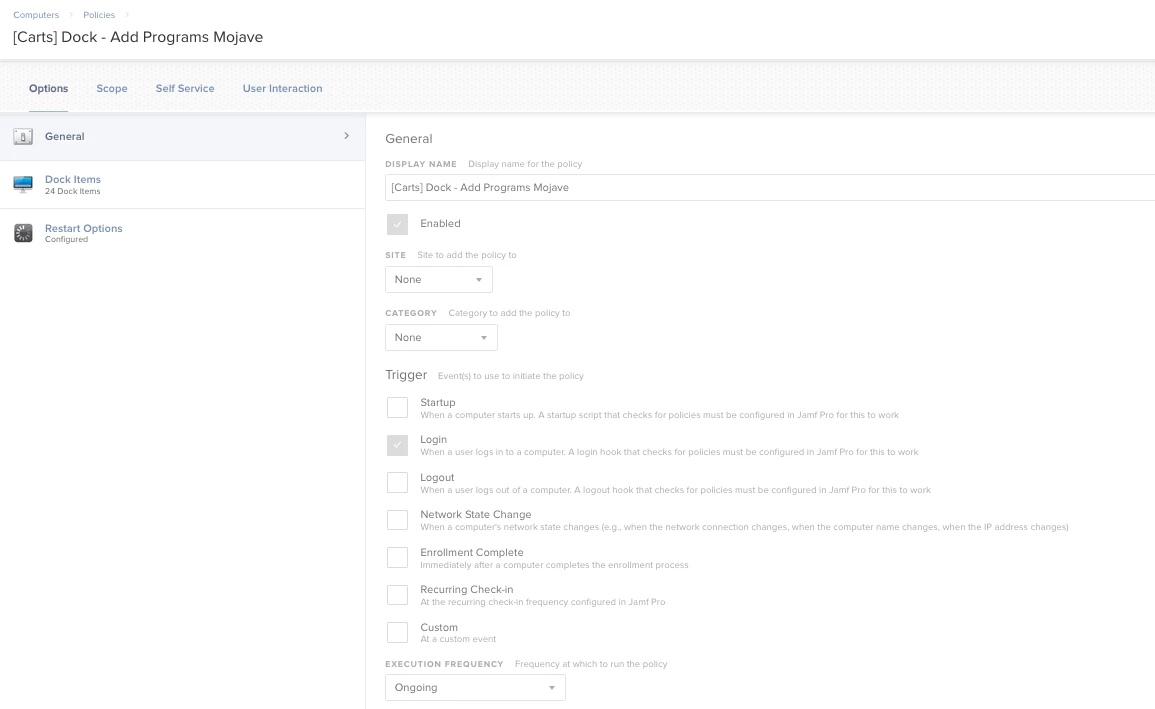

I only have the one policy set to login (see photo) and Ongoing. It doesn't work 100% of the time, specifically I have a hard time with webhooks on the dock. Occasionally I'll have to drag them back onto the dock from Library -> Application Support -> Configuration Profiles.
As to your issues with the Login trigger, if you aren't running the code mentioned above ( sleep 5; killall Dock ) I wouldn't expect it to ever work. I don't know the answer to the defaults deleting bit, but you should totally share your results.

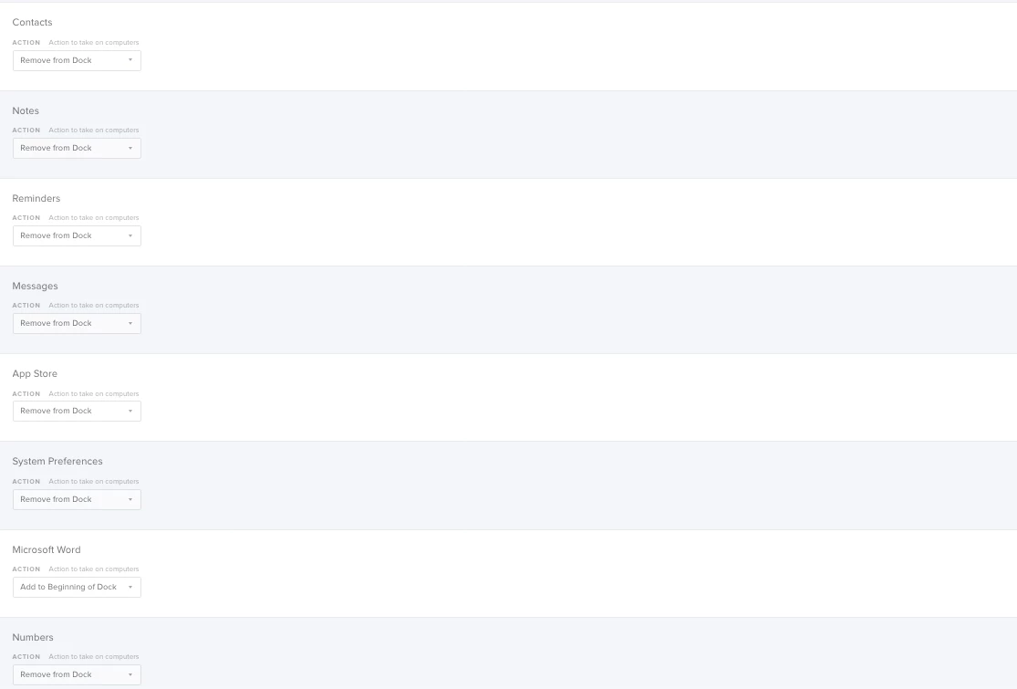

I have a Self Service policy basically removing all the Apple dock items and adding Office Word, Excel, PPoint, Firefox .......

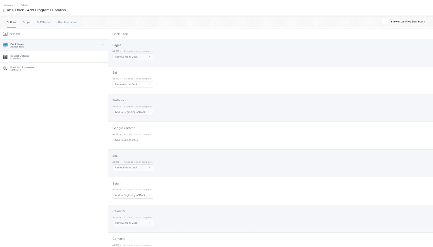

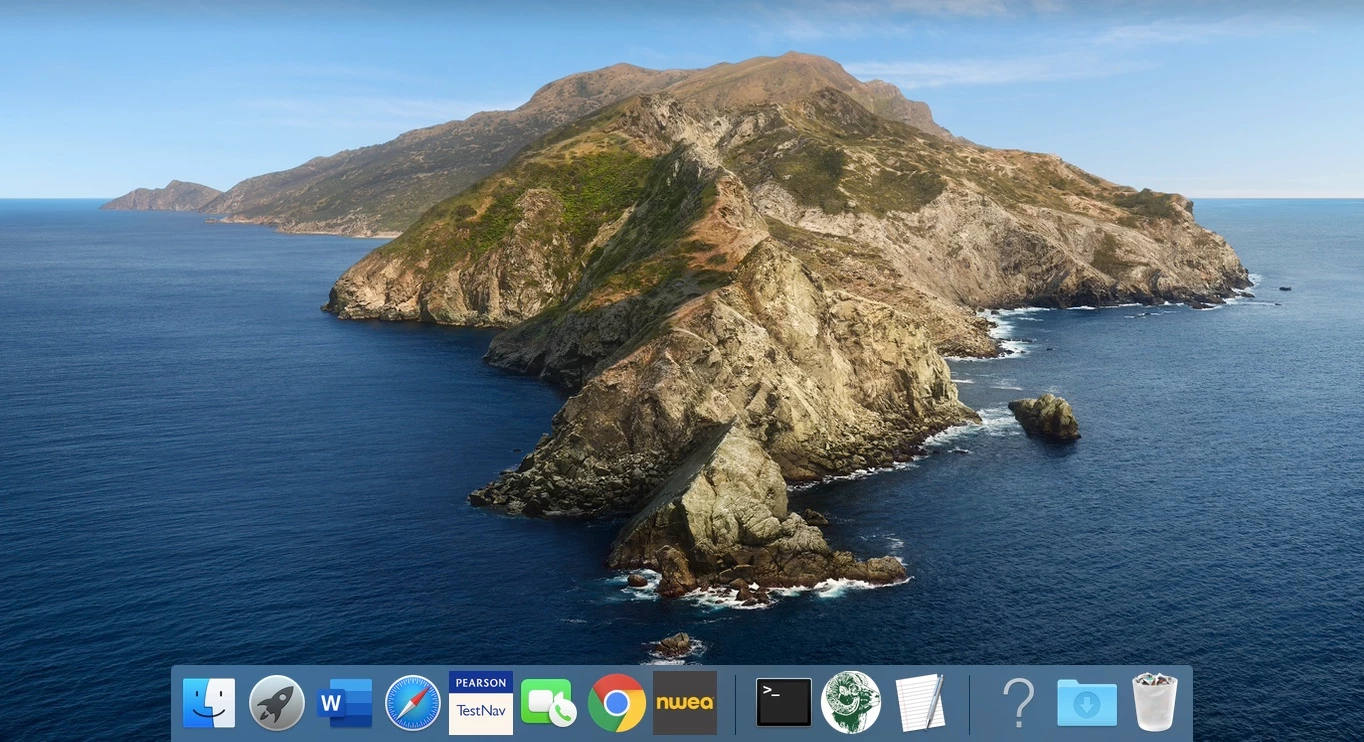

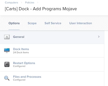

I'll post my entire policy. I can't replicate your error. Just in case, I'm on 10.15.3 with on Prem Jamf Pro.
A few things to keep in mind. Defaults is a command-line tool. For you to be able to use files and processes or a script, you will have to mimic the behavior of the Defaults program. Defaults basically lets you edit any .plist file, in my head this means you would have to nuke the plist file or something similar. com.apple.dock is in Library/Managed Preferences/User Name.
Also, if you use defaults delete com.apple.dock, the com.apple.dock file will be empty until you do one of two things: change the dock (think right click and remove from dock) or restart. Attempting to delete the file a second time will throw up an error since it's empty from your deletion.

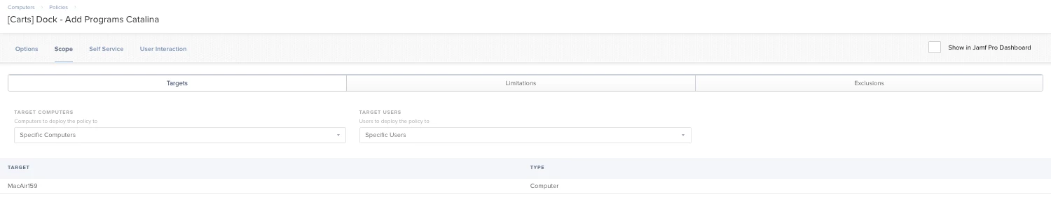

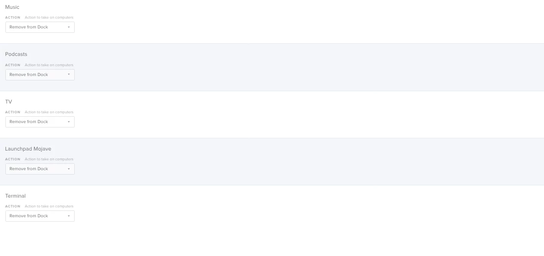

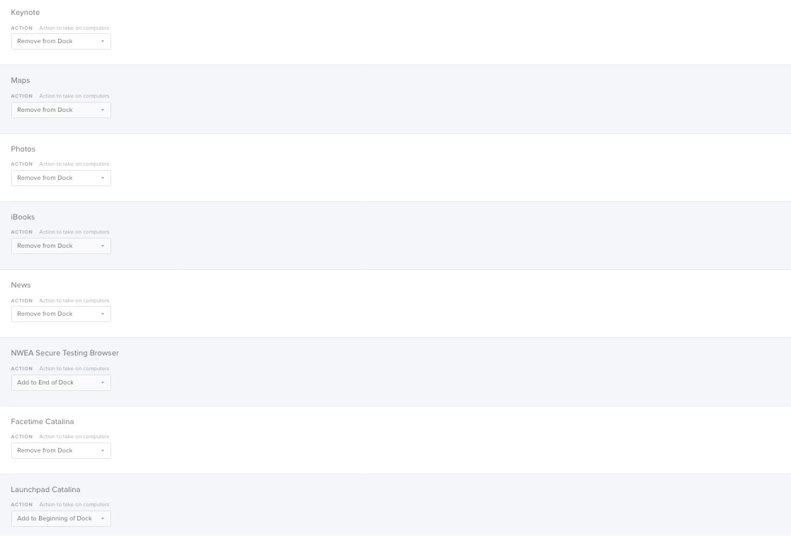

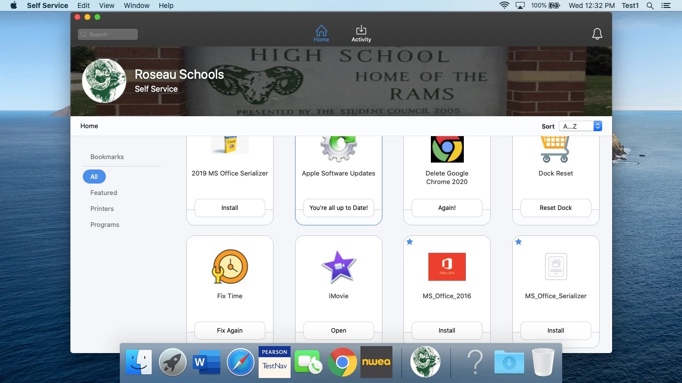

Finally, here's screen shots of two different users on the same machine using the above policy. I don't know how you are achieving what you are achieving, but it's really interesting to me. Don't give up.

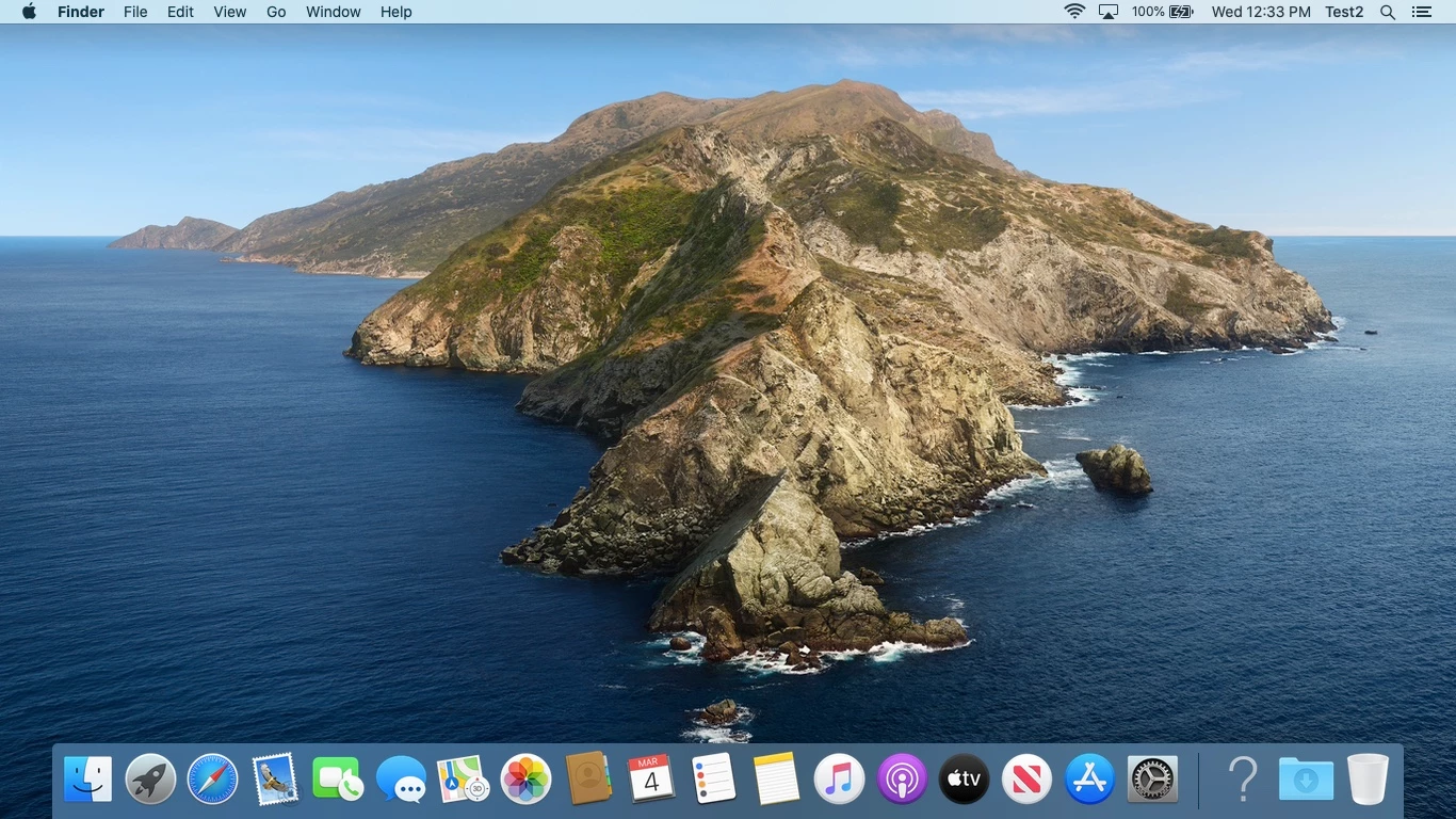

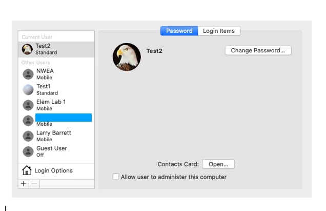

So, I setup two local accounts (I had to see it), set the dock via Self Service on Test1, restarted, logged into Test2 and the dock was different.

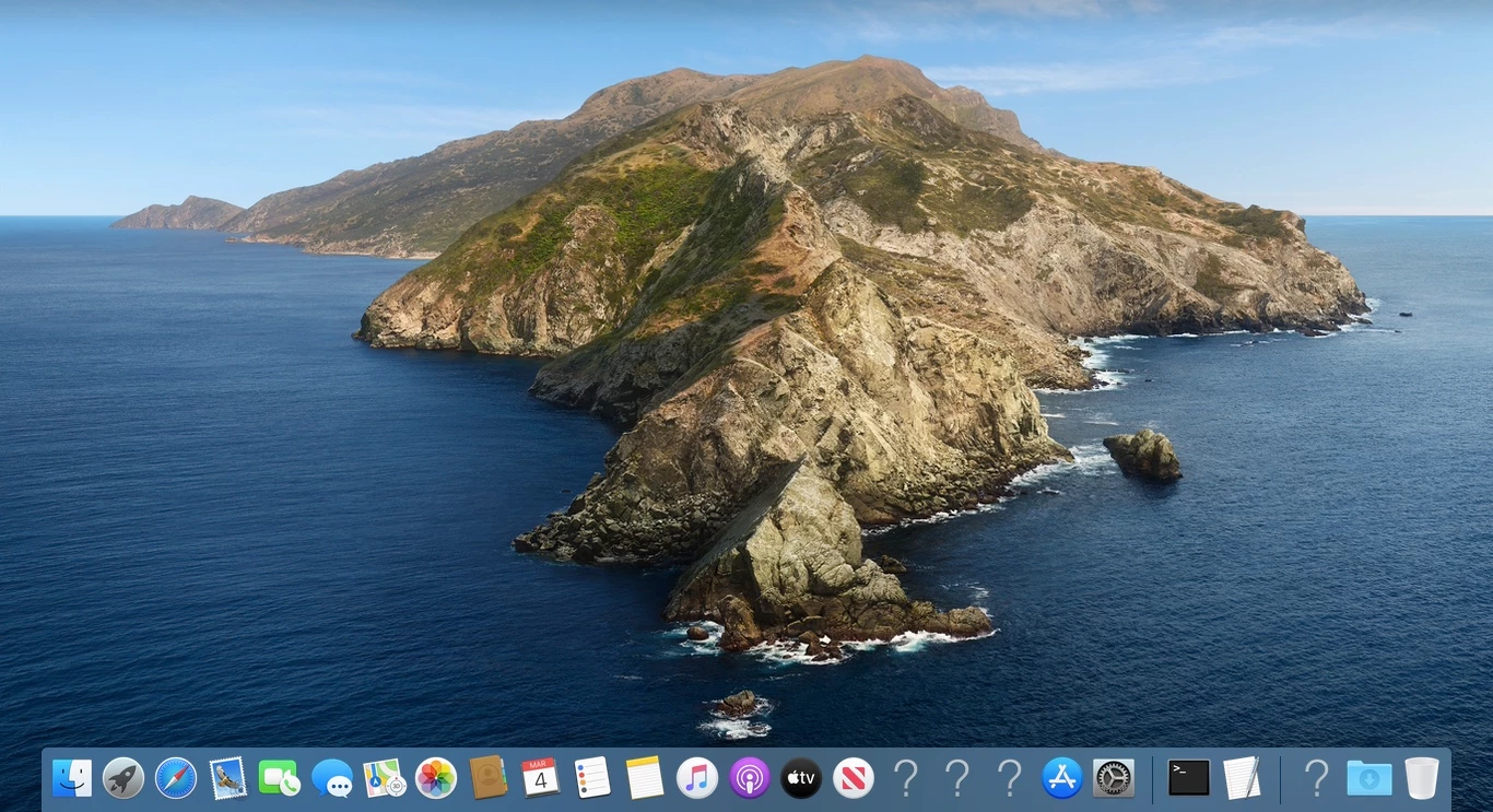

@larry_barrett I just tried it on Catalina and get the same result. User1 runs policy in Self Service and gets thew new Dock configuration. I logged in with User2 and his Dock also got changed.

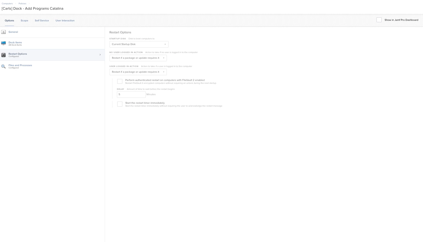

I'm running out of guesses over here. Can you post screenshots of your policy and the policy logs from the affected computer?
