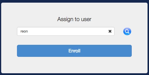

  • June 23, 2016
hello @mradams ,
any idea how does this assign to user function work?
I can't find any user from my user list and can't assign any user to the device
  • June 23, 2016
Are you using an LDAP server to pull your users? If not you may have to manually add your users first.
