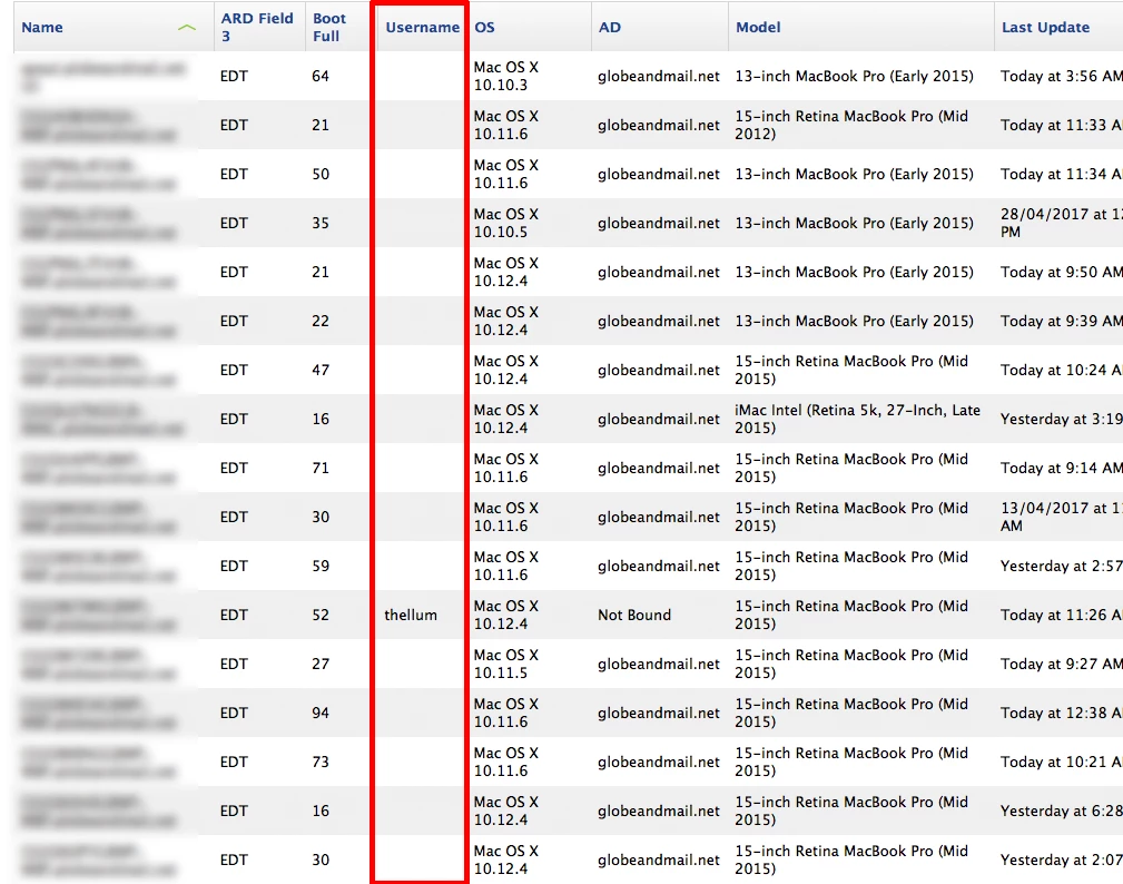

Good afternoon,
I wonder if anyone might shed light on why the JSS doesn't seem to be pulling username info for machines in a smart group search. Interesting to note that two admins of our instance do have their short names show, but all users do not. Peculiar.

To confirm: these are computers for which you have set (either via a script, API, or manually) an assigned username in the "User and Location" tab of the inventory record?
If so, do the usernames appear properly in that inventory tab (meaning, just a display issue in the report interface), or is the data actually disappearing from the computer record?

It does appear to just be just a display issue in JSS. If I follow through in the Inventory list for each machine, I do see full and short names for both user and my admin account.
Odd.

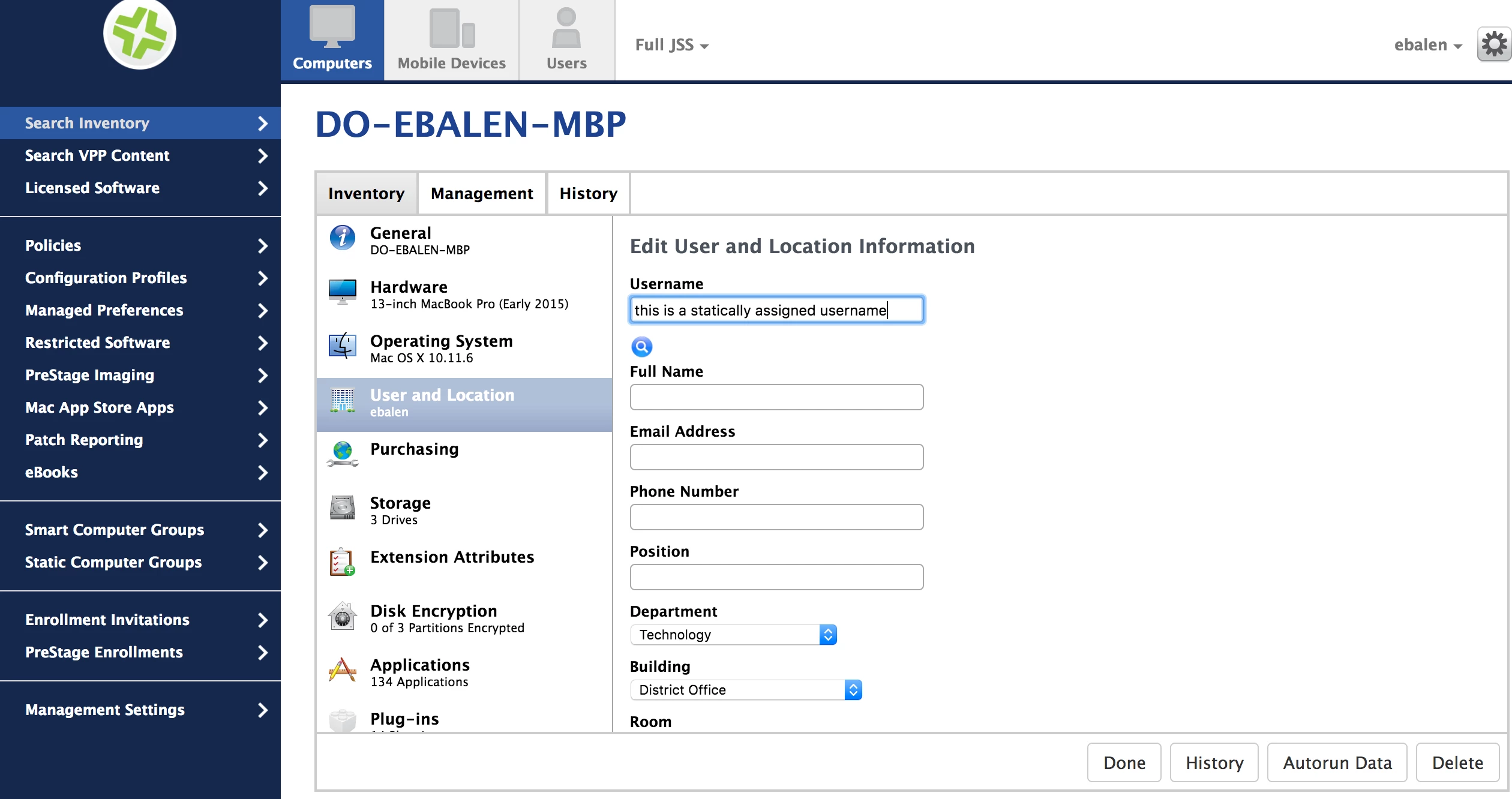

The username field in your search is displaying the username that has been explicitly set in the JSS under Inventory -> User and Location. The username field doesn't indicate any accounts that are locally present on the machine.

@nberanger You don't have to be connected to an LDAP server, although that is something you should do and it makes everything much easier. Here is where the setting to change the username is. It is statically assigned and doesn't populate automatically unless it is done by a script or during user-initiated enrollment.
