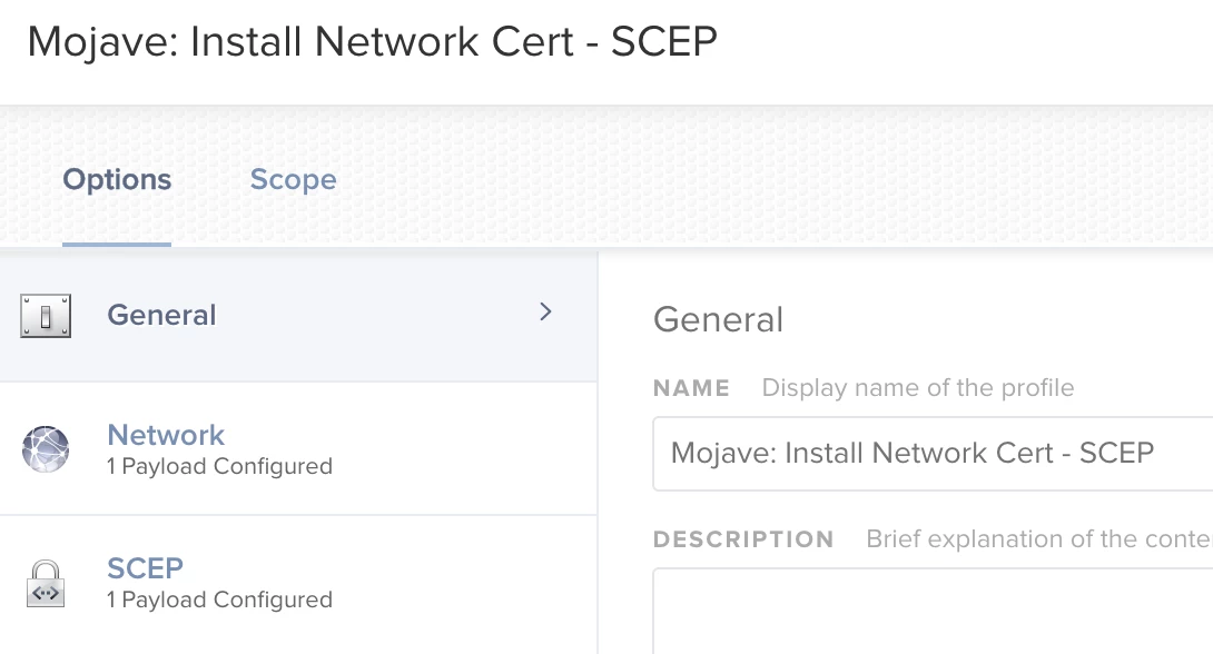

Here are some screenshots of our network and SCEP payloads.
We have a profile specific for the WiFi and associated cert.
There are only 2 payloads:

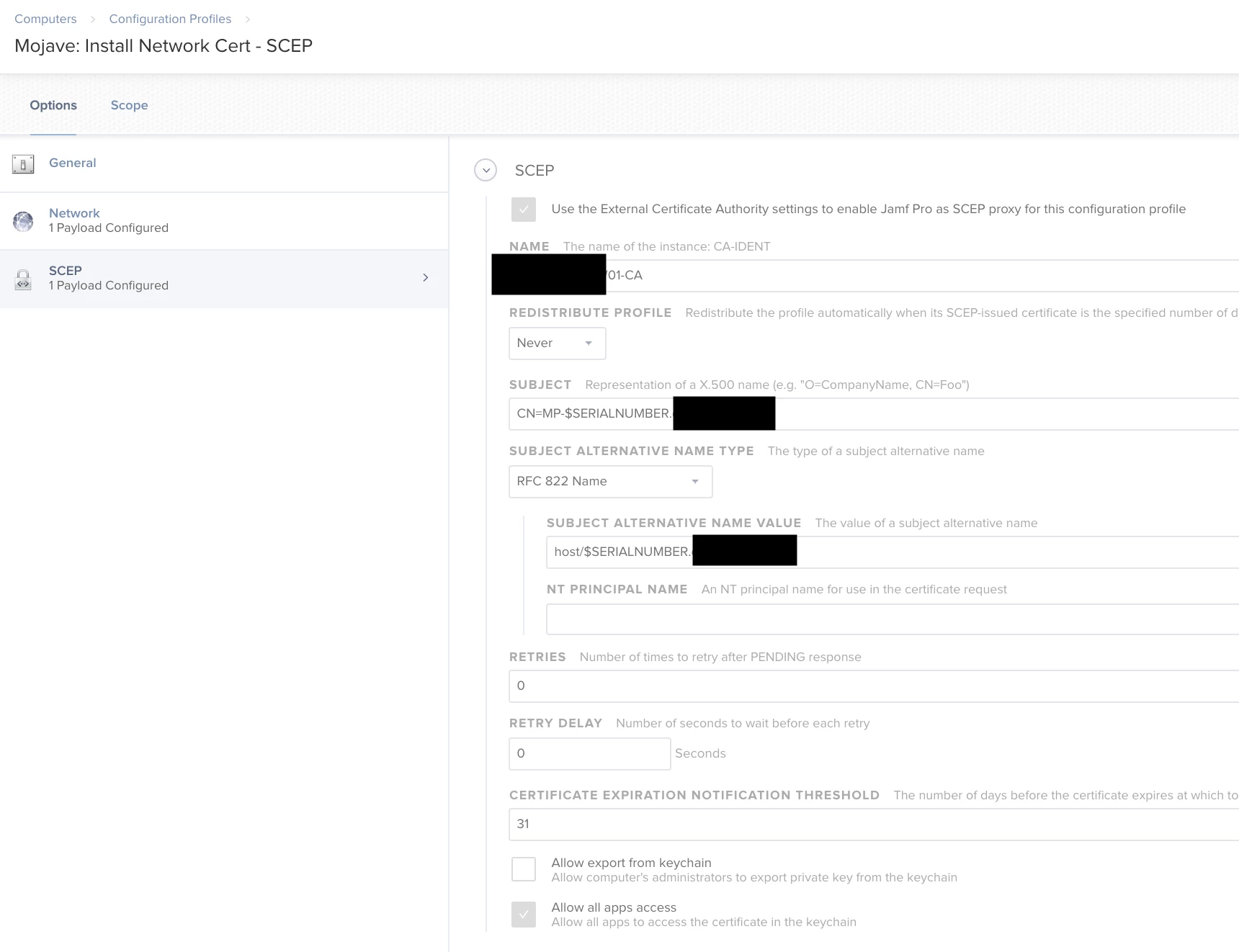

First create the SCEP payload. We have to use never reissue because it adds the profile ID to common name and our devices get rejected by the network controller. It's worth trying to get it working with renewal if possible.

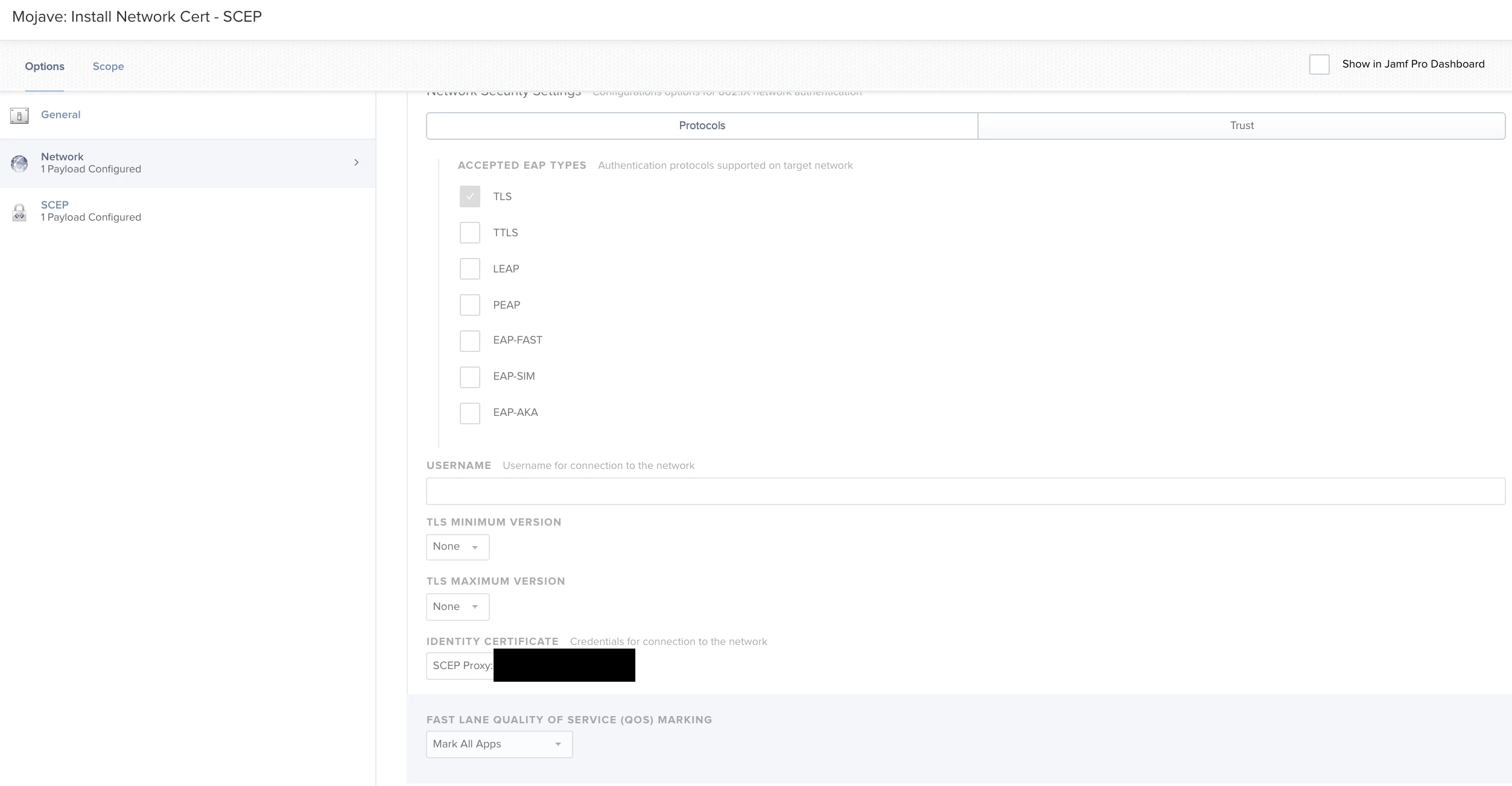

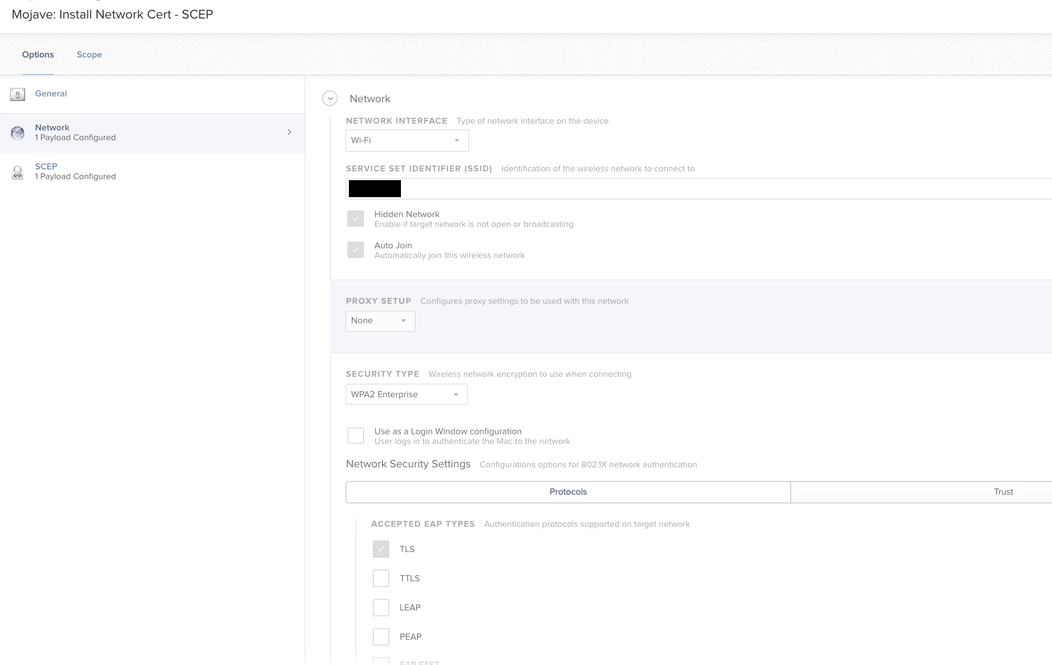

Then create the network payload
As seen in the final screenshot, the Identity Certificate is the SCEP cert defined within this profile.

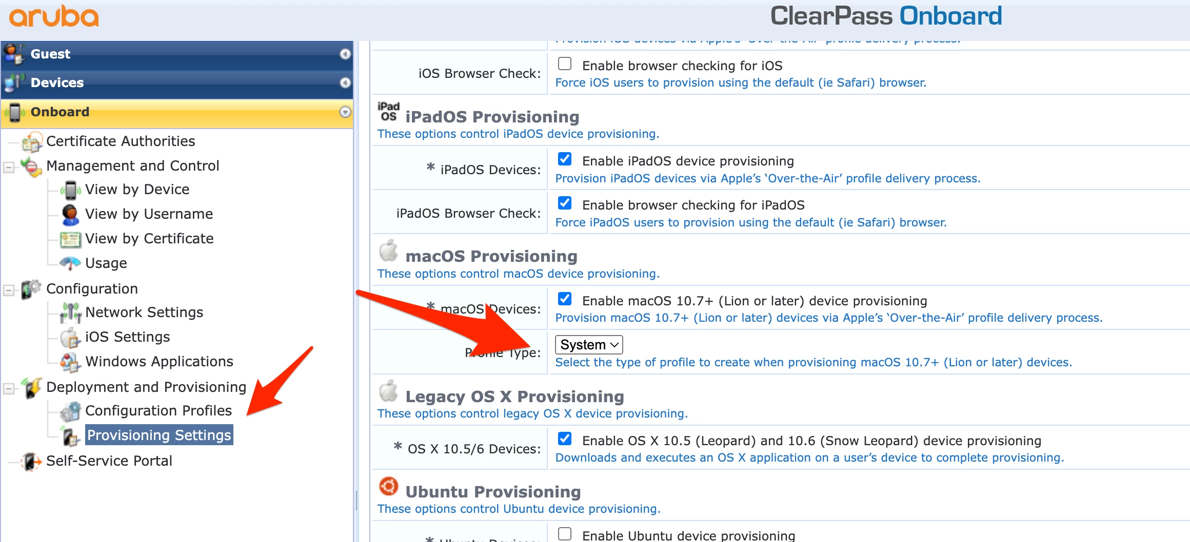

Hi Everyone,
We use Aruba brand Access Points in our WIFI network. 802.1x is used to connect to the network through these products and we include users in the network by verifying with a certificate. At this stage, identity and certificate verification is done with an application called ClearPass. The ClearPass application also serves as an MDM server and SCEP server. When we connect to Access Points, the ClearPass application sends a profile file to users via a web interface. Actually the whole solution is contained in this profile file settings. We changed the part specified as "user" in the settings of this configuration profile file, sent to MacOS devices by the ClearPass application, to "system". Thus, as soon as our MacOS device was turned on, the user was able to connect to the network automatically without logging in. If the application you use is ClearPass, I support this article with screenshots. You can use the screenshot below. After making this change, you need to delete and reinstall the WIFI profile on the macOS device. After this step, the problem disappears.
