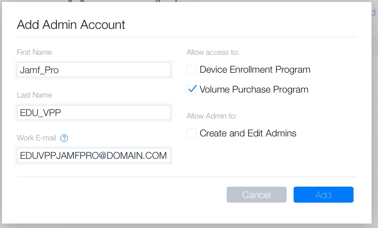

ericjboyd
  • May 20, 2017
First step is to create a new email alias and make sure it is not already in use as an Apple ID
second, in your deploy.apple.com console select the admins tab from the left nav bar.
Now click on the Add Admin Account link and fill out the email address and name fields. (I use an email address that describes where i will be using the token.)
Be sure to select the Allow Access to: Volume Purchase Program
That email address will get an email inviting them(whoever you pointed the alias to) to create an Apple ID.
Once this is done, now you can purchase apps, download this accounts token and add it to your MDM server.
