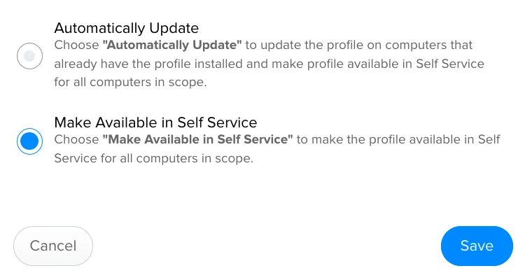

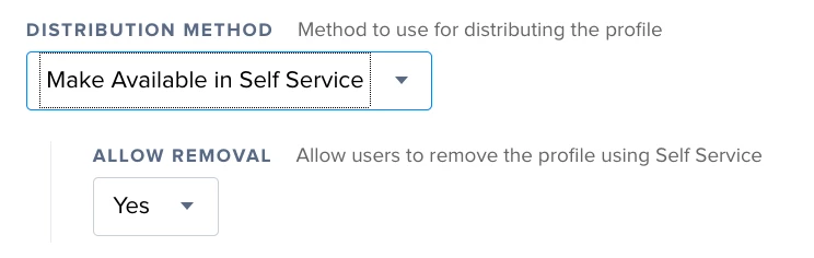

@Matt.Ellis As far as I know, you can't alter that setting after the fact, but, I think there's an easy fix here. Profiles can be both installed and removed using Self Service. Even if a profile was pushed automatically and silently to a Mac, if you go back in to the Config Profile itself and change it to "Make available in Self Service", there is a drop down that let's you choose if it can be uninstalled from Self Service as well.
Set that to Yes, then when saving, choose one of the options given. In the test I just ran, I chose "Make available in Self Service"
This profile was scoped and installed to my Mac (only), and sure enough, when I went back into Self Service, it showed up there with a "Remove" button, and I was able to uninstall it. Keep in mind that because I changed the profile to install via Self Service, it will not auto deploy again to my Mac, and the profile remains in Self Service after removing it, but the button changes to "Install" I don't know if that's what you had in mind, but if that's acceptable, then that is probably the best approach to allowing users to remove this profile.

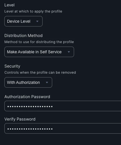

I need the same thing but for an iPad. Setting a profile to be removable for A Mobile Device config profile doesn't seem like a function, is there a way to replicate it?
FutureFacinLuke
Does this work on iPads?
I've set as follows but cannot remove it:
FutureFacinLuke

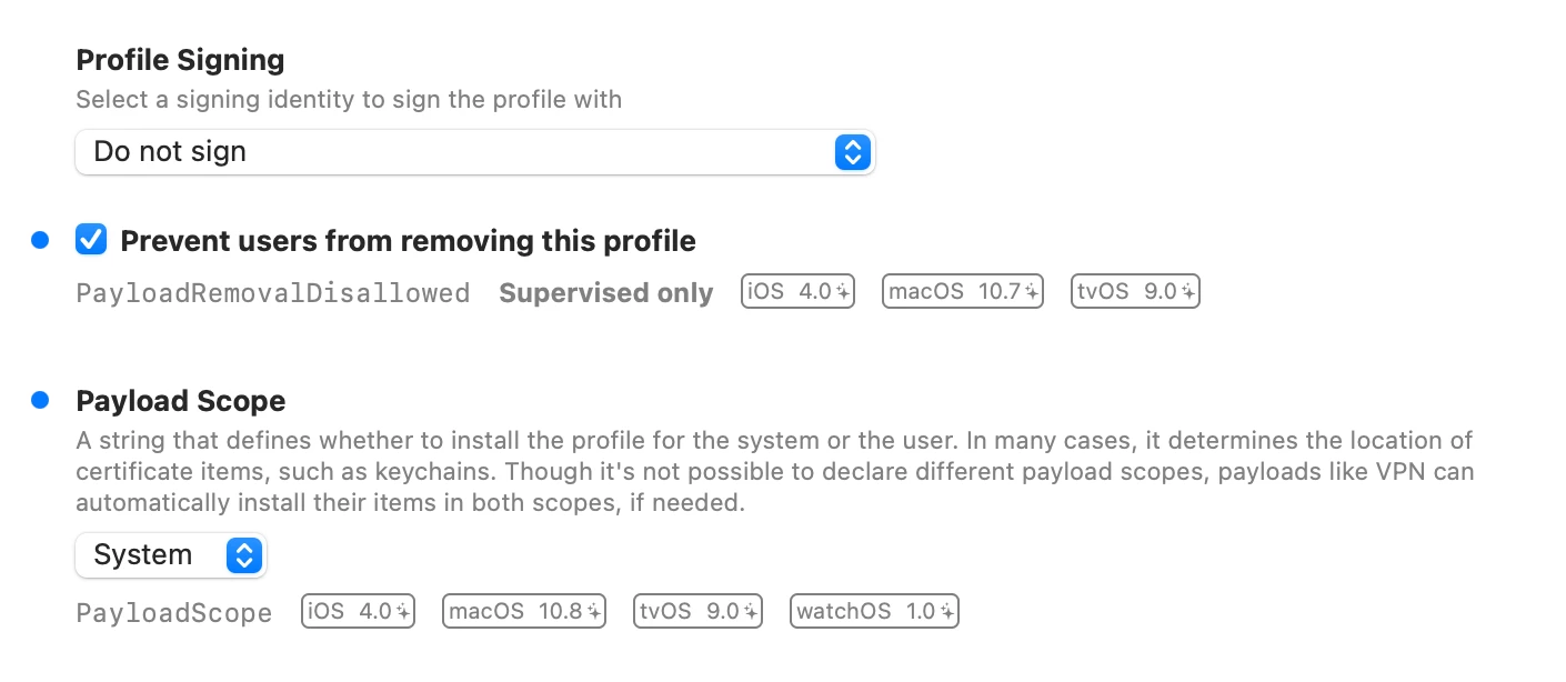

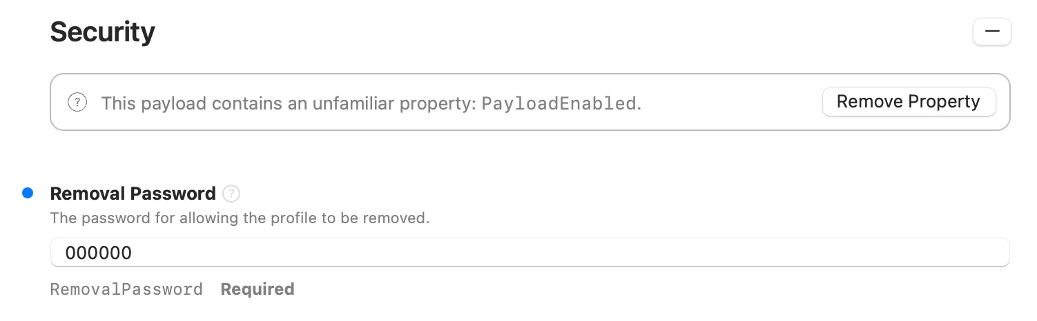

Inspecting the payload in iMazing I can see conflicting flags in General:
in Profile Removal:
It looks like Jamf is not setting the Removal Flag correctly.
