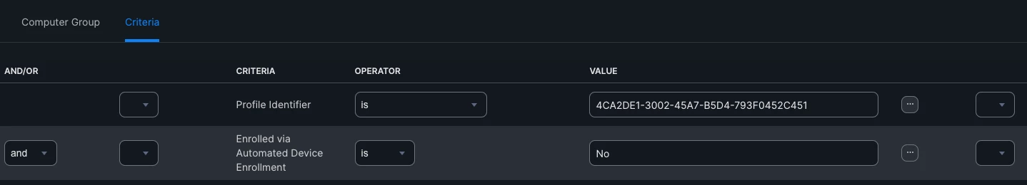

@BCPeteo You can always twik setup manager to utilise the same for User initiated enrollment, you need to modify your scope to only include devices which already have the profile installed, Please refer SetupManager image attached (don't forget to change the profile identifier value).

Thank you. the profile has been added to the PreStage, so the computer has it before Setup manager is launched (with enrollment complete trigger) Still no packages configured in Setup Manager install. We are using ADE so enrollment its device based not user initiated.
