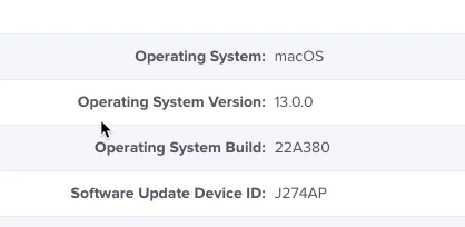

Running 10.42, has any one else testing Ventura seen a device entry revert to using OS version 13.0 instead of 13.0.0? This occurs at some random point after the device has done a successful recon to report as 13.0.0. A subsequent recon or inventory update corrects this version. I've only seen this so far on a device that went from 12.6.1 > 13.0.0 and have not yet seen it occur on a device that was setup in place from 13.0.0, but still fairly early in testing.

I've had it occur on both Intel and M1s so far, and neither from an RC juts from 12.6.1. I've a case open with support but wanted to see if others might be seeing similar. The real issue is that it breaks out smart groups for profile deployment when a devices shows as 13.0 instead of 13.0.0 so a number of config profiles remove and then need to be reapplied.

I've seen the OS version data alternating back and forth between 13.0 and 13.0.0 on the handful of machines that have updated to Ventura in my org so far. I posted about it on /r/jamf and got this explanation:
"Jamf Pro 10.42.0 includes Declarative Device Management. When the `jamf` binary submits inventory, it drops the trailing `.0`; when DDM sends an autonomous update, it sends the raw data, `13.0.0`."
So it seems that they need to update the jamf binary to no longer truncate that last ".0" so both means of updating machine info are reporting identically-formatted data.

Just thought I'd share some digging that I've done here. If you turn on debug on your server logging you'll see ddm status channel updates, like this one:
2022-10-31 20:06:54,624 [DEBUG] [ina-exec-35] [larativeManagementRequest] - Declarative Management check-in with endpoint status and data { "StatusItems" : { "management" : { "declarations" : { "activations" : [ { "active" : true, "identifier" : "scrubb3d", "valid" : "valid", "server-token" : "scrubb3d" } ], "configurations" : [ { "active" : true, "identifier" : "scrubb3d", "valid" : "valid", "server-token" : "scrubb3d" } ], "assets" : [ ], "management" : [ { "active" : false, "identifier" : "scrubb3d", "valid" : "valid", "server-token" : "scrubb3d" }, { "active" : false, "identifier" : "scrubb3d", "valid" : "valid", "server-token" : "scrubb3d" } ] }, "client-capabilities" : { "supported-versions" : [ "1.0.0" ], "supported-payloads" : { "declarations" : { "activations" : [ "com.apple.activation.simple" ], "assets" : [ ], "configurations" : [ "com.apple.configuration.legacy", "com.apple.configuration.legacy.interactive", "com.apple.configuration.management.status-subscriptions", "com.apple.configuration.management.test", "com.apple.configuration.passcode.settings" ], "management" : [ "com.apple.management.organization-info", "com.apple.management.properties", "com.apple.management.server-capabilities" ] }, "status-items" : [ "device.identifier.serial-number", "device.identifier.udid", "device.model.family", "device.model.identifier", "device.model.marketing-name", "device.operating-system.build-version", "device.operating-system.family", "device.operating-system.marketing-name", "device.operating-system.supplemental.build-version", "device.operating-system.supplemental.extra-version", "device.operating-system.version", "management.client-capabilities", "management.declarations", "test.array-value", "test.boolean-value", "test.dictionary-value", "test.error-value", "test.integer-value", "test.real-value", "test.string-value" ] }, "supported-features" : { } } }, "device" : { "operating-system" : { "version" : "13.0", "build-version" : "22A380" } } },
And if you run a recon locally, you'll see the following:
Locating hardware information (macOS 13.0.0)...
So it looks like ddm reports 13.0 and the Jamf management framework reports 13.0.0.
We're seeing the same behavior on computers running the 13.1 beta (flapping between 13.1 and 13.1.0).
