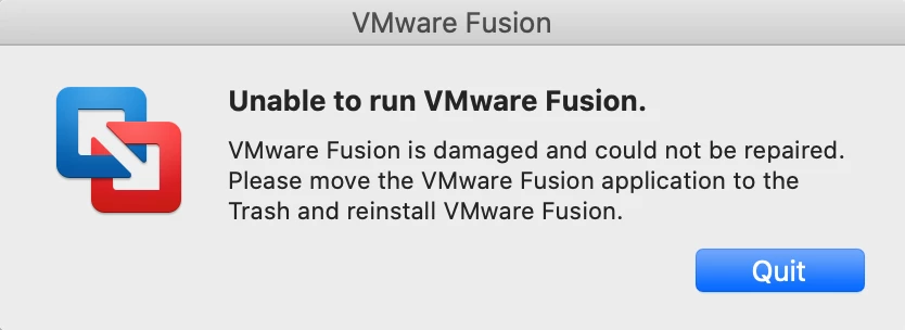

I have created VMware Fusion 11.5.1.pkg file by using Composer/Package tool. while I tried to install it in new Mac installed successfully when opening the VMware Fusion getting attached error. if I use the same package for upgrade the VMware fusion from older version to new version(11.5.1) it works.
Does anyone know how to do this?
Any help would be appreciated. Thank you

Hi,
I'm seeing this same thing - been packaging this for years without issue. They must have changed something!
I'm thinking about just deploying their DMG in a package with a postscript to mount and then open the installer? Curious how others may solve this...
  • Dec 19, 2019 5:51 PM UTC
You should be able to copy the VMware Fusion.app into /Applications without taking snapshots in Composer and then add the following command in a postinstall script:
/Applications/VMware Fusion.app/Contents/Library/Initialize VMware Fusion.tool set
  • Dec 19, 2019 6:39 PM UTC
@jhamil50 This did the trick! Thank you!
