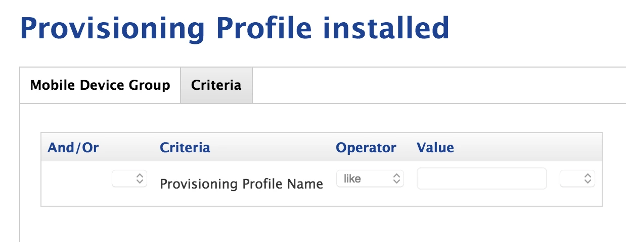

However, since there is no need for any of my students to have a Provisioning profile, my SG just reports on 'Provisioning Profile Name' LIKE "".

  • December 24, 2015
@lehmanp00
Thanks for your suggestion about the Smartgroup that would sense provision profiles.
What criteria did you use to set this SG up exactly? I'm having trouble finding anything other than "Provision Profile Name". Unless that's the one.
If you could share how you have it configured - that would be much appreciated!
cdenesha
  • December 28, 2015
@zsmith yes that is the one, and you leave the Value field blank.
