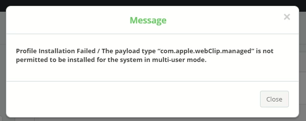

Hi all.. i see this post is really old, buta google search brought me here..
Anyone has been able to get an answer on this? i have joined JamfSchool to AAD and the activity log on the ipads reveals that the Install/Update of (AzureProfile) has errors; when checking i get the following: " Profile Installation Failed / The payload type “com.apple.webClip.managed” is not permitted to be installed for the system in multi-user mode."
This is a brand new, iOS 14.4 ipad
and unfortunately i can only log in with our main appleID instead of our M365 logins..
Many thanks.
V
  • Sep 7, 2022 11:32 PM UTC
I just ran into this issue in Jamf School.
We can not get Shared iPads managed in Jamf to accept Web Clips due to the error:
"Profile Installation Failed / The payload type “com.apple.webClip.managed” is not permitted to be installed for the system in multi-user mode."
If I tried a User profile to install a web clip on shared iPads it gives a warning saying
"The device is Device enrolled, while the profile is made for User enrolled devices"
One workaround I can think of is the teacher sends the link to pupils using Safari->Share->Air Drop then the pupil clicks Share->Add to Home Screen to make an App Icon on their home screen.  Although not sure that works as I am off site at the moment.
This is a frustrating problem.  Can't push webclips, can't set a Safari homepage...  How do you get a user pointed to the website they need on a shared iPad?
