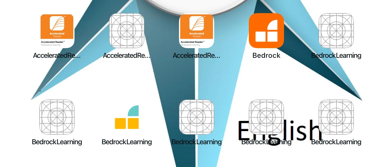

OK, Not sure whether to start a new thread but whilst I can now get webclips on to my ipads its seems there is something going wrong with the 'playing' I did before I realised that I blocked them!  I now have a homescreen covered in weird icons!  how do I get rid of them please!
If you had blocked them, I would expect them to not be shown. Those icons look like the placeholder icon if you do not have an icon chosen. You may just have multiple web clips made without icons and scoped to the device.

Thanks,
I created some webclips then deleted them as I thought that was wrong.  I created them again then found I was blocking them.  They then deployed to the home screen but in multiple versions (most with the placeholder icon).  I then deleted them again to try and fix it but when I reconfigured the webclips I get even more 'wrong' icons.  It seems to 'not forget' the old ones :-(  Any way I can stop it pulling the old ones through?
Hello there, is there a fix to the multiple place holder icons issue?
I am having the same problem after pushing webclips to iPads.
