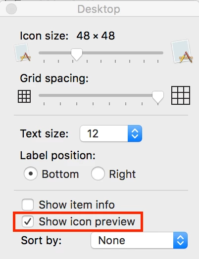

Also be aware that config profiles are not 100% reliable. As an example make a com.apple.finder.plist that unselects the Show Icon Preview checkbox.
Placing it in the User Template will work 100% of the time in unselecting the Show Icon Preview, however if you use the exact same plist and convert it to a config profile the Show Icon Preview checkbox is selected everytime.
Not good for Apple to recommend (i.e., force) config files if they are not 100% reliable.
