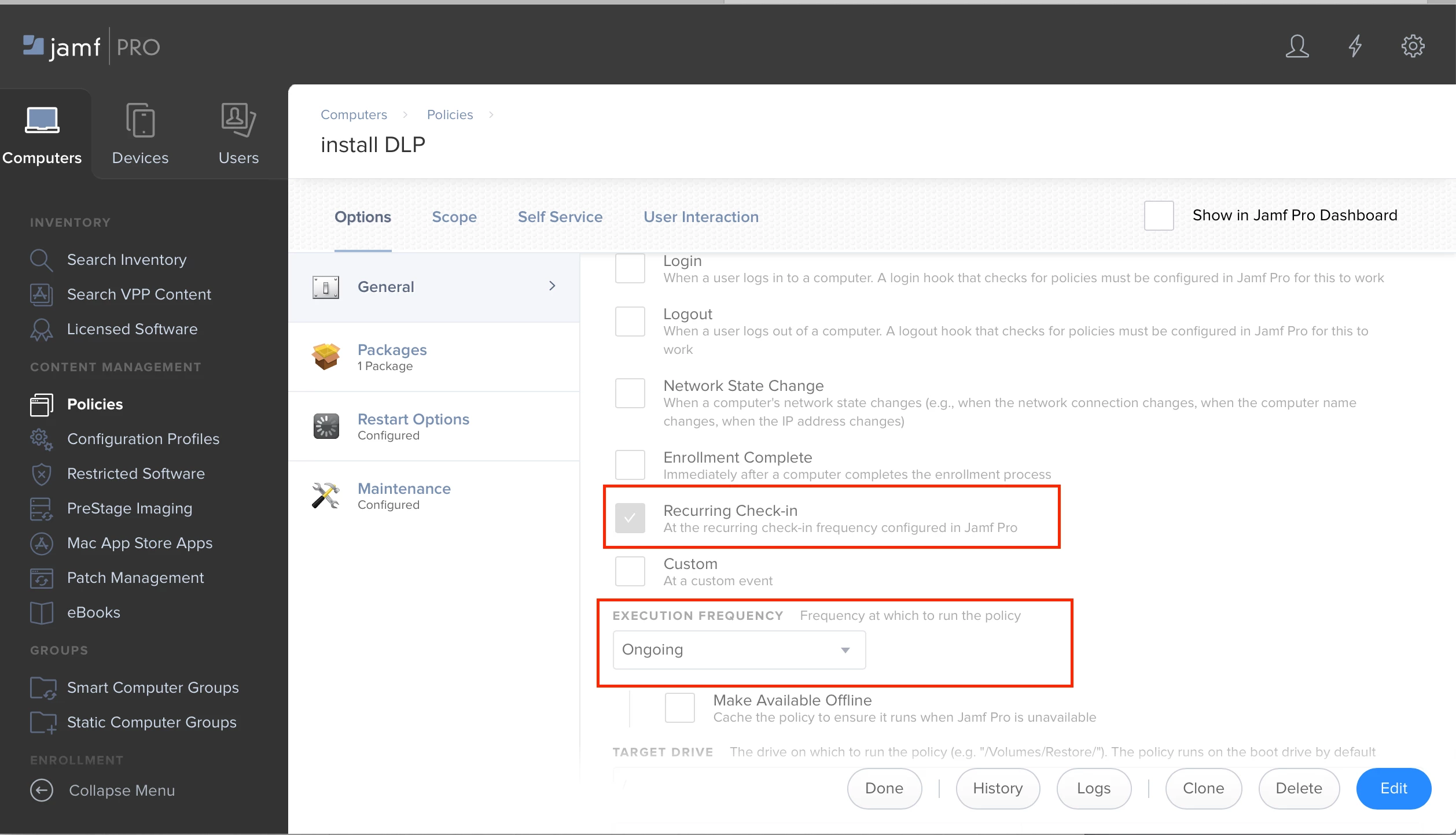

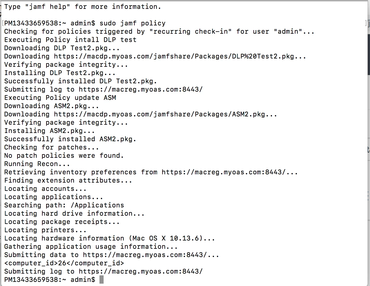

Everytime I run this code, following pkg installation will be started, which were already installed.
Best answer by BoscoATX
@shermanpan You would use Ongoing with Self Service policies with no Trigger. That way users can run it as many times as they want. Your current policy "install DLP" is running at every Check-in.
3 replies
  • October 30, 2018
Looks like your scoping for the Policies install DLP Test and Update ASM might be set to ongoing.
Try changing the execution frequency to once per computer.
  • October 30, 2018
When do I need to set ongoing?
  • November 5, 2018
