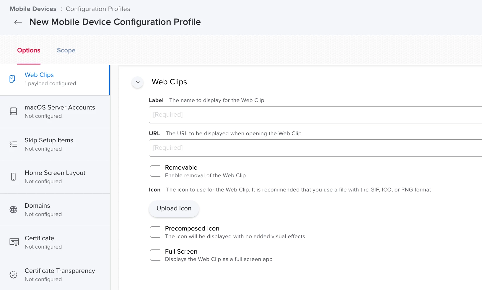

Would this work for you or are you trying to do something more complex?
andymason
  • Feb 17, 2022 8:19 PM UTC

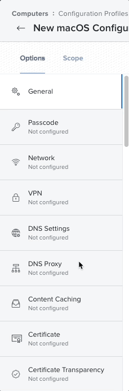

Yes that would work for me. I looked in configuration Profiles but don't see a built in option.
mgshepherd
  • Feb 17, 2022 8:23 PM UTC
I think you're looking down the list of config profiles for Computers and not Mobile Devices. Are you trying to get webclips pushed out to laptops/desktops or iOS devices.

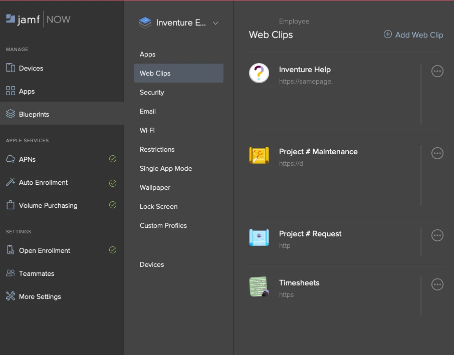

andymason
  • Feb 17, 2022 8:35 PM UTC
https://ideas.jamf.com/
Here it is in JamfNow. Super easy to use.
