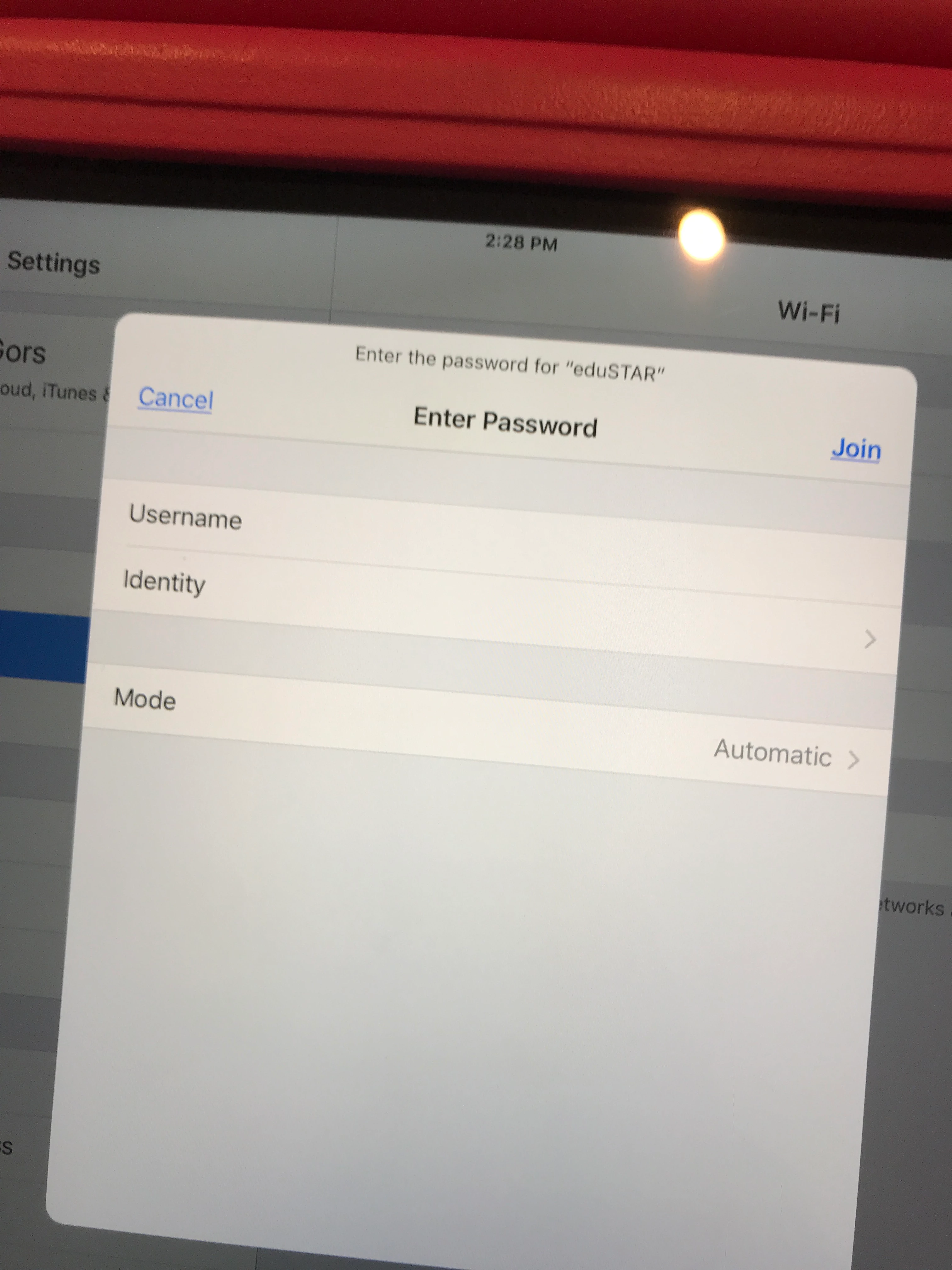

We have the same issue (also on "eduSTAR.net" running SHA-2), certificate based auth just stops working and brings up the logon prompt. Often just reconnecting to any network and poling the MDM resolves the issue but lately many iOS11 devices need the profile removed (excluded fro the scope) and then added back again.
We reduced the incidence with iOS 9 & 10 by adding two identical Wi-Fi profiles. So far in iOS11 this hasn't helped.
