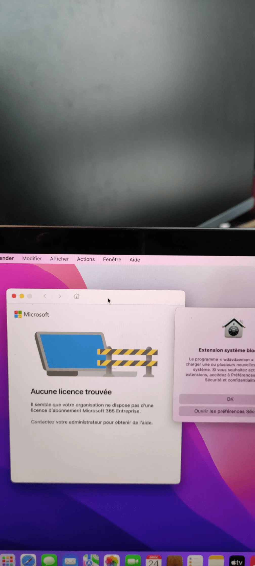

We are currently in the process of changing our antivirus software and deploying defender 365 on every mac in the office.
The problem is that randomly on some macs there is a message that says: no licence found
If anyone knows the solution or has experienced this type of problem.

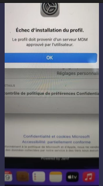

Yes i scoping the config profile for defender for all computers, i think i find the problem. It's because the config profile are not installed on some macs but when i try to install manually by download the config profile on a mac, i have this error too.
"The profile must originate from a user approved MDM server"
Yes, that is the issue. I would upload the profile to Jamf, which will sign it, and deploy it when scoped.
I'd walk through #1 and #2 again here:
https://learn.microsoft.com/en-us/microsoft-365/security/defender-endpoint/mac-jamfpro-policies?source=recommendations&view=o365-worldwide

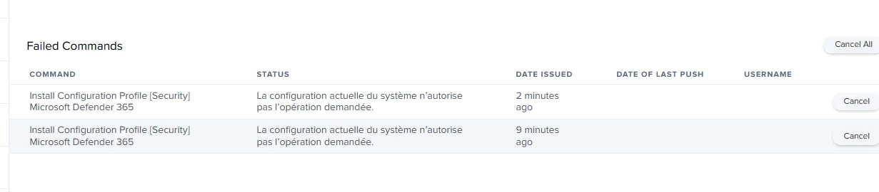

And when i look at jamf i have this, on a testing computer with no config profile install. I try your solution but it is the same thing.
"The current system configuration does not allow the requested operation"
I don't know why the configuration profile does not want to install.
