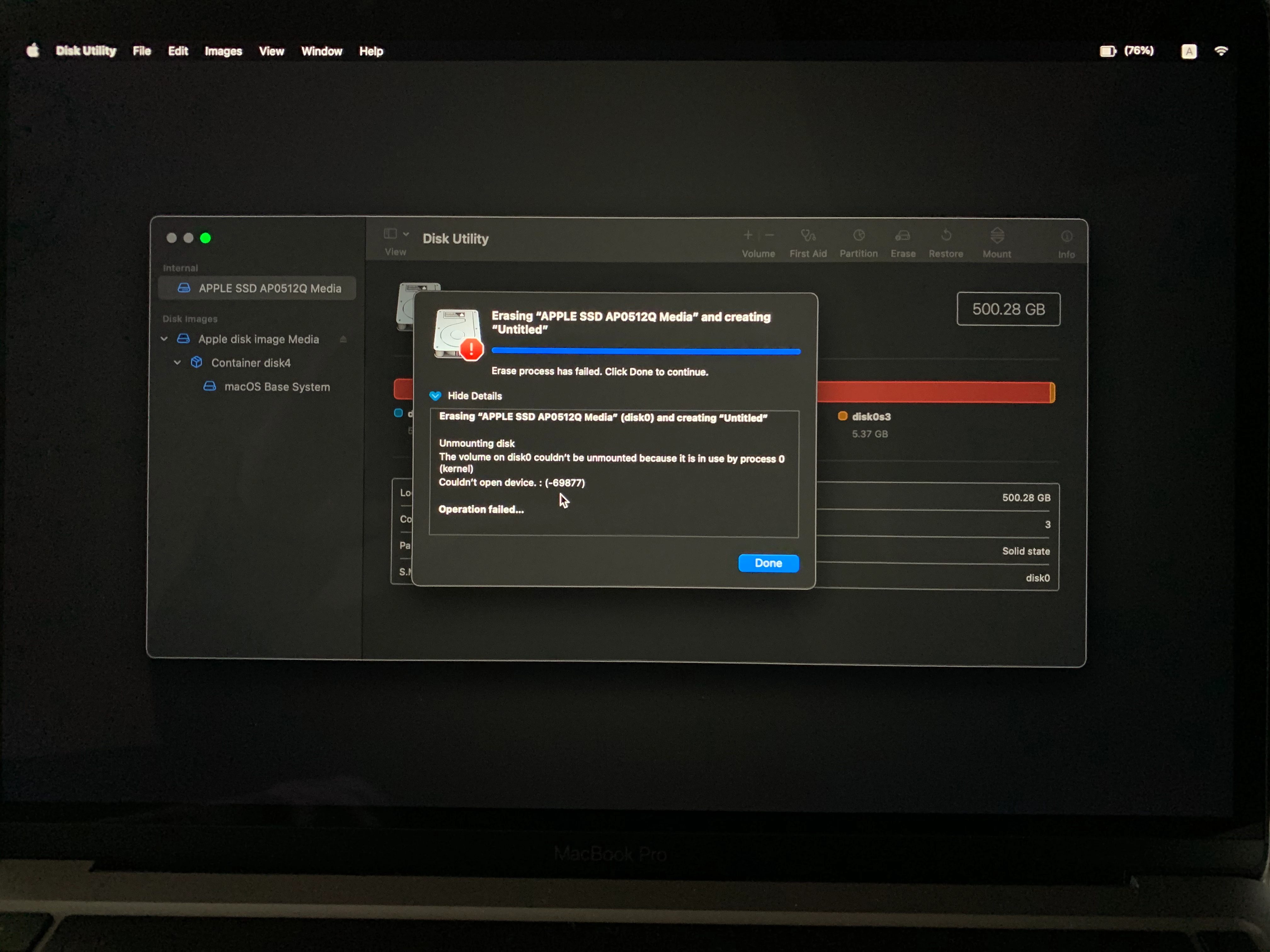

The problem I'm currently struggling with, is that when you perform a wipe on the device initiated by Jamf is that you can't install new clean system again.
After the wipe has been done, I boot from recovery mode to start a clean install.
First you have to open disk utility to erase the SSD and create a volume to install on. But then I get the following attached error message.
Did anyone else test this also and are you having the same issue?
The only option to get the Mac working now, is by attaching it to another Mac and revive it with Apple Configurator 2.

Hi all,
Yes I understand.
But if you send the Wipe commando trough Jamf, you don't have the container and volume anymore.
So my problem is still there, I can't wipe the "SSD" in the screenshot to create a volume on.
Then I get the error message as you can see in the screenshot.
I have also tried the way by using the reset password command pchrichard, ends up in the same issue :(.

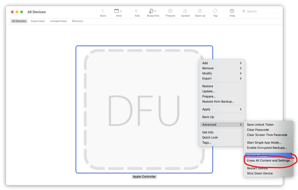

Use the DFU mode and Apple Configurator 2 via TB/USB cable then select Erase all contents
It only take 10 mins to wipe and full OS and recovery to install (revive will only restore recovery firmware)
M1 acts more like an iPhone now
