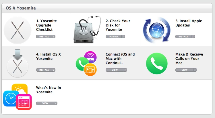

Will the end users be initiating the upgrade or will they bring them in to support? We provide the Yosemite upgrade through Self Service and direct our users there to get the upgrade. We have a Yosemite category and step our users through the process. We provide an upgrade checklist, a PDF on how to check the disk before upgrading, a link to install Apple updates, the Yosemite installer, and then some policies that open Apple's pages on what's new in Yosemite and how to use some of the new features like Continuity. It looks like this:

Hi @mtaylor934,

Yep, the policies can be done in any order. We don't require the user to backup their files first, but they are instructed to in the checklist and in the Self Service description for the Install OS X Yosemite policy.
Here's a breakdown of the policies:
Yosemite checklist - installs the checklist PDF to the desktop and opens the file in the users default PDF viewer using an "open" command in the policy.
Check Your Disk - basically the same policy as the checklist but it installs a different PDF and opens it.
Install Apple Updates - Opens Software Update (App Store) for the user and then they install the updates from there. You could use the policy itself to install the updates but I like the visual reinforcement for the user that Software Update/App Store is where they should expect to go to see and install updates.
Install Yosemite - Copies and installs the Install OS X Yosemite.InstallESD.dmg (that gets created when you drag the Install Yosemite.app into Casper Admin) and then restarts to the OS X Installer startup disk.
Connect iOS and Mac with Continuity - Opens https://support.apple.com/en-us/HT6337 in the user's default browser.
Make and Receive Calls on Your Mac - Opens https://support.apple.com/kb/PH18756?viewlocale=en_US&locale=en_US in the user's default browser.
What's New in Yosemite - Opens http://help.apple.com/osx/mac/10.10/whats-new/mavericks in the user's default browser.
As for packaging the installer, yes, I used the installer app from the App Store and followed the steps in the JAMF PDF for Deploying OS X (http://resources.jamfsoftware.com/archive/Deploying-OS-X-v10.7-or-Later-with-the-Casper-Suite.pdf) except for the policy to cache the installer. The process in the PDF is simple enough and it works so it meets my two "let's move forward" criteria. lol
