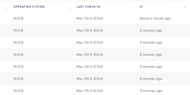

Hi jamf nation,
Hopefully anyone know that problem.
I have updated our jamf pro on-prem from 10.8 to 10.11.1 today.
For sure, I did the incremental update steps provided by jamf. (update db to InnoDB, upgrading to 10.10 and after that to 10.11.1)
Now tables are not correct anymore:

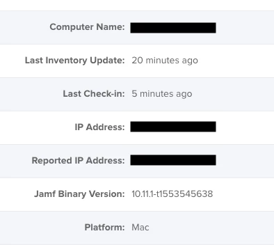

But if i take a look into the details of a host it is correct:
Also the OS entries are correct.

Best answer by jconte
The one thing different between our 2 mac's were that I was using Operating System in my display and she was using OS Version every column after that was off for me. Once I switched from Operating System to Operating System Version everything went back to normal.
We are also on-prem and it happened after our upgrade from 10.9 to 10.11.1.

I had the same problem and I asked a colleague of mine to see if the same thing happened for her, she didn't have the issue. I had to go into my inventory display and edit it to remove from the first column that was inaccurate, then it worked.
jconte
  • April 23, 2019
  • April 24, 2019
Hi @jconte,
Amazing, you are right. Changed from OS to OS Version and now the columns after that are correct.
Quite strange, jamf should take a look at that :)

@jconte
Thank you. We just upgraded yesterday from 10.9 to 10.11. I noticed the incorrect views in the tables. I changed the OS to OS Version and it worked.
