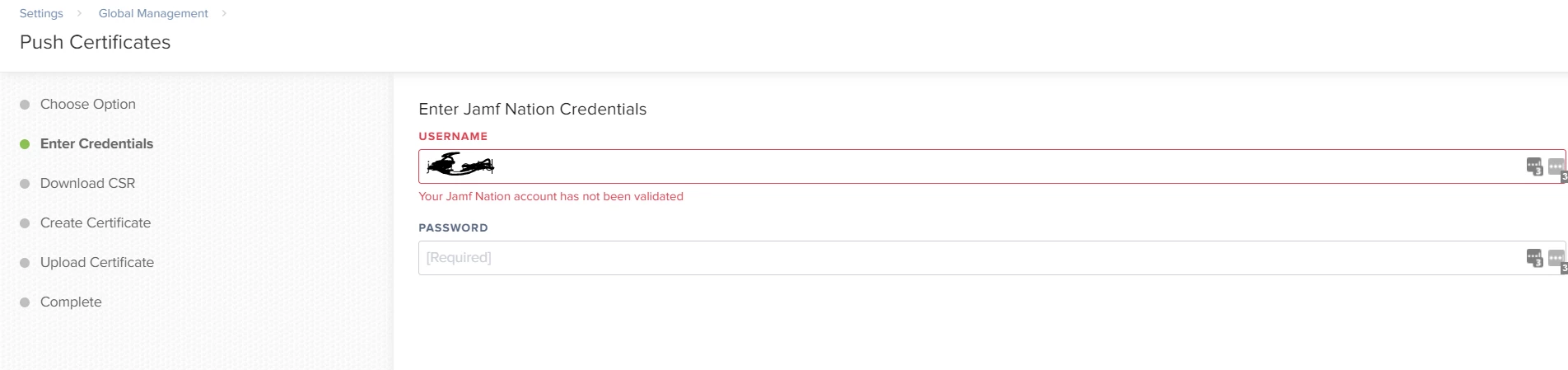

  • February 12, 2020
I am having the same issue when I go download a push certificate from Jamf Nation. See attached file.
Anyone has fixed for this issue?
