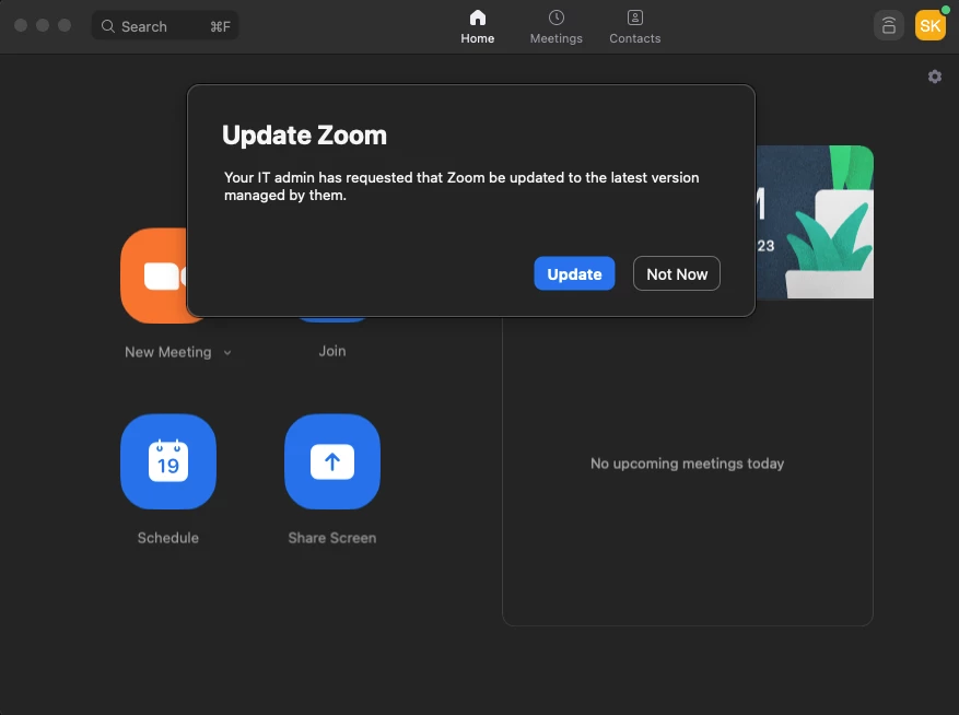

Hi Did any one use zoom schema as configuration profile. I just create that and deploy to a test machine but following window pop up when policy pushed and zoom app is running
I use schema from here: https://github.com/talkingmoose/jamf-manifests/blob/master/Zoom%20(us.zoom.config).json and configure some instances and leave null others. And then I create a policy to deploy latest zoom to endpoint. But after deploy the policy if user click "Not Now" then policy will failed. The workaround I found that if Kill the process before run policy then that window will not pop up again. Did anyone face same issue? Any suggestion will helpful

Which version of Zoom are you deploying?
Some of the options on the manifest might need updated.
You can find the new ones here: https://support.zoom.us/hc/en-us/articles/10365151862285

Thanks everyone. I think I figure out and able to fix the issue. i use the schema this one: https://github.com/Jamf-Custom-Profile-Schemas/ProfileManifestsMirror/blob/main/manifests/ManagedPreferencesApplications/us.zoom.config.json
And that create a policy with ZoomInstallerIT.pkg. That resolve the issue.

My previous one can be mark as solution.
1. Download latest zoomInstallerIT.pkg from Zoom website for corporate deployment
2. Upload schema from here: https://github.com/Jamf-Custom-Profile-Schemas/ProfileManifestsMirror/blob/main/manifests/ManagedPreferencesApplications/us.zoom.config.json
3. Configure only those which you want to manage and all other you need to deselct from Add/Properties.
That should resolve thge issue.
