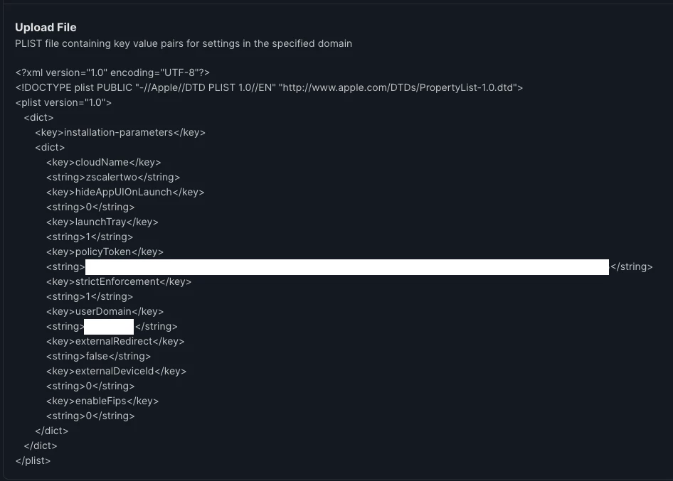

This is the configuration I have as directed by Zscaler which does not populate the cloudName

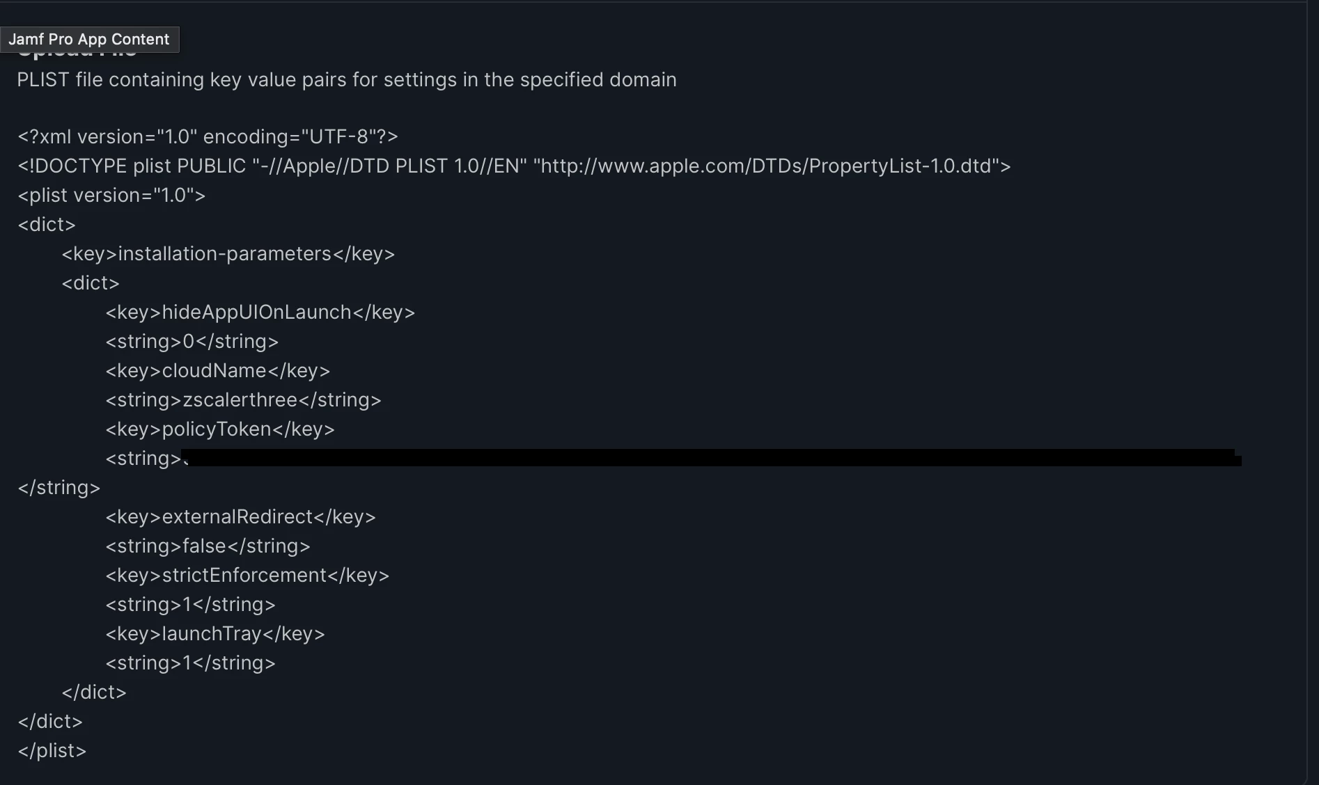

Let's remove userDomain and check it. Below is my configurations profile.
Also check enableFips is required or not.
