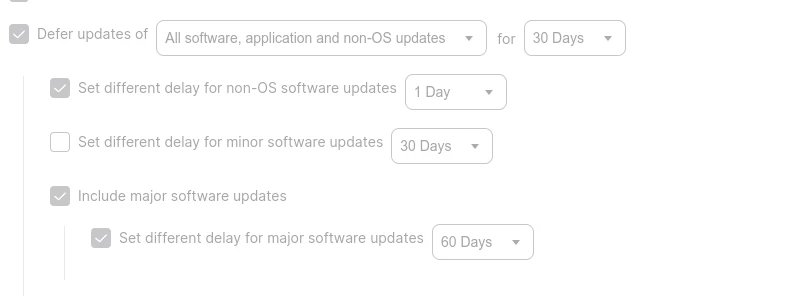

A configuration profile that will defer the upgrade for up to 90 days is what you will need. You can also block the macOS Sequoia installer using Restricted Software. This upgrade will primarily be delivered by Apple through Software Update. Restricted Software won't block that since it's not launching the macOS install app. What I noticed last year was that the macOS install app was downloading on some Macs and then when users tried to upgrade through Software Update, the install app would launch. Non-admin users could not run the install app, but if the process ran entirely through Software Update without launching the app, they could get upgraded.
iOllie
  • September 10, 2024
@howie_isaacks
I’ve already deployed a configuration profile to defer updates for 90 days. However, last year I noticed that a significant number of managed Macs were upgraded unexpectedly, likely due to Delta updates.
Given that most devices are now on version 14.8.1, what would be the best way to resolve the issue of Delta upgrades, especially to ensure stricter control over future updates?

What I found out last year is that some software updates coming from Apple don't advertise themselves as either minor or major updates. As a result, some of my Macs were able to perform updates that we were not yet ready to allow in production. This JSON that I received from Jamf may help you. I used it to create a profile for minor macOS update deferrals and another for major macOS upgrades. The built-in profile payload for delaying updates isn't as granular as I needed. I don't like delaying macOS minor updates for more than 21 days but I don't get to make that decision. I definitely delay major upgrades for the maximum 90 days that Apple allows to ensure we don't have a lot of upgrades being done and then a lot of users with problems we have to fix.
{ "title": "com.apple.applicationaccess", "description": "Preference Domain: com.apple.applicationaccess, Application: macOS Restrictions", "__version": "10.15", "__feedback": "mitchelsblake@gmail.com", "type": "object", "options": { "remove_empty_properties": true }, "properties": { "forceDelayedSoftwareUpdates": { "title": "Defer Apple Software Updates", "description": " Supervised only. If set to true, delays user visibility of Software Updates. On macOS, seed build updates will be allowed, without delay", "propertyOrder": 10, "anyOf": [ { "title": "Not Configured", "type": "null" }, { "title": "Configured", "type": "boolean", "default": false, "options": { "infoText": "Key: forceDelayedSoftwareUpdates" } } ] }, "enforcedSoftwareUpdateDelay": { "title": " Software Update Deferral length (in days)", "description": "Supervised only. This restriction allows the admin to set how many days a software update on the device will be delayed. With this restriction in place, the user will not see a software update until the specified number of days after the software update release date.", "propertyOrder": 20, "anyOf": [ { "title": "Not Configured", "type": "null" }, { "title": "Configured", "type": "integer", "minimum": 0, "maximum": 90, "default": 30, "options": { "infoText": "Key: enforcedSoftwareUpdateDelay" } } ] }, "forceDelayedAppSoftwareUpdates": { "title": "Defer Non-OS Software Updates", "description": " Supervised only - macOS 11 or later. If true, delays user visibility of non-OS Software Updates. Visibility of Operating System updates is controlled through forceDelayedSoftwareUpdates. The delay is 30 days unless enforcedSoftwareUpdateDelay is set to another value.", "propertyOrder": 30, "anyOf": [ { "title": "Not Configured", "type": "null" }, { "title": "Configured", "type": "boolean", "default": false, "options": { "infoText": "Key: forceDelayedAppSoftwareUpdates" } } ] }, "enforcedSoftwareUpdateNonOSDeferredInstallDelay": { "title": "Non OS Update Deferral length (in days)", "description": "Supervised only. macOS 11.3 and later. This restriction allows the admin to set how many days to delay an app software update on the device. When this restriction is in place the user sees a non-OS software update only after the specified delay after the release of the software. This value controls the delay for forceDelayedAppSoftwareUpdates.", "propertyOrder": 40, "anyOf": [ { "title": "Not Configured", "type": "null" }, { "title": "Configured", "type": "integer", "minimum": 0, "maximum": 90, "default": 30, "options": { "infoText": "Key: enforcedSoftwareUpdateNonOSDeferredInstallDelay" } } ] }, "enforcedSoftwareUpdateMinorOSDeferredInstallDelay": { "title": "Minor OS Update Deferral length (in days)", "description": "Supervised only. macOS 11.3 and later. This restriction allows the admin to set how many days to delay a minor OS software update on the device. When this restriction is in place the user see a software update only after the specified delay after the release of the software update. This value controls the delay for forceDelayedSoftwareUpdates.", "propertyOrder": 50, "anyOf": [ { "title": "Not Configured", "type": "null" }, { "title": "Configured", "type": "integer", "minimum": 0, "maximum": 90, "default": 30, "options": { "infoText": "Key: enforcedSoftwareUpdateMinorOSDeferredInstallDelay" } } ] }, "forceDelayedMajorSoftwareUpdates": { "title": "Defer Major Software Updates", "description": "If set to true, delays user visibility of major OS Software Updates.", "propertyOrder": 60, "anyOf": [ { "title": "Not Configured", "type": "null" }, { "title": "Configured", "type": "boolean", "default": false, "options": { "infoText": "Key: forceDelayedMajorSoftwareUpdates" } } ] }, "enforcedSoftwareUpdateMajorOSDeferredInstallDelay": { "title": "Major OS UpdateDeferral length (in days)", "description": "Supervised only. macOS 11.3 and later. This restriction allows the admin to set how many days to delay a major software update on the device. When this restriction is in place the user sees a software update only after the specified delay after the release of the software update. This value controls the delay for forceDelayedMajorSoftwareUpdates.", "propertyOrder": 70, "anyOf": [ { "title": "Not Configured", "type": "null" }, { "title": "Configured", "type": "integer", "minimum": 0, "maximum": 90, "default": 30, "options": { "infoText": "Key: enforcedSoftwareUpdateMajorOSDeferredInstallDelay" } } ] } } }

Use the JSON that I shared above in a profile. Place the JSON in the Application & Custom Settings payload, External Applications. The preference domain is com.apple.applicationaccess. You can use the form editor to choose your settings.

 I've tried using your profile or default functional restrictions in jamf and at first everything seems fine and after a few reboots my test macbooks start offering to download macOS Sequoia 15.0.1 under System Update. The same goes for the rest of the users in our organization. It seems that they do not show a message with an offer to download a new OS, and by going to "System Update" the user can download and install the latest update.
