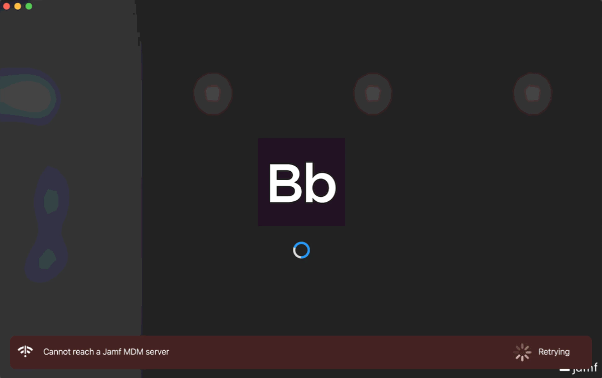

Self Service - Cannot reach a Jamf MDM server
  • January 6, 2022
  • 23 replies
  • 729 views
The last post I can find relating to this is from 2017; There isn't a solution there and I've tried almost everything previously listed.
We've been using JAMF for a few years mostly without issue - this is the first time we're seeing this error. There's a similar error "connecting to jamf server" which can be resolved by simply uninstalling and allowing JAMF to reinstall Self Service. No luck on this one. also tested:
computer restart, trying from an IT account (removes any variables from the users startup items), refreshing the MDM, clean uninstall and reinstall of the JAMF Framework.
I did find the list of ports, but we aren't seeing any blocked ports (on machine, router, or via ISP). Issue is present both on and off VPN (so that is irrelevant).
Currently this is only affecting the one machine but as I don't have a fix there's trouble if it spreads. The Mac still has access to jamf controls via terminal, still receiving profiles and policies, still reporting in all information to the server... Self Service appears to be the only thing affected.
If anyone has any idea what this could be I'm open to further troubleshooting.

@mdaymude Self service relies on /Library/Preferences/com.jamfsoftware.jamf.plist to show the correct server address, run
/usr/bin/defaults read /Library/Preferences/com.jamfsoftware.jamf jss_url
 to see if the url is correct.

Hey @mdaymude I just tested on my test machine and got the same error as your screen shot by changing the url, was able to run
/usr/bin/defaults write /Library/Preferences/com.jamfsoftware.jamf jss_url (JamfSERVER)
to fix it replacing (JamfSERVER) with our production server.

On that computer in terminal, what do you get when running: jamf checkJSSConnection
  • January 7, 2022
"Checking availability of (site)...
The JSS is available."
...this is why it's so confusing to me. I'm not seeing any possible cause and everything else is working correctly.
