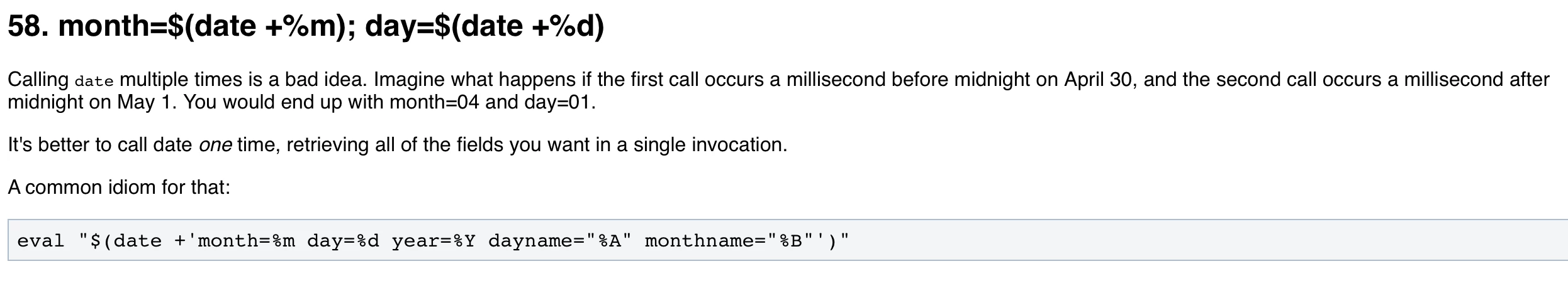

But, there is a problem crystallized is this nugget of wisdom from Bash Pitfalls
So, what to do, what to do?
I think, perhaps, this:
eval "$(/bin/date +'century="%C" year_00_Mon="%g" year_00_Sun="%y" year_Mon="%G" year_Sun="%Y" month_01="%m" month_abrv="%b" month_full="%B" week_00_Mon="%W" week_00_Sun="%U" week_01_Mon="%V" weekday_0_Sun="%w" weekday_1_Mon="%u" day_001="%j" day_01="%d" day_1="%e" day_abrv="%a" day_full="%A" hour_00="%H" hour_01="%I" hour_0="%k" hour_1="%l" minute_00="%M" second_00="%S" second_epoch="%s" ampm="%p" timezone_alpha="%Z" timezone_utc="%z"')"
Using the Bash Pitfalls idiom for ensuring the date command is only called once my version creates human-readable bash variables for all of the separate components that can make up a date string using the formats available in strftime. If I were being fancy I would maybe call it a "library" of possible options that you might want to include in a date string in your script. It's modular! I have intentionally excluded the strftime options that create combined strings like "%F", "%D", "%X".
