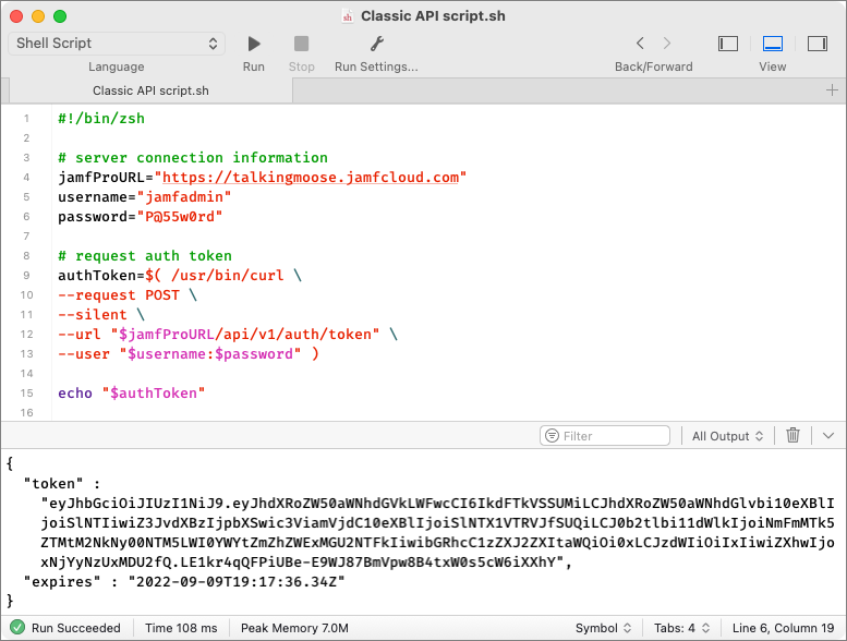

What we need to do next is use our credentials to request a token from the Jamf Pro server. Paste this after the server and credential information above:
# request auth token authToken=$( /usr/bin/curl \\ --request POST \\ --silent \\ --url "$jamfProURL/api/v1/auth/token" \\ --user "$username:$password" ) echo "$authToken"

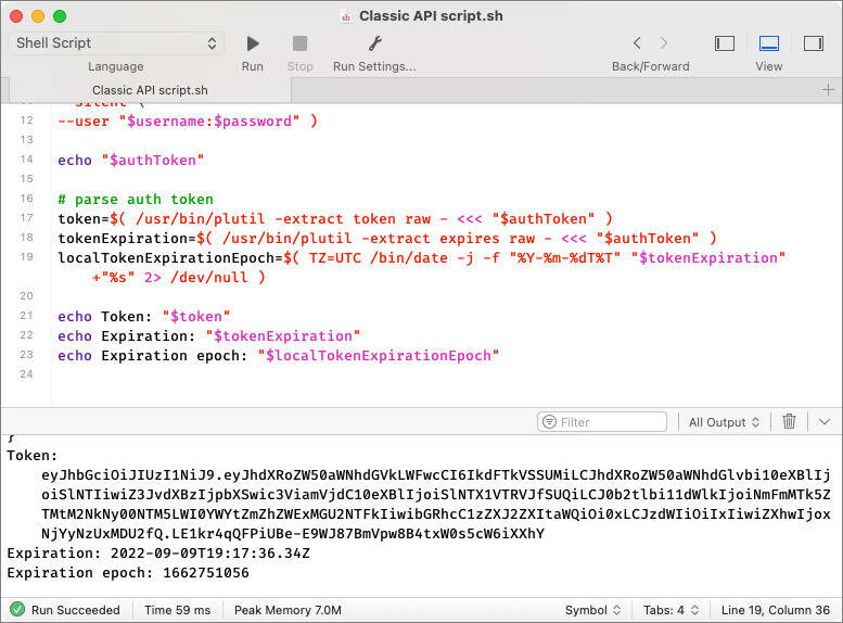

When we run this in CodeRunner with an echo at the end to print our results, it displays the token information returned from the server.
Parse the token
Notice the token information we received contains two pieces of information—“token” and “expires”. Only the token is important if we know the script will run very quickly (less than 30 minutes). Doing something like updating device asset tags from a spreadsheet could take longer than 30 minutes, so we’ll want to make sure we renew the token before it expires. We’ll talk about renewing the token a little later.
For now, we need to separate what we’ve received into useable pieces of information. Let’s put the token information into a “token” variable. Let’s put the “expires” information into a “tokenExpiration” variable. And let’s put a converted form of the expiration information into a “localTokenExpirationEpoch” variable. Paste this next:
# parse auth token token=$( /usr/bin/plutil \\ -extract token raw - <<< "$authToken" ) tokenExpiration=$( /usr/bin/plutil \\ -extract expires raw - <<< "$authToken" ) localTokenExpirationEpoch=$( TZ=GMT /bin/date -j \\ -f "%Y-%m-%dT%T" "$tokenExpiration" \\ +"%s" 2> /dev/null ) echo Token: "$token" echo Expiration: "$tokenExpiration" echo Expiration epoch: "$localTokenExpirationEpoch"
The last three lines echo the results of what we parsed.
First, we get “Token” by itself.
Second, we get the “Expiration” by itself (2022-09-09T19:17:36.34Z). This is an expiration date for when the token will no longer be valid and it’s always 30 minutes into the future.
Finally, we convert the “Expiration” information into something called an epoch date. A Unix epoch date is literally the number of seconds since January 1, 1970. The “Expiration epoch” date is “1662751056”. When we have a straightforward number like this, we can do math calculations very easily.
Note the “TZ=UTC” item in front of the date command for the localTokenExpirationEpoch variable. This is a time zone environment variable and it’s defining the date as Universal Coordinated Time (+0000). It’s the same as the GMT+0 prime meridian that defines the starting point for time zones in the world.
The server is responding with an expiration date in the UTC time zone, not our local time zone. But the expiration date doesn’t say that. By providing the environment variable, we’re telling the date command the originating time zone and it’ll automatically convert to our local time zone when giving us the epoch date.
We can confirm this in Terminal by running /bin/date -r 1662751056. It converts the epoch date back to a date we can read: Fri Sep  9 14:17:36 CDT 2022. This shows a corrected time that is five hours different from the UTC time the server sent. Without this correction, our calculations could be up to 12 hours off. And it works regardless of whether Daylight Saving Time is in effect.

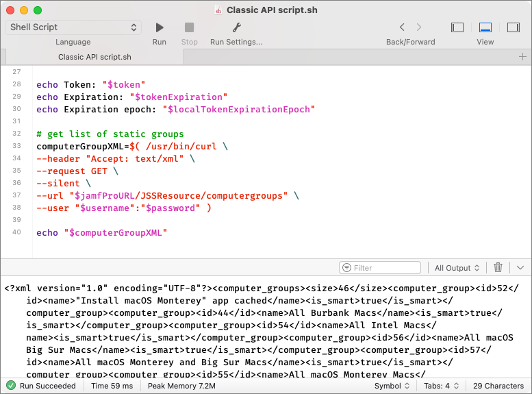

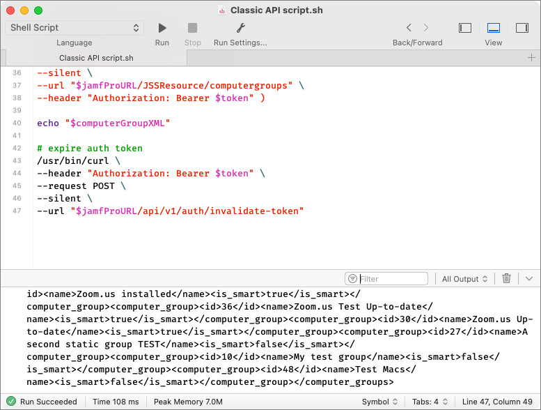

Use the token to send an API command
With basic authentication, the username and password are sent each time to the server when we use the curl command to request or change information. Here’s an example of what might come next in an unconverted Classic API script where we want to get a list of computer groups. Go ahead and paste this next:
# get list of static groups computerGroupXML=$( /usr/bin/curl \\ --header "Accept: text/xml" \\ --request GET \\ --silent \\ --url "$jamfProURL/JSSResource/computergroups" \\ --user "$username":"$password" ) echo "$computerGroupXML"
If we run the entire script so far, we should get a string of XML that denotes several computer groups.

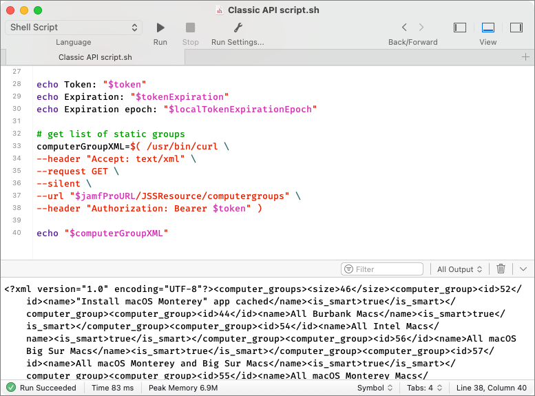

Now, let’s convert the command to use the bearer token instead of basic authentication. It’s simple to do. We’ll replace:
with
     --header "Authorization: Bearer $token"
and run the script again to test. We should get the same thing.
That’s it! That’s the basic change we need to make. We’re keeping our username, password, and server information that we had originally. But we used it instead to ask for a token and then simply replaced our credentials with the token when sending the API command. All we need to do is update all our other scripts to do the same thing.

Expire the token
Remember, the token is valid for 30 minutes. If all we’re going to do is make a one-time Classic API call that takes just a few seconds to run and finish, we don’t need the token anymore. A good practice is to expire the token at the end of the script. Paste this near the end of your script where no further API calls will be made:
# expire auth token /usr/bin/curl \\ --header "Authorization: Bearer $token" \\ --request POST \\ --silent \\ --url "$jamfProURL/api/v1/auth/invalidate-token"
We don’t see anything change when we run the script again. But we also don’t see any errors.

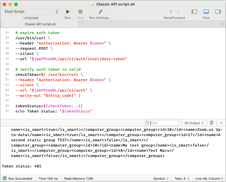

Did it work?
Normally, we can rely on this working, but just to test this one time (or if you’d like to always test), we can add a command to verify whether the token is still valid. Paste this after the command expiring the token:
# verify auth token is valid checkToken=$( /usr/bin/curl \\ --header "Authorization: Bearer $token" \\ --silent \\ --url "$jamfProURL/api/v1/auth" \\ --write-out "%{http_code}" ) tokenStatus=${checkToken: -3} echo Token status: "$tokenStatus"
This runs one more API command, which attempts to authenticate with the bearer token. At the end, it includes a --write-out argument. Every command we’ve sent to the server has returned an HTTP status code. Here’s a list of some that we might receive:
200 Request successful 201 Request to create or update object successful 400 Bad request 401 Authentication failed 403 Invalid permissions 404 Object/resource not found 409 Conflict 500 Internal server error
The --write-out argument instructs the curl command to show us the code returned from our API call. When we run the script with the additional code to check our token status, we see the result on the last line.
A 401 code lets us know “Authentication failed” or that our bearer token is expired and no longer works.

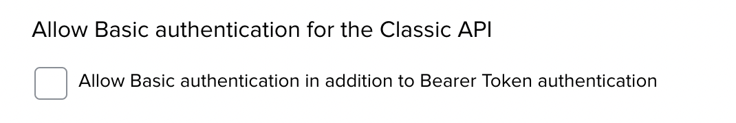

Once you’ve converted all your scripts to use bearer tokens for authentication, do one more thing to improve security. In Jamf Pro, go to the Settings cog > System Settings > Jamf Pro User Accounts & Groups > Password Policy. Disable the option to allow basic authentication for your Classic API scripts.
In the future, Jamf will remove this option altogether. For more information about this change, see the Classic API Authentication Changes page in the Jamf Developer Portal.

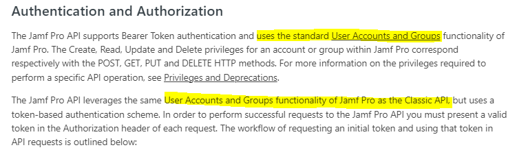

@talkingmoose As per the below, Jamf Pro API and Classic API will Authenticate local Jamf username and password. It won't support SSO. Thanks.

@talkingmoose Thanks for the reassemble script. However, I'm getting the static group list but token status still showing as 401.
As per privilege, I've read access to computer smart groups, computer static group and all access(create, read, update and delete) for API integrations and API roles. Apart from this any-other privilege required not to get token status as 401? Thanks.
talkingmoose
Forum|alt.badge.img+36
  • Community Manager
  • April 20, 2023
@sk25 The end of the script expires the token and validates it's no longer active. The 401 is confirming the token doesn't work, which is expected. You can delete the validation at the end to avoid that message or modify the script to present that information differently.
