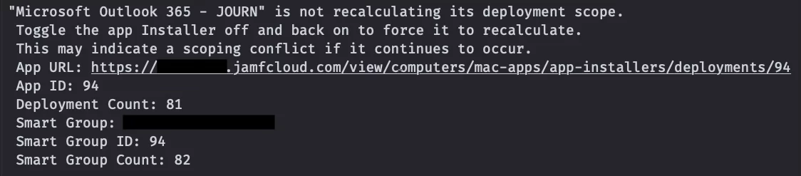

This led me to write a script which can be run periodically as an App Installer “health check”. It will scan all the App Installers currently configured on your Jamf Pro server, calculate how many Macs Jamf Pro thinks should be in each deployment, grab the number of Macs in the Smart Group that each App Installer is scoped to, then compare the two numbers. Any App Installers whose numbers do not match will be written in a report to your Desktop for review. That report looks something like this:
In this example, Jamf Pro thinks this copy of an Outlook installer is scoped to 81 Macs (Deployment Count) but there are 82 Macs in the Smart Group it is scoped to (Smart Group Count). Toggling this title off and back on will force the Deployment Count to update to 82.
There does not appear to be an API endpoint to toggle the deployment of offending App Installers, but at least this gives us a list of titles which need a kickstart as well as insight into possible overlapping scopes.

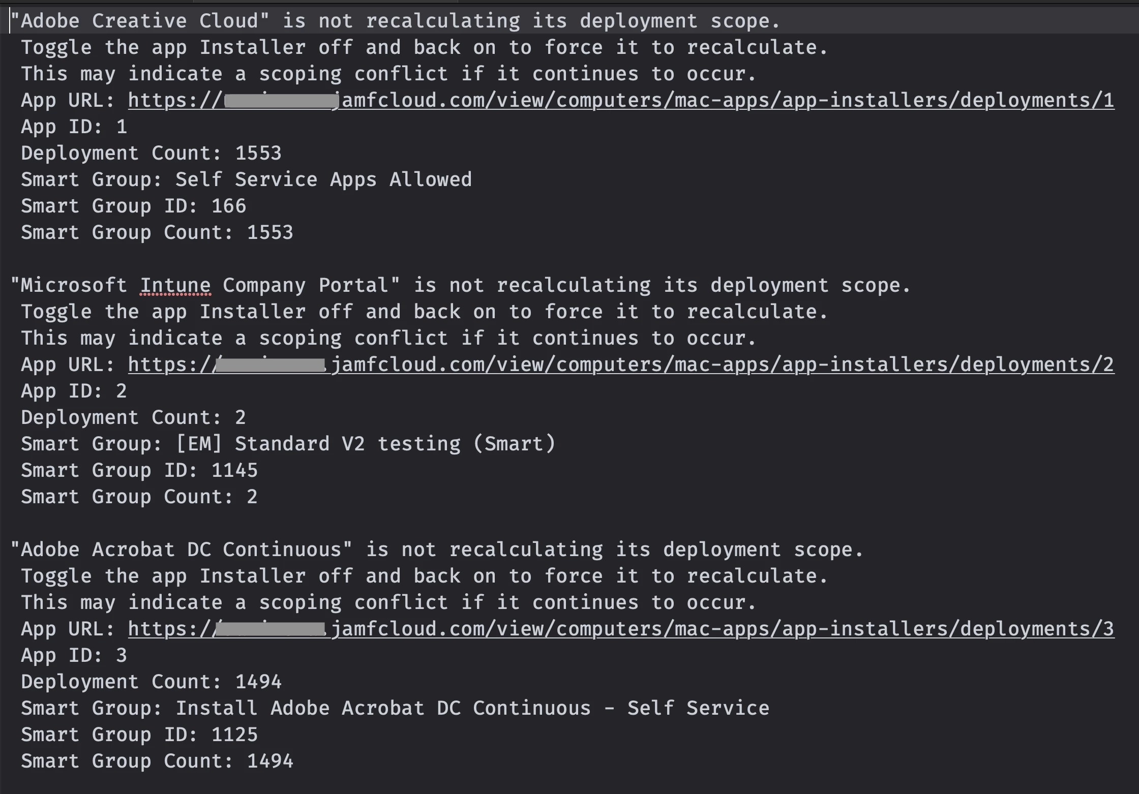

I just ran it changing the compare to == so I’d get a report of all apps as if everything was broken, and it comes out like this.
