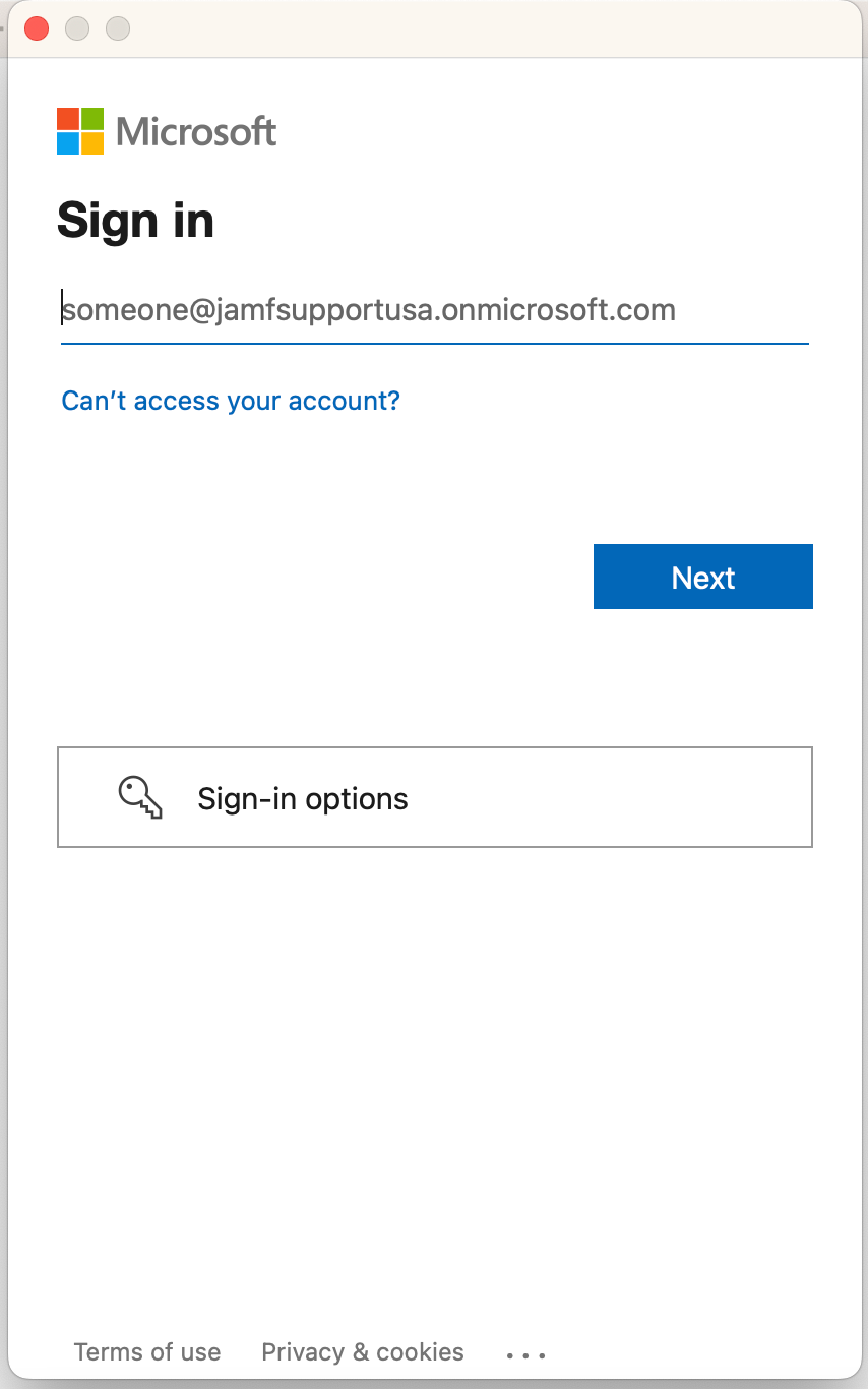

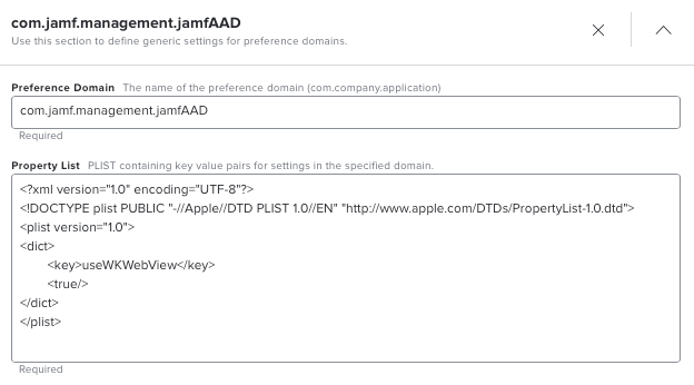

UseWKWebView
JamfAAD must prompt the user to sign in with their Azure AD credentials in order to obtain a user session token. To do this, JamfAAD leverages MSAL, and defaults to MSAL’s ASWebAuthenticationSessionRequest. ASWebAuthenticationSessionRequest calls on the user’s default browser (if that browser supports ASWebAuth) to handle a sign in to login.microsoft.com
However, due to the variability introduced by supporting multiple browsers (ASWebAuth is supported by Chrome, Edge, and Safari), the default browser can often be a point of failure for conditional access registrations.
In Jamf Pro 10.38 and higher, an optional configuration was added to use MSAL’s WKWebView instead. This leverages macOS’s built in WebView to present the Azure AD login. This setting is recommended to all environments that are compatible with WKWebView (note some forms of MFA, like hardware tokens, are not supported by WKWebView at time of writing).
To use UseWKWebView, push this PLIST out to the com.jamf.management.jamfAAD preference domain.

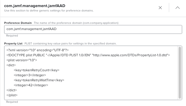

Retry Logic
The JamfAAD agent attempts to refresh the user’s session token when the LaunchAgent loads, and additionally once every two hours. This refresh is performed using an MSAL silent authentication flow. If this silent authentication fails to obtain a user session token for any reason, JamfAAD will fall back to an interactive MSAL flow, resulting in the user being prompted to sign in with their Azure AD credentials again.
In many scenarios, this is JamfAAD helpfully doing its job. For example, if the user’s Azure AD credentials have been changed, JamfAAD will need to prompt the user for their new Azure AD credentials. JamfAAD might also prompt for the user to sign in if a conditional access policy requires interactive sign-ins (this may be a pain point for end users, and conditional access policies should be configured to not force re-authentication if possible).
However, JamfAAD may also fail to retrieve a user’s session token in a scenario where the LaunchAgent loads but a stable network connection has not yet been established. This momentary lack of connectivity may result in JamfAAD falling back to the interactive flow, prompting the user to sign in again. This may manifest as the user having a JamfAAD prompt waiting for them every morning.
In Jamf Pro 10.27 and higher, JamfAAD can be configured to wait and retry a silent authentication a configurable number of times before falling back to an interactive flow. Configuring this retry logic to try again just a couple of times over a few minutes is enough to ensure users are not prompted due to network related timing issues. This setting is recommended for all environments. The retry wait and count settings can be adjusted if desired, but these default settings should cover the most common scenarios.
To configure retry wait and count, push this PLIST to the com.jamf.management.jamfAAD preference domain.

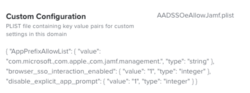

Azure AD SSO Extensions
In macOS 10.15, Apple rolled out their first iteration of SSO extensions. Microsoft has published their SSO extension, which uses Self Service on macOS, and Microsoft Authenticator on iOS. The SSO extension can handle authentication for any app that uses MSAL, or that supports redirect SSO extensions. Since JamfAAD uses MSAL, this means that the SSO extension can handle the JamfAAD sign-in prompts automatically. This reduces the registration flow to a single authentication in Company Portal.
Note: The SSO extension does not bypass MFA, if the JamfAAD sign in falls into a Conditional Access policy requiring MFA, the user will be prompted to sign in and complete MFA
Microsoft has published documentation on how to configure the Azure AD SSO extension in Jamf Pro here: Microsoft Enterprise SSO plug-in in Jamf Pro
In order to grant JamfAAD access to the SSO extension, com.jamf.management. must be added to the AppPrefixAllowList (step 5 in the Microsoft document). Here's an example plist.

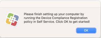

Prompting Users to Register
To initiate the registration, the user must run the registration policy from Self Service. A policy that leverages osascript, JamfHelper, or other user notification tools can guide the user to execute the policy and provide some explanation of what is happening and why.
Here's a link to a script that leverages osascript to prompt the user to register from Self Service.

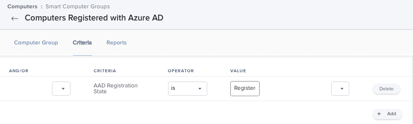

Good Article explaining Azure AD.  One question I have is, where did "AAD Registation State"  as a criteria in Smart Groups come from.  I don't seem to have that listed in my Jamf Pro.
BL-ay
  • Nov 16, 2022 9:31 AM UTC
@bmargrave You have to create a computer extension attribute:
  1. Go to Settings > Computer Management > Extension attributes > "+ New"
  2. Name it and set the Script as the Input Type and insert the script.
  3. Now save it and check the id in the URL:
    example: "...computerExtensionAttributes.html?id=3&o=u"

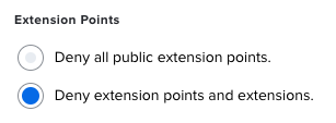

  4. Afterwards create a new configuration profile or choose an existing > Extensions > "+ Add"
  5. For "Allowed extension" set $EXTENSIONATTRIBUTE_X - in my example it is $EXTENSIONATTRIBUTE_3 .
  6. Don't forget to set the Extension Points to "Deny extension points and extensions" and select or add the ones you want to deny. Otherwise OneDrive doesn't sync and also other services could be affected.
After you created the extension attribute, you can use it as criteria for smart groups.

  • Oct 10, 2023 5:32 PM UTC
Ok, now that I am finally using the "useWKWebView" profile / key, that solves the Safari web browser issue (and going down a rabbit hole of changing the default web browser....yikes), or even having to deal with a spawning web browser situation. With this profile/key, you are presented with a a single / clean sign in page and you sign in, and I see "Registered" now (after a recon)...

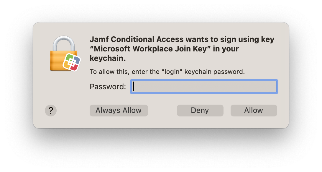

But I now see this "JCA wants to sign using key "Microsoft Workplace Join Key....."  I am just testing this on ADE / DEP Notify enroll to dial in the AAD registration, so I am already AAD/Intune registered. Maybe this is why, not sure.
So is there any way to not see this JCA popup, and, any way to keep testing this without necessarily deleting the registration in Intune, etc. thanks in advance...
