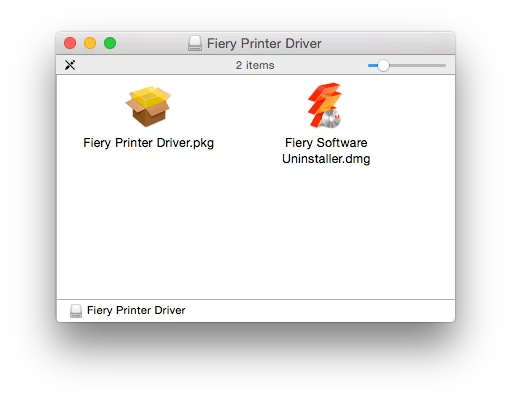

bpavlov
I'm reaching out to the community here because EFI has been completely unhelpful here. Although we are dealing with Canon printers, the issue isn't Canon in this case. Our Canon rep has been more than helpful in trying to get answers from EFI, but ultimately EFI isn't offering much up in terms of a solution which to me is absolutely insane considering their customers are in the enterprise.
The new Fiery drivers for OS X 10.11 El Capitan state that older Fiery drivers need to be uninstalled before installing the new drivers otherwise there will be some problems which are documented in their release notes. The uninstaller is of course a part of the driver download, but it's all GUI. Release notes: http://help.efi.com/fierydrivermac/Mac_OSX_10-11_Printer_Driver_Release_Notes.pdf
Has anyone figured out a way to use their uninstaller to uninstall Fiery drivers through the command line silently? Obviously manually uninstalling software does not scale. I've thought of doing a before and after snapshot to see what is installed by drivers, but that certainly won't include any logic built into their uninstaller.
I've also made a thread about it here: http://fieryforums.efi.com/showthread.php/5583-Is-there-a-command-line-option-to-uninstall-Fiery-drivers-for-OS-X
P.S. I just need to add that I really really hate EFI. What a horrible company to deal with. Absolutely atrocious support.

Whoa!!!! And I just checked on my thread on the EFI forums and they posted helpful information!!!
Here's the link:
http://fieryforums.efi.com/attachment.php?attachmentid=1342&d=1447370372
and the text for historical archiving:
Fiery Software Uninstaller [Commandline]
During silent uninstallation, FSU will not ask for any confirmation from user like closing
running applications, asking for retaining preferences etc.
In case if any application is running, it will close it and proceed for uninstallation without
any confirmation from the user.

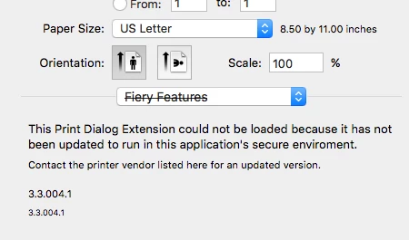

I'll throw out that the "need to uninstall the previous driver" has been a statement in EFI's previous Fiery installer Read Me's, so that's nothing new to 10.11.
That said, anyone who is distributing Fiery drivers should probably be using smart groups to verify the Fiery Features (FF) Printer Dialog Extension (PDE) version if they're upgrading across major OS X versions (e.g. 10.9 -> 10.10) in place. This is since EFI can't be bothered to make a single FF PDE that works across all versions of OS X. For example, the "FD47" revision (version taken from the name of the dmg downloaded from EFI's site) Fiery driver for the Ricoh C3503 with E-22C 1.0 Fiery supports 10.6-10.10. When installed, the PDE that placed (EF246444 (FF).plugin) on the computer could be (as sourced from the pkg):
  • 10.0 - 10.6: PluginX64, CFBundleShortVersionString 3.6.011.0
  • 10.7 - 10.9: PluginX64_sandbx_dynppd, CFBundleShortVersionString 3.61.009.0
  • 10.10+: PluginX64_yosemite, CFBundleShortVersionString 3.72.010.0
But note the PDE is still named "EF246444 (FF).plugin".
If you upgrade OS X across one of the boundaries defined above, you may need to (and probably should) reinstall the driver (yes, the exact same pkg you installed before the OS upgrade) lest you run into an issue like this:
(thanks to @swy for the screenshot).
EFI's pkgs run a close second to Creative Cloud Packager packages for madness level. Don't forget to check out whether your EFI Fiery pkg includes the unpopular "Fiery Printer Driver Installer.app" (my Ricoh drivers blessedly don't include it for some reason). Your EFI Fiery pkg might not work out of the box or may pop up interesting dialogs, prompts, and applications.

@foigus Just a minor update: I took a look at the Fiery Features (FF) Printer Dialog Extension (PDE) version. But in our case there are only two versions and they both have the same version. So even that isn't consistent across all Fiery drivers. May not effect you, but figured I'd mention it in case someone else tries to follow that technique. FWIW Our Fiery is an F200 for the Canon C700.
@benshawuk So in speaking to the developers, the reason they added that GUI was because admins were asking for it. As you may imagine, not everyone has the same skill set and not every environment is the same. So in situations where the end user has to install on their own, that GUI comes in handy. Or in places where techs are manually installing things. This is what it was like for me in Higher Ed so I can empathize with the request. Unfortunately, it complicate things for admins who like to deploy things silently and in the background. Fortunately, it's possible to break apart their installer. Hopefully the feedback I gave them will allow them to improve upon this process so they can appease the various environments they support.

  • April 1, 2019
Bumping this because current EFI drivers are still having issues with Mojave. Your users will experience slow printing. It works, but it can take 30-60seconds just to pull up print windows and get through the options, and hit print.
