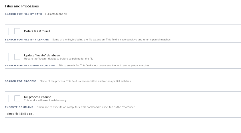

Another thing to keep in mind when you add something to the dock is you should reset the dock at the same time. sleep 5 : killall dock under files and processes.

@larry_barrett even though the dock item looks to get added before 'files and processes' would run, you think it would make a difference?

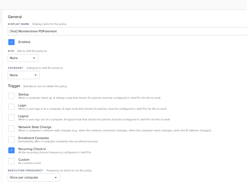

I downloaded, installed and tested this. I'm OnPrem on Catalina 10.15.6
I'm just going to share screenshots for brevity sake.

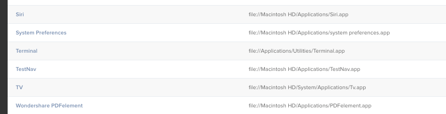

First, setup in Settings -> Computer Management -> Dock items (note, I could not make it work without the full path including the harddrive name, your harddrive name may be different).

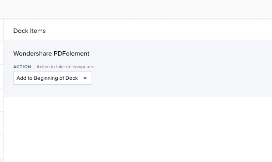

Next, make a policy. You should have General (to set frequency), Dock Items (to add the dock item itself) and Files and processes (to sleep and kill the dock)
General tab:
Dock Items tab:
And finally the Files and Processes tab:

@larry_barrett I added the execute command to the policy and will test it out. I usually have the drive named Macintosh SSD, some might still be Macintosh HD. I'll test again without adding the drive to the dock item path, but with the execute command in place with sleep 5; killall Dock
isn't it supposed to be a capital D for Dock?

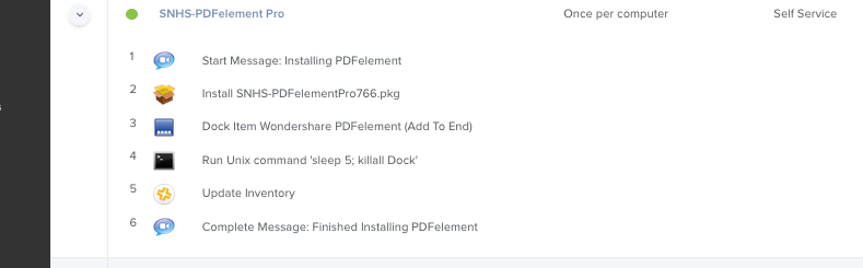

This is a Self Service policy that i have configured for the installation of PDFelement

if you're in terminal I think it has to be Dock, but the Jamf command doesn't care.

@larry_barrett the policy works great installing the application, it's just the stupid applications dock item icon.
i tested from terminal with Dock and it worked, while dock (lowercase) said no matching processes. If it doesn't matter with jamf i'll just leave it D

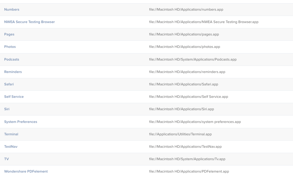

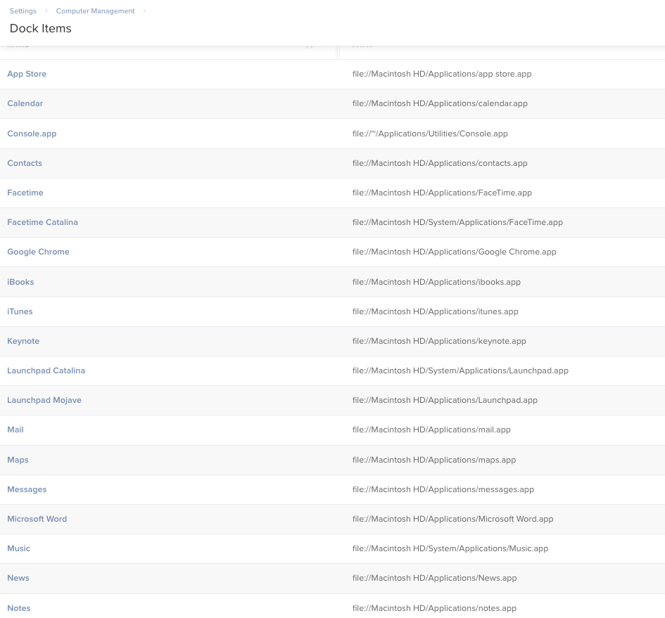

@larry_barrett do you think that instead of using the drives name, you can use what i put below? I'm testing it out. I see some dock items here that have file://localhost/*
file://localhost/Applications/PDFelement.app
  • 341 replies
  • September 28, 2020
Here's a full list of my dock items:
Wish I could be of more help.
