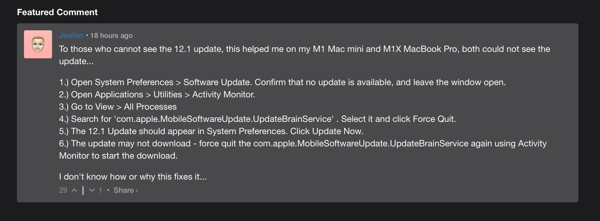

Are the 11.6.3 updates listed in Software Update? Maybe try the steps in the screenshot...
AVmcclint
Forum|alt.badge.img+21
  • February 1, 2022
It never lists any updates, but the red notification dot certainly knows there's something there. I would think that restarting the Mac would effectively kill the process mentioned in the screenshot, but I can give it a shot.  On a hunch, I ran a policy on an affected Mac that purges the system caches via Self Service. After the Mac rebooted I immediately tried softwareupdate -l in Terminal and it worked. I then ran softwareupdate -i -a -R and it appears to be processing it now. I would expect this kind of fix to be a one-off, but for there to be so many Macs affected by this, this seems to be a bigger problem.

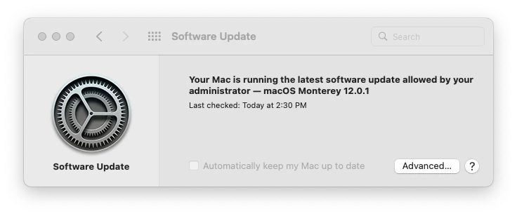

  • February 1, 2022
I wonder if this falls under the same issue
Fluffy
  • February 1, 2022
That looks like you have a deferral set for Software Updates. I'm guessing it's set to 90 days.
  • February 1, 2022
Yup, that was it.  It was set by accident and was for 7 days delay.
Thx

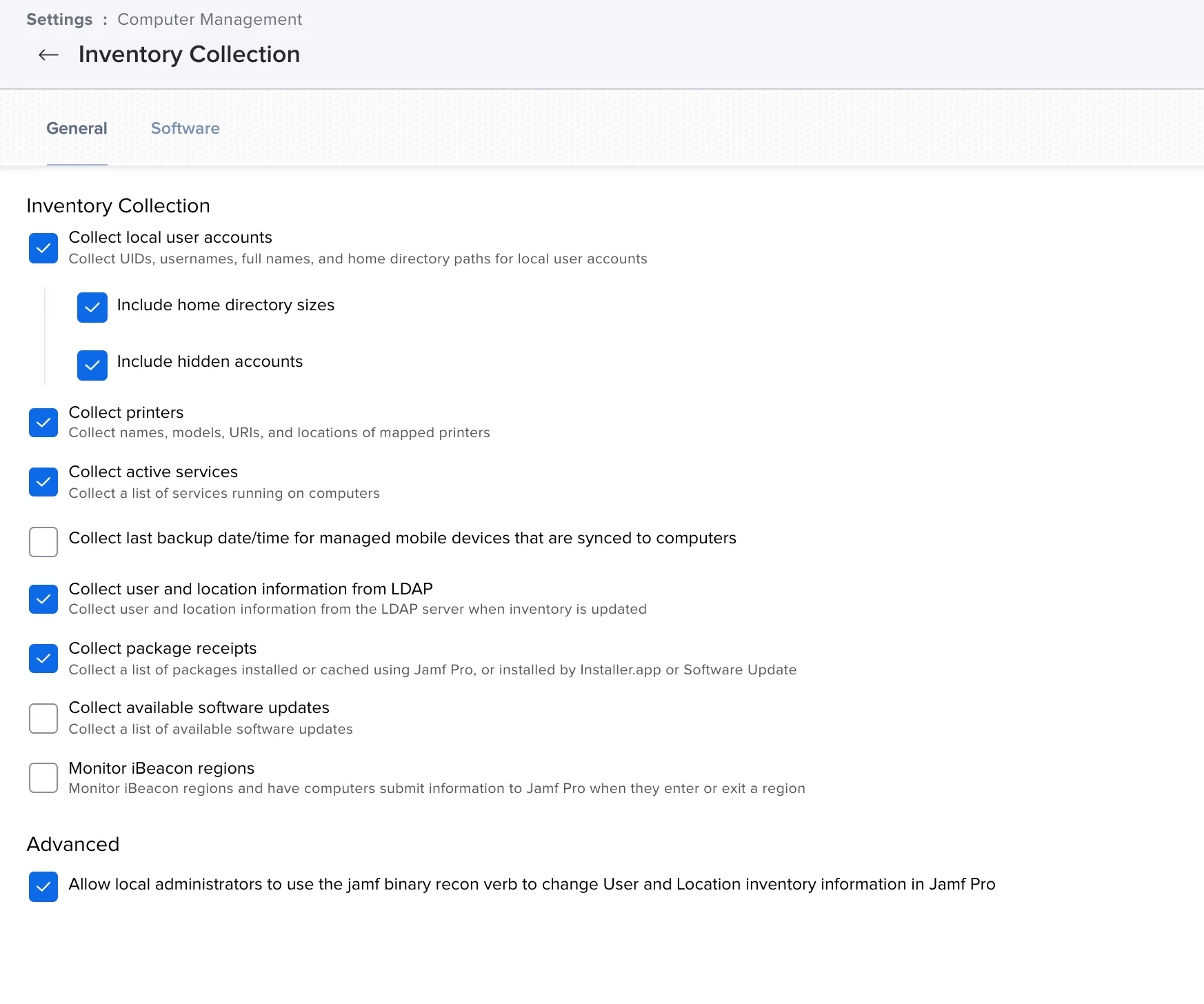

I realize this is only partially related to OP but given the bugs in softwareupdate lately I thought I should share here too.
We had computers not checking in because recon was failing to complete. It was ultimately due to softwareupdate hanging. JamF is tracking the PI.
PI-101392
They advised us to disable "collect available software updates" which is what calls that at recon until PI is resolved.

  • February 18, 2022
If you re-enable Collect Available software updates and run sudo launchctl kickstart -k system/com.apple.softwareupdated in a script daily, will recon still be affected?

  • April 29, 2022
@syoung17 I re-enabled Collect Available software updates yesterday and Im finding that running the kickstart command still doesn't quite fix the problem every time. The only way I can guarantee a Mac can complete a recon is by disabling that setting.  This has been happening for quite some time
