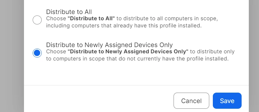

Hi All,
Currently, Jamf Pro does not distribute/push a few of our configuration profiles to the devices.
Is there a way where I can force these Config Profiles to the devices in Jamf Pro?
i selected all computers in scope, when I do re-save action it asks me if I want to distribute to all enrolled devices or newly enrolled devices but this is not an ideal solution. There must be a way to force them

The option is to push to all in scope or newly added to scope, nothing about enrollment
i have tried that, all computers are selected in scope, it is still not working though.. the config profiles are pending days and days..
In that screenshot, that isn't the option you selected correct? If it is, none of the profile changes will go to devices that already were scoped to this profile.
on this one i cloned the other config and scope to a specific device, it is still pending..Computer level and install automatically have been selected
